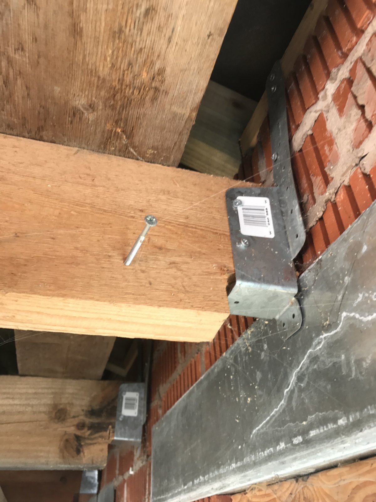

Which joist hanger type and exactly where does it go?
These are the nails for joist hangers:

If you need to use the joists as rafter ties you will need to fix some against the common rafters
If you have a gable end, you may need to use some straps across 2 joists and fix to the masonry.
https://www.screwfix.com/p/easyfix-square-twist-nails-sheradised-3-75-x-30mm-1kg-pack/12788

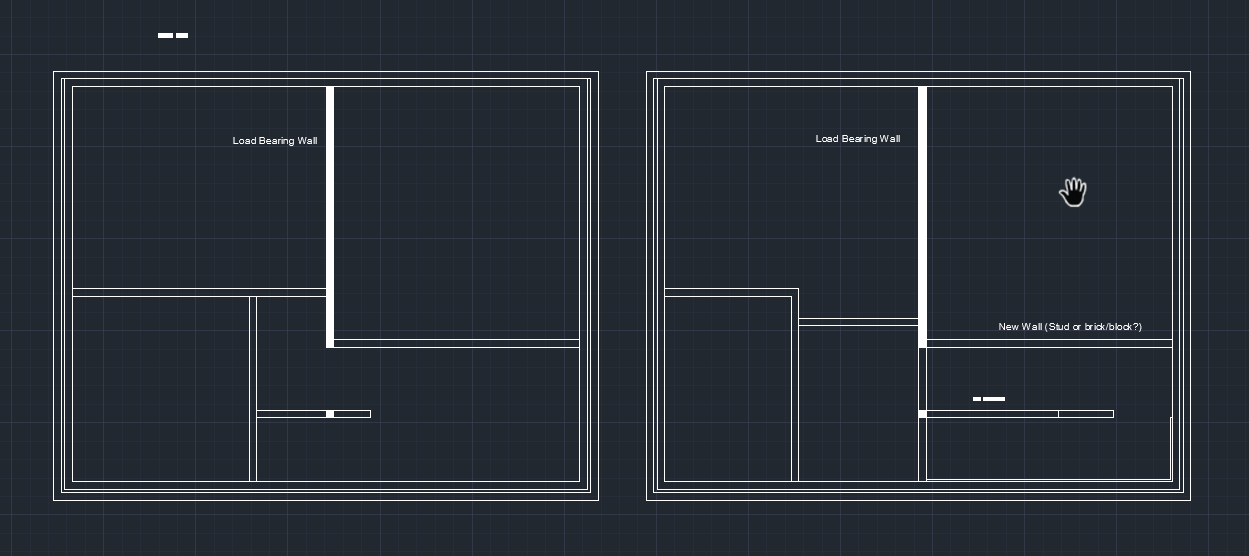

You didn't mention where the UB is being placed, but other than that, yes it looks good. But I'd still go with 8x2s.

Yeah, I haven't show you guys the full plans because I don't know if you have AutoCAD. The UB isn't going to be in the roof. There is a central load bearing wall in my house which supports the joists throughout the house, however, this wall doesn't go from gable to gable, and it would be a bit useful if it did. So where it stops, we're going to put a UB from there to the gable. Here's a pic: (Left is ground floor, right is first floor)
The rest of the house is done in 7x2s, so, I don't know. 7x2, 8x2, I guess I'll decide later on down the line when we decide we're going ahead. :)

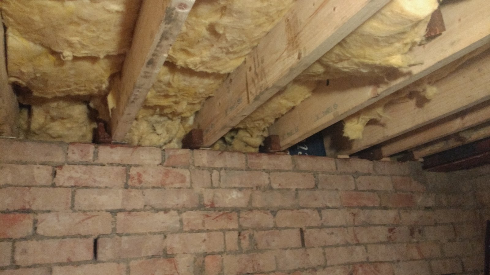

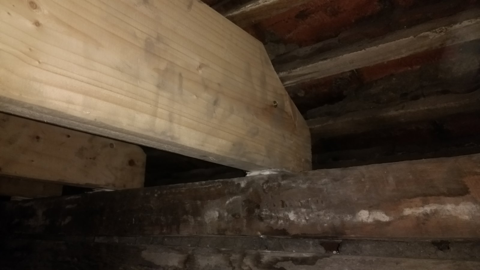

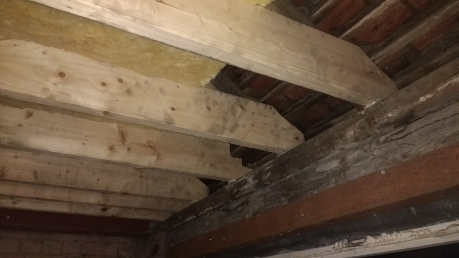

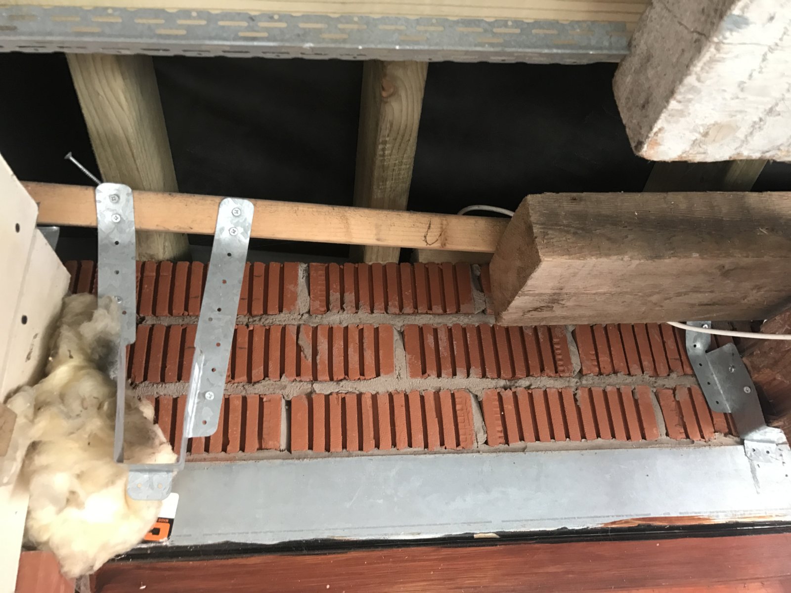

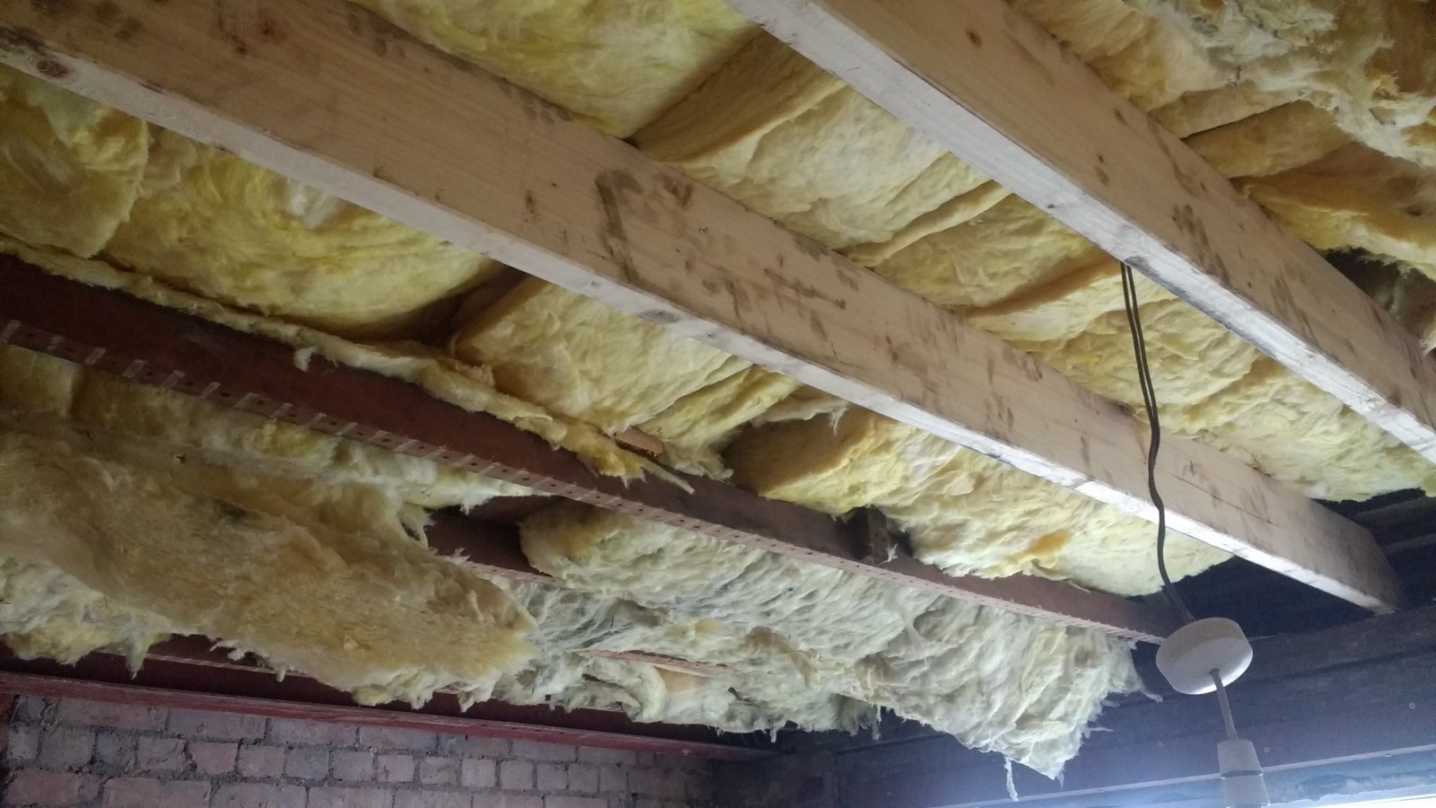

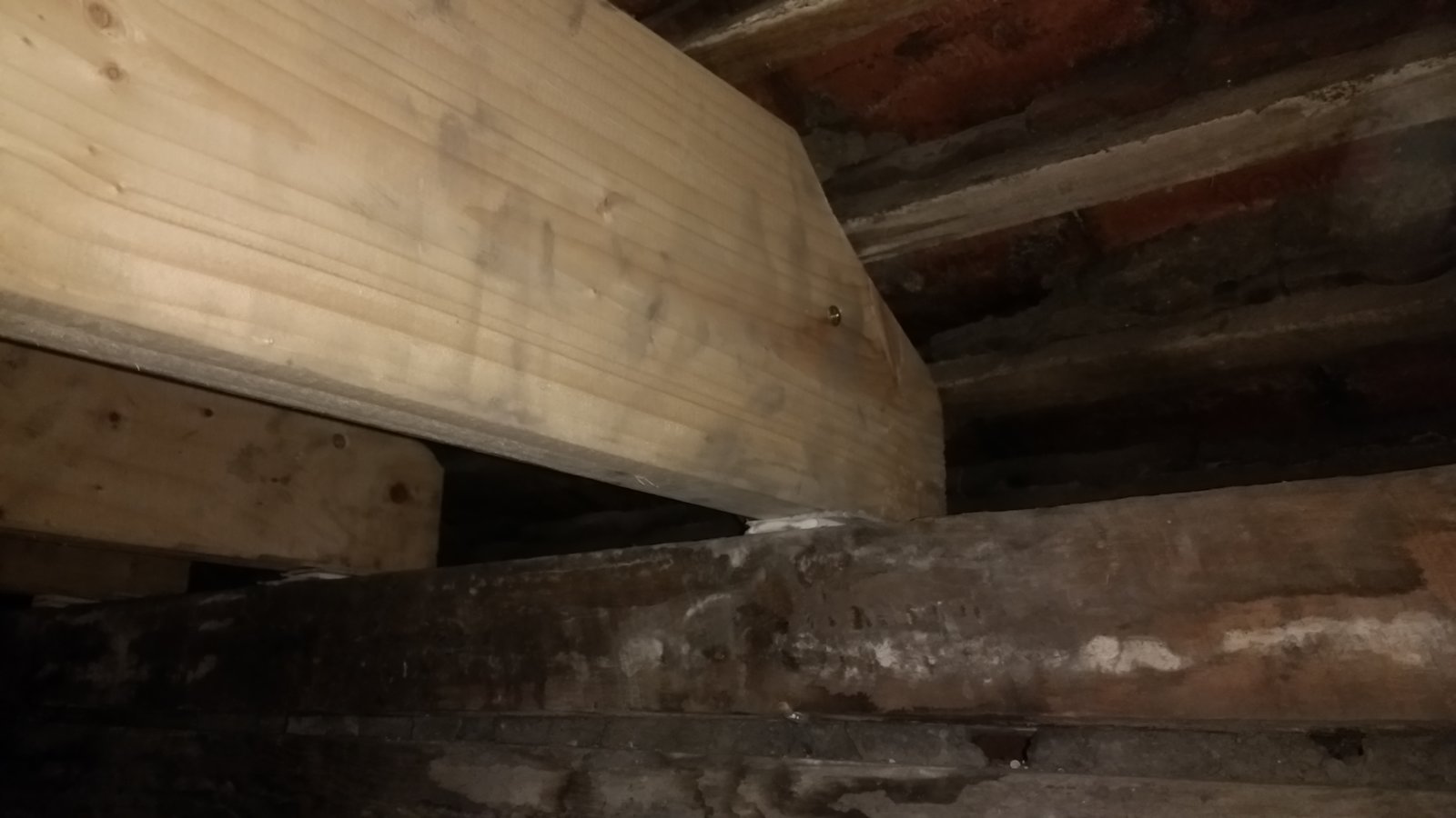

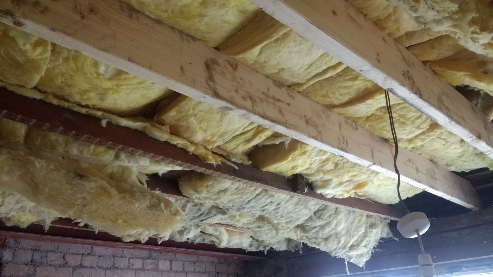

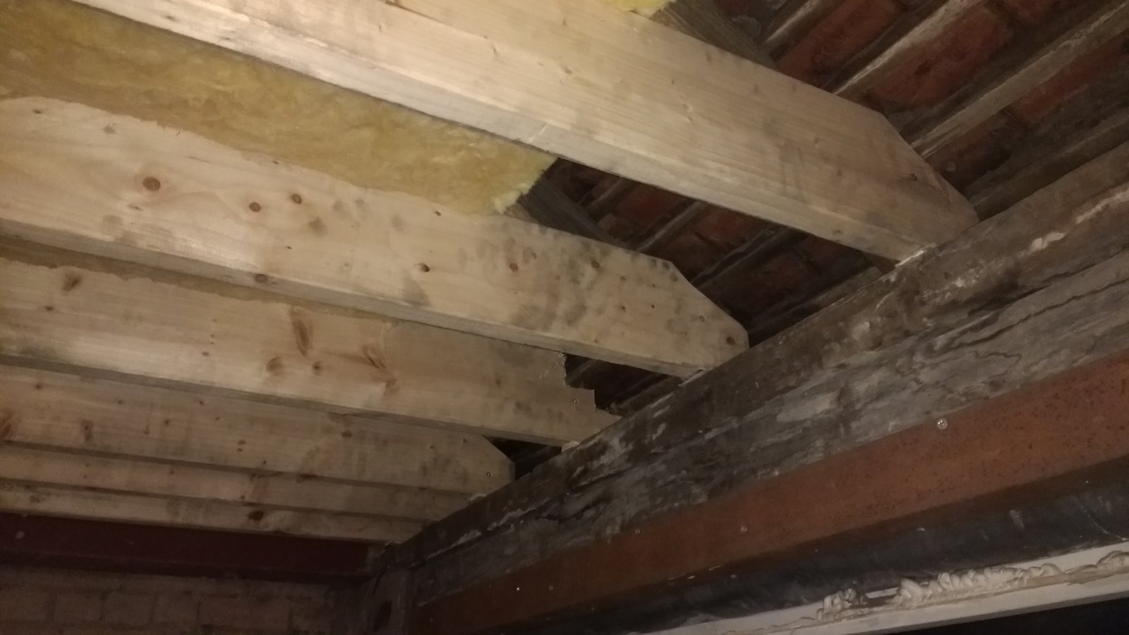

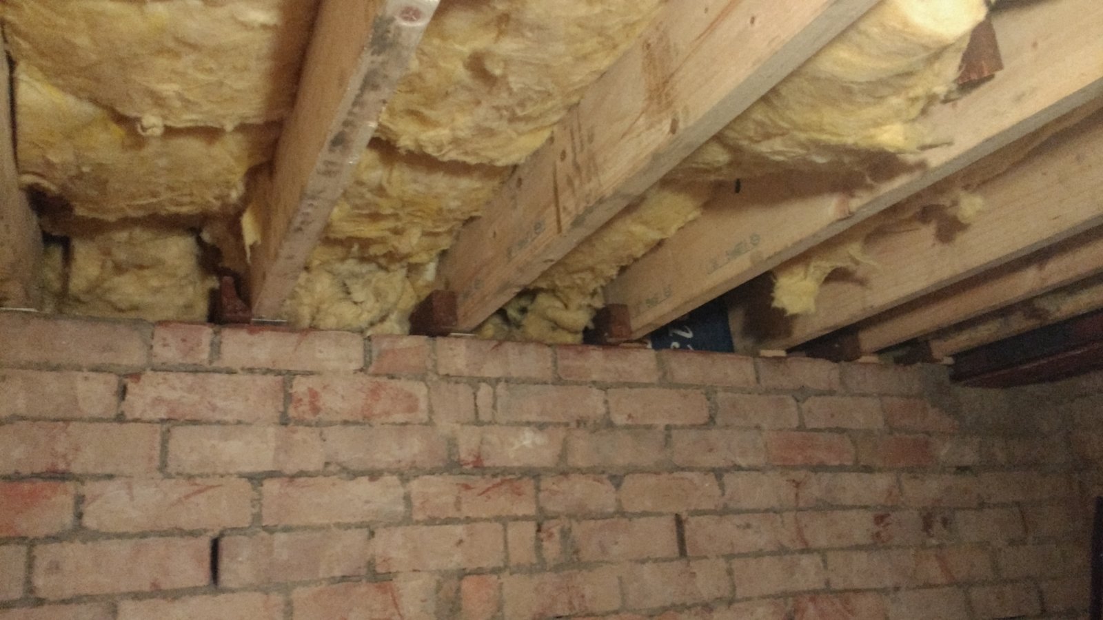

Hi, I'm doing something like this at the moment, not a loft conversion but a stronger loft floor for storage using 7x2 joists. I abandoned the original plan of joist hangers off the wall plate to sit the new joists a few inches lower into the room below (to gain extra loft headroom) because the existing joists sat directly on the inner spine wall and I would have had to start cutting out or slotting the bricks to sit the new ones in. I ended up sitting them on top. The sistering with the existing 3" joists went out of the window as they had 40mm of deflection in the centre so ceiling would have been interesting as would doing the noggins. I cut out the old joists and put the new ones in their place with the eaves end chamfered, I'm happy with this - even though it looks like your SE wouldn't be . I swapped them one at a time and replicated the fixing to the wall plate and rafters and joists on the other side of the house. The other other thing is that if you're sitting the joists on the outer walls above any windows you'll need to check the lintels.
View attachment 134823 View attachment 134824 View attachment 134825 View attachment 134826
Hey, thanks for the pics! :)
