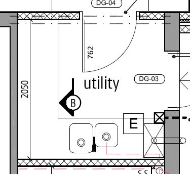

I'm thinking of getting the Joule Cyclone short 200l to go with my Intergas ECORF24 (as suggested by a few of you on here). I'm looking at the short version because i only have a little over 1.3m below the boiler and the short 200 should fit as it is 1150mm tall. What concerns me is the diameter (600mm). That will fit, but will stick out a lot below the boiler. The alternative is to get the 150l (at 530 diameter), but that's 25% less capacity!

Depends where the trappings are.
Some cylinders can be rotated so all connections/trappings are in the sides.
Sorry, what do you mean by trappings?
Accessing the immersion heater shouldn't be a problem assuming its at the front (as utility room is 2m wide). I just can't have it sticking out much more than 600mm in it's fixed position (because there is a door on one side). Another 100mm would just about be ok i guess, but i'd rather that were at the side if poss.
Get an oso super S all connections on the top.
100mm will just about do it.
But we're fighting blind with the amount of information you've provided.
Sorry, hopefully attached drawing will help. FYI, boiler has gone on the stud partition (as opposed to external) wall.

And the rest of the hot water outlets? Control strategy?
Not sure what you mean by "rest of the hot water outlets ". But i will have a manifold in the Utility for UFH downstairs and rads upstairs.
Re controls, i will be automating by means of relays. Same system (Fibaro) as for lighting.
