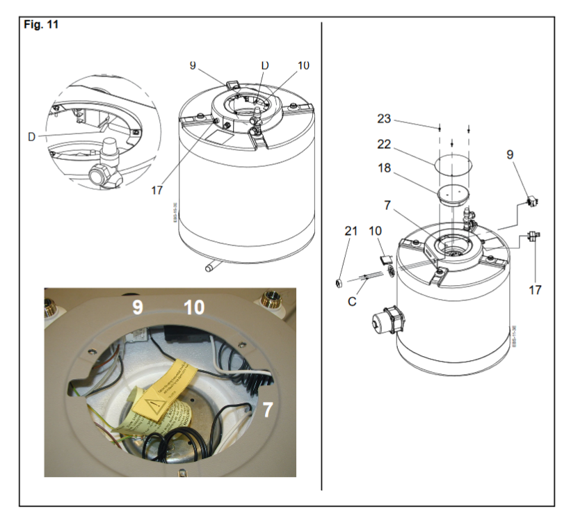

Didn't realise these are vented cylinders if hyou can look inside?
Sorry, maybe I have understand wrongly... they are unvented because they have expansion tanks?
When I mentioned look inside I mean unscrew the lid and look inside? Or is that not possible with these types of cylinders... haven't tried it!
Does it basically mean you should open the lid of the cylinder and look inside?

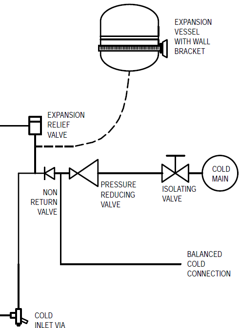

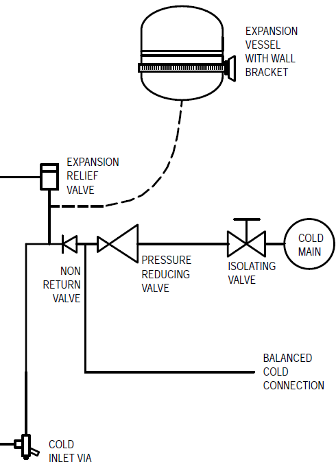

Does the PRV set up and E.vessel look something like the attached, can you see what setting the PRV is set to, it may be faulty??, if you have a car tyre pressure gauge then checking the E.vessel airend may give a idea of the cylinder pressure, it should vary a little if you can achieve a flow from the cylinder.

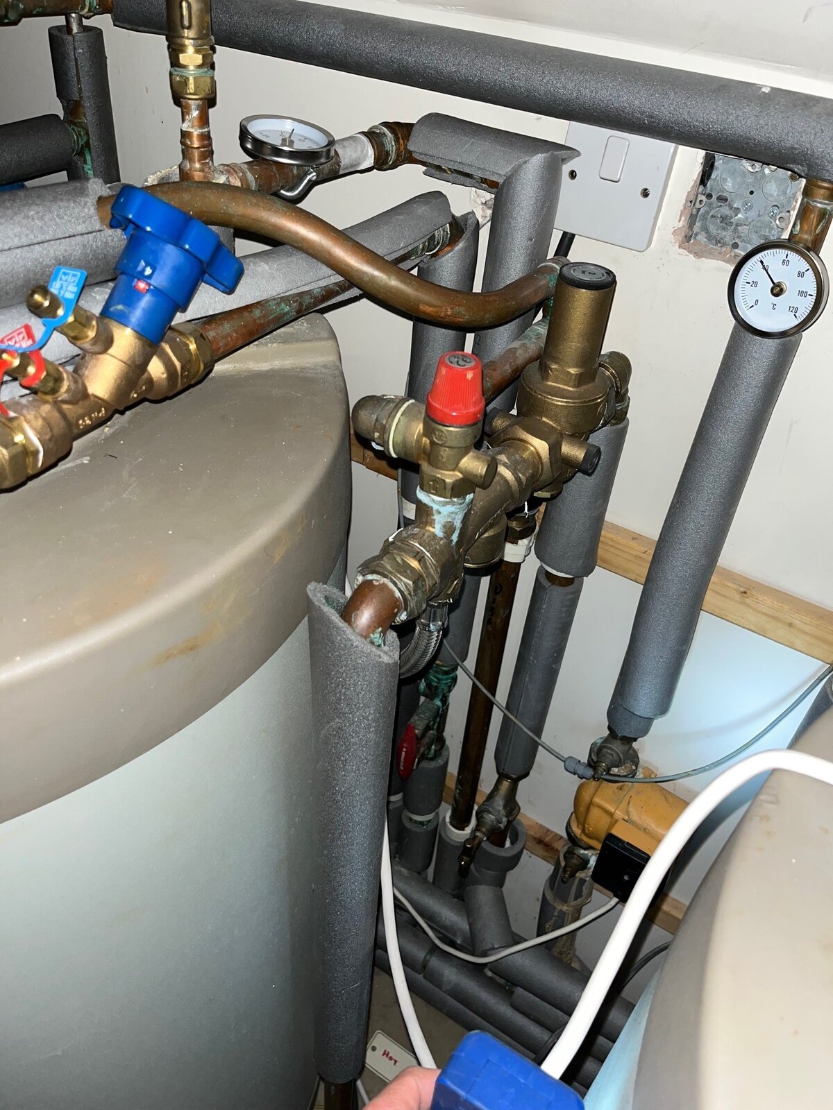

It would have to be one of the other valves, or maybe some other obstruction. There are numerous pressure gauges on the system, as per your other post. Do the readings throw any light on what's happening?
Post #7 suggests that both have PRVs but maybe this is a reference to pressure relief valves, one pressure reducing valve would be the only logical way to ensure equal inlet pressures.
Ok so as a novice help me out here please... so we have a pressure release valve and a pressure reducing valve.

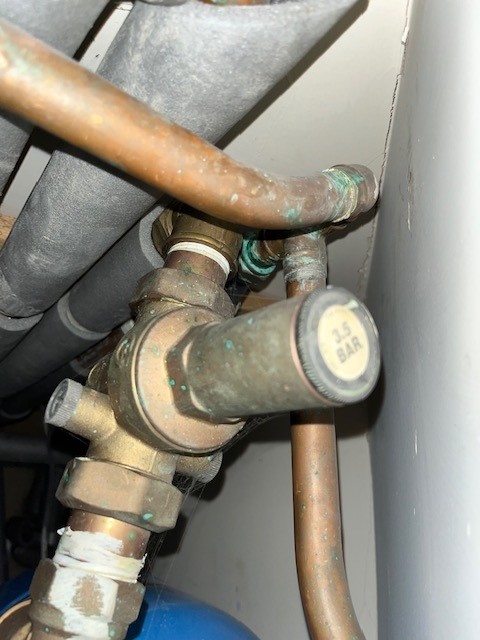

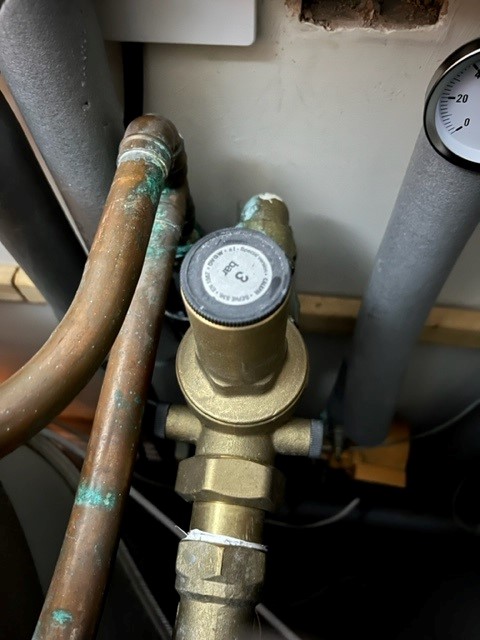

The pressure reducing valve in the diagram above is on the cold mains and is coming into the tank ... here I've noticed the sticker on one of the cold water PRVs says 3 bar and other says 3.5 bar (not sure how I would check the cold water pressure).
Then if I understand we have a pressure relief valve for the hot water in the tank. Each tank has one to release hot water from the tank itself (I have tested them by turning them to release water - both work).
By the way I have put these temperature sensors from Amazon (but I'm not sure they are very reactive) - are you perhaps confusing these with pressure gauges?

Are you saying, below, that one cylinder has a pressure reducing valve marked 3 bar and the other has another one marked 3.5bar?.
"The pressure reducing valve in the diagram above is on the cold mains and is coming into the tank ... here I've noticed the sticker on one of the cold water PRVs says 3 bar and other says 3.5 bar (not sure how I would check the cold water pressure)."

So I looked again and yes there is a cold water pressure reducing valve on the slow tank of 3 bar and on the fast tank of 3.5 bar. There is also a pressure relief valve which discharges hot water on each tank.
The interesting I just noticed is that from the cold water inlet tap upwards on the slow tank, the pipe feels warmish, all the way into the bottom of the tank. On the fast tank, the cold water inlet pipe feels cold to touch all the way into the tank itself. This means the water is not draining from the flow tank and is heating the cold water all the way back into inlet? The same inlet pipe serves both tanks, it goes first to the fast tank and then continues on to the slow tank.
