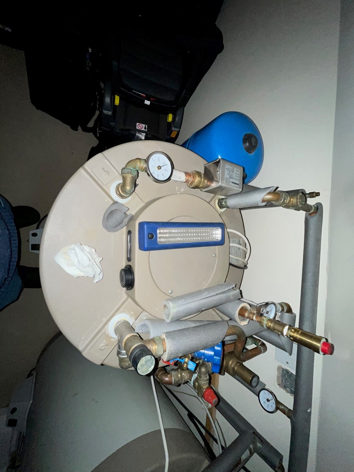

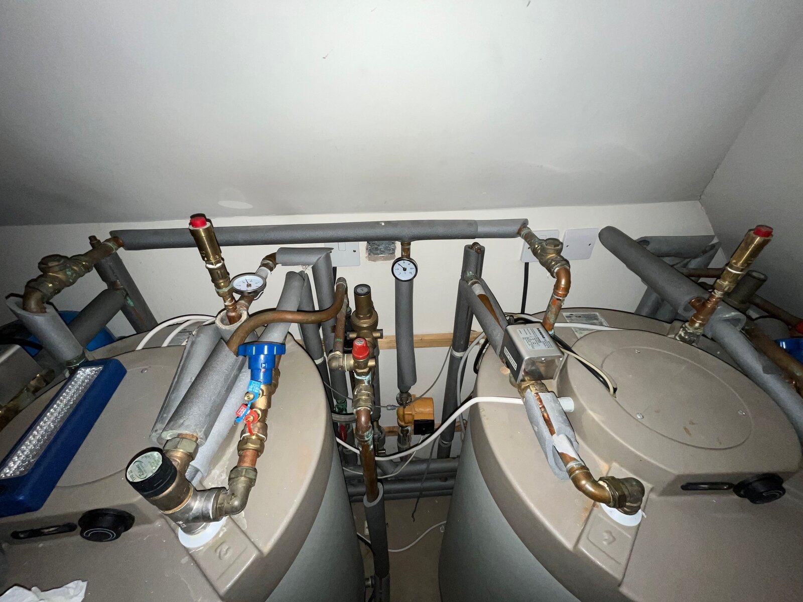

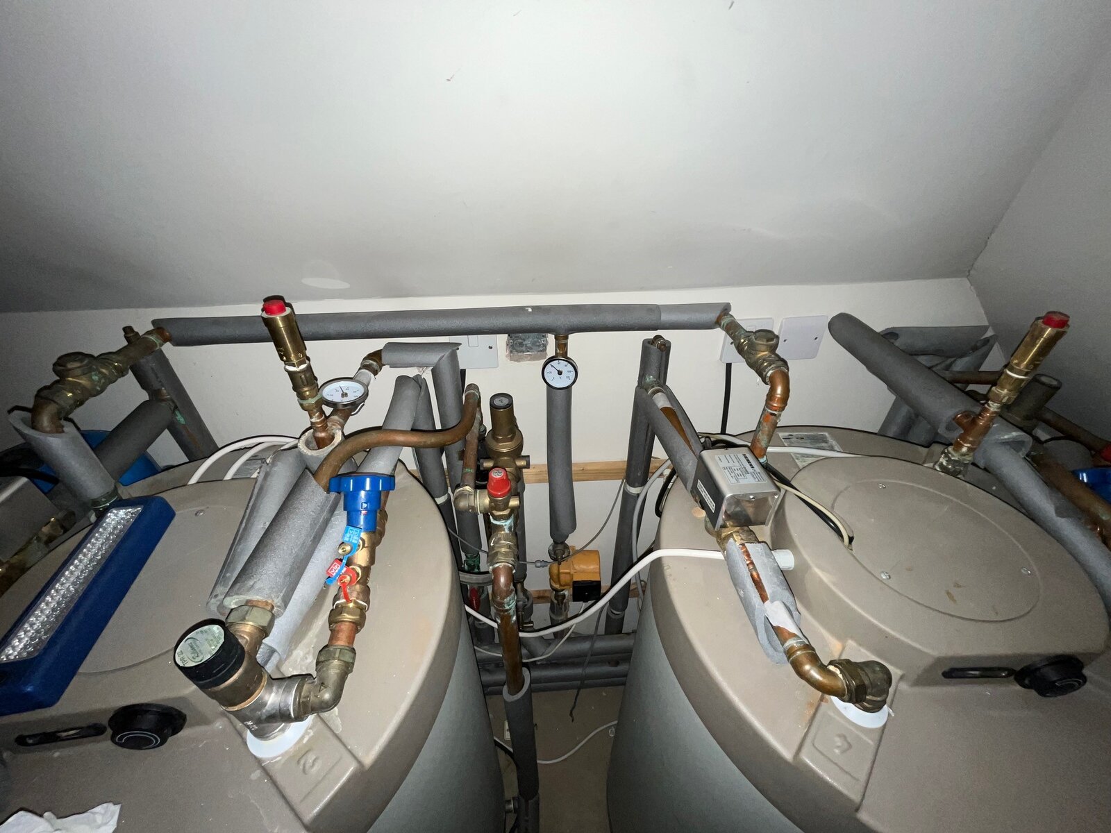

Thanks for your reply, yes it is odd to have two cylinders - I think it could have been because of where they fitted them in the loft eaves, even thought they could have moved them slightly and had a taller one.
I really cannot understand why the cylinders do not drain evenly as they both feed the same hot water pipe going out through the house. The pipework for one cylinder is perhaps about 0.5 metres further from that pipe that the cylinder which drains quicker, so not sure if this is the issue.
I am doing a series of tests to work out if I can either live with the one cylinder, or if I can force the slow draining cylinder to come back on. Thanks for your help!

The plumber some time ago installed balancing hot watert flow restrictors on the tanks, suggesting that this would help to balance them out. It did not work as if I close both restrictors fully, the hot water flow reduces to a trickle. If I open only the slow tank, it stays at a trickle. If I close the slow tank and open the fast tank, it flows normally. However as mentioned occasionally after a lot of people showering, if I check the tanks, even the slow one has fallen maybe 10-20 degrees (the fast one will have fallen 40 degrees).
You say
Sounds to me like there is a restriction somewhere in the slow tank circuit (apart from the added restrictor).
The principle of putting a restrictor in each path is sound. The idea is to estimate the difference in headloss of each stream, at a given flow, and make the restrictor loss a few times greater, depending how accurate you want the flow sharing. Starting from scratch on an industrial job you might be able to increase the total pressure drop to allow for the restriction, but clearly here you're stuck with the mains pressure. But I'd be surprised if you can't achieve something good enough to avoid taking the tanks out.
Has each cylinder got its own expansion vessel?. and have they got separate PRV sets?
What are these restrictors?, are they lever or gate valves?
If you shut the cold water supply to the fast cylinder and open up the restrictor to the slow cylinder does the flow increase from the slow one?.
Yes so I tried that - but when I shut both restrictors (gate valves) the hot flow slows to a trickle - when I open the slow cylinder, it stays at a trickle. When I open the fast cylinder, the hot water flows out like normal. I did not shut the cold inlets though as I figured the tank was already full so it would not make a difference right?
I've also noticed that the plumber fitted both diverter valves which are connected to the thermostats on each tank on the return to the boiler from the cylinder. Each cylinder has a diverter valve on its return, so one cylinder can be open. However this means that if its on the return to the boiler, the hot water is still circulating into the coil of both cylinders, even if just one cylinder is calling for heat?
Also any advice on what sort of pump should be installed to get from the boiler which is in the garage up to the loft which is 2.5 floors up so lets say 6-7 metres higher? The current pump is a Grundfos Alpha 15-50
Where are these restrictors installed, on the hot outlets or on the cold feeds and if on the cold feeds are they before the PRVs?, a little sketch wold help.
Doesn't that suggest there's an additional restriction elsewhere in the slow cylinder circuit?
Yes, I'm just confused how I would figure this out. Does it basically mean you should open the lid of the cylinder and look inside?

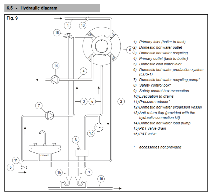

So I managed to find the manual for this range of cylinders. The gate valve has been put in number 2 which is the domestic hot water outlet.
