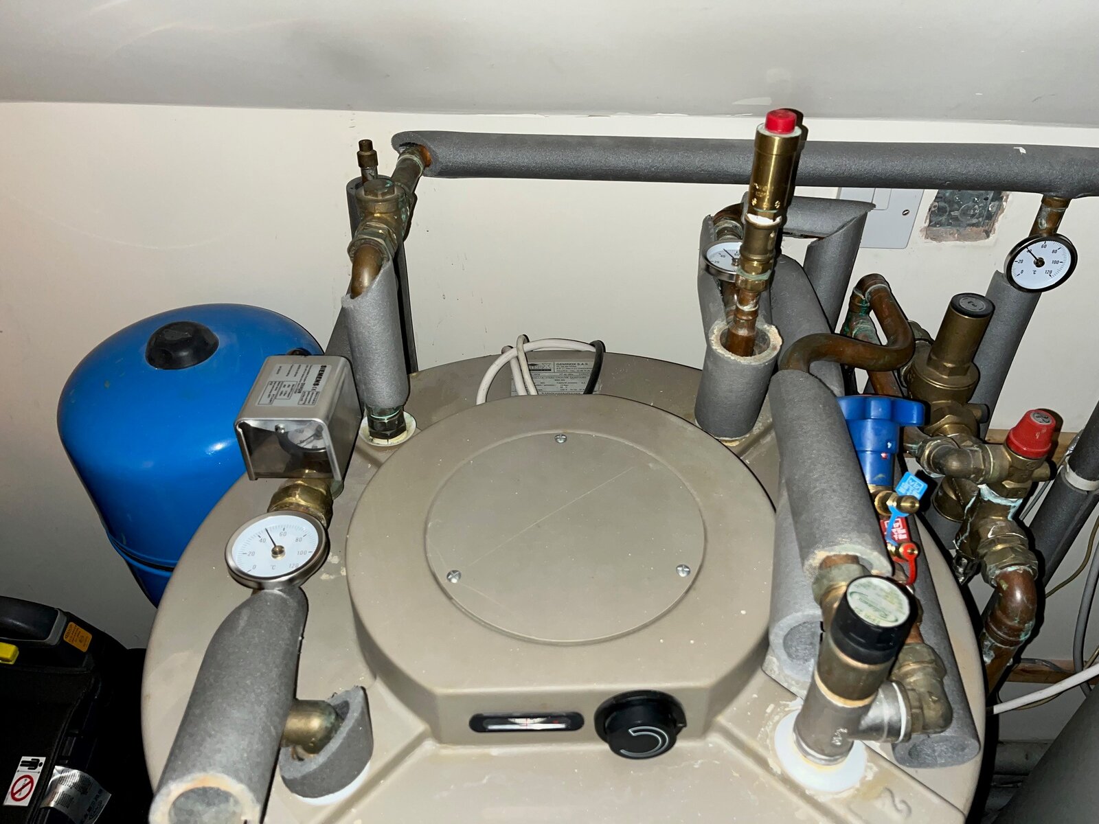

I can discharge hot water from the slow cylinder, with either the red PRV from the cold loop going into the cylinder, or from the one which is connected to the hot water outlet from the cylinder - it discharges very hot water only.
I would have thought the red PRV from the cold loop should only discharge cold water, but it seems the hot water from this cylinder is heating up the cold inlet (probably because it is not discharging). Picture attached.
Also the hot water outlet from the cylinder feels warm all the way to where it meets the other cylinder and goes down into the house hot water loop, so water is in there.

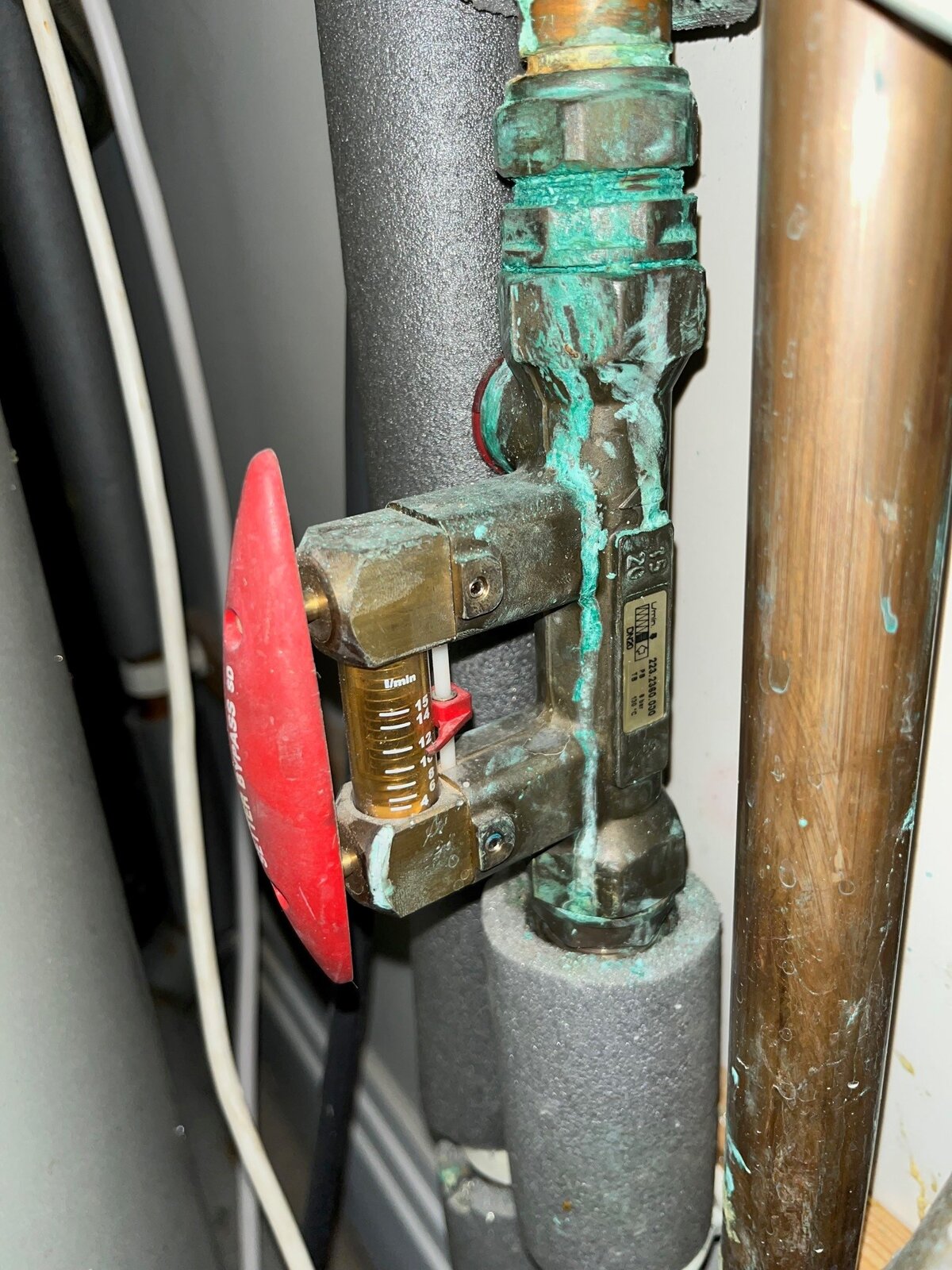

I've also noticed this Setter flow valve on the heating loop into the slow draining cylinder, not sure why it was installed and what it does exactly. From Google it seems to adjust the heating flow into the cylinder - but this isn't really an issue in the first place as the cylinder heats up fine.

So I can shut the cold water going into each cylinder with a turning type flow valve - but I don't know how to drain out the water from the slow cylinder
Do you mean a gate valve with a handwheel when referring to the turning type flow valve?, if you can isolate this and isolate the regulating valve from the hot outlet then you don't have to drain down the cylinder to access/remove the pressure reducing valve, just open the expansion valve adjacent to it by twisting the top and when water stops flowing then you can deal with the pressure reducing valve or any/all valves on that section of line.
Yes I think thats the technical term a handwheel gate valve.
Again this morning as I am working from home, I closed the handwheel cold inlet to the fast cylinder and closed the valves on the hot water outlet to zero - and I left both fully open on the slow cylinder - no hot water was produced after a minute or so. The hot water outlets from the slow cylinder seemed hot but for some reason it is not going into the house.
I've now shut the cold water inlet to the slow cylinder but left the hot water valve fully open - in the hope that slowly over the next day or two some water should escape from this tank. If we have a shortage of hot water over the next couple of days, it would also suggest something is coming from the slow tank. Lets see!

Try this, shut the cold and hot valves on the fast cylinder, shut the hot only on the slow cylinder, open the expansion valve (by twisting the top), cold water should start flowing out, if only hot/lukewarm then problem is on the cold feed, probably the pressure reducing valve.
