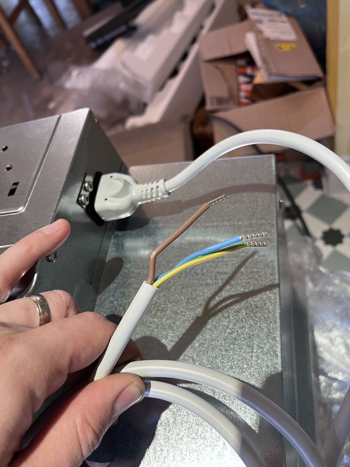

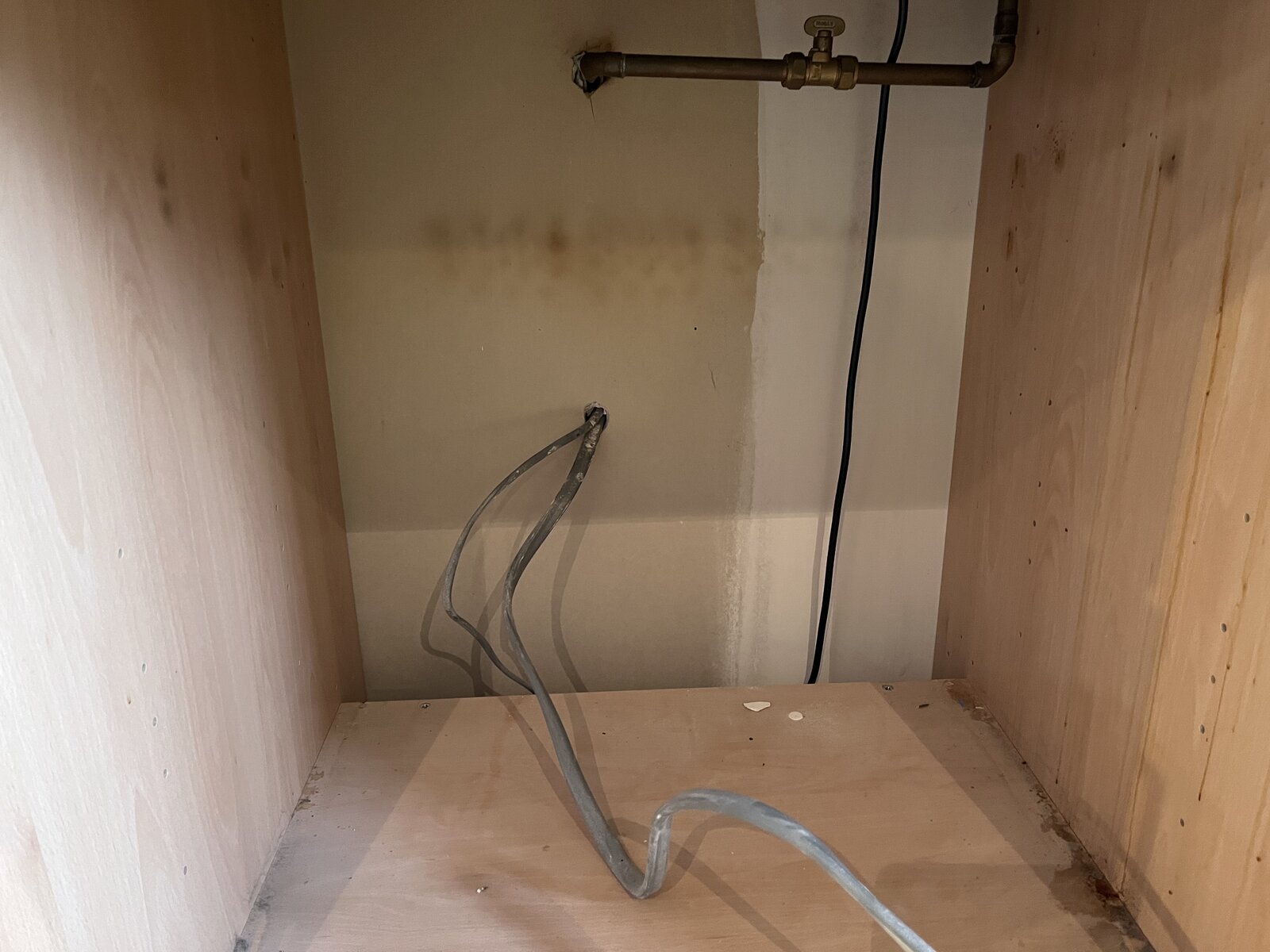

Hi!
Just had a new cooler arrived and realised it has its own fitted cable in the back (Miele).
Pic 1 shows the new cooker
Pic 2 shows the old cooker attached to cable

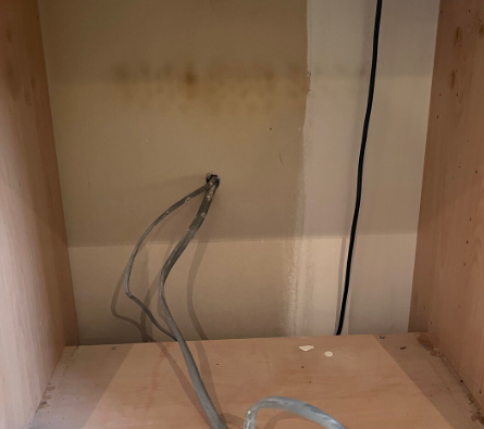

Pic 3 shows cable running behind plasterboard
I am thinking all I need to do is use a junction box to connect the existing cable to the fancy cable of the new cooker. Is this correct? If so, what kind of junction box, do I need to use?
For context, I have replaced cookers before, replaced other electrical appliances in the house and built my loft conversion. So I’m sure this is very manageable with the correct advice!
Many thanks in advance

Also the existing wires are thicker than those on the plug of the new oven - if using a junction box is this a problem?
It doesn't look tiled.
Oh sorry behind the cooker! I’m not sure I understand what you mean I’m afraid. Would I use the socket you have advised in the same way a junction box is used:
You have three holes on that socket, and so two wires of the same colour would go into each of those three holes right? How come I can’t just use a junction box, am I okay to join the different sized wires? I really appreciate your help!
Well - in that it connects wires together; yes.
You fit a back-box in the wall (looks like a plasterboard one needed) and screw the metal part of the connector to it,
fit the wires and screw the cover on.
Yes.
Because doing it properly is better.
Yes.
If you don't want to then you could buy a dual connector.
Yes.
Yes.
Thanks so much for all this.
I’ve done it temporarily with a junction box (as I had it handy) and called an electrician - they thought ideally the fuse needs to be brought down to match the amps- the old cooker was 32 amp in a 32 amp fuse. The new cooker is 16 amp fuse so they’ll match that. Seems a bit ott to me but I suppose I’m not too comfortable just leaving it.
But it is working!
(y)
Ok. Not essential but if it gives you peace of mind...
But it is working!
Good.
