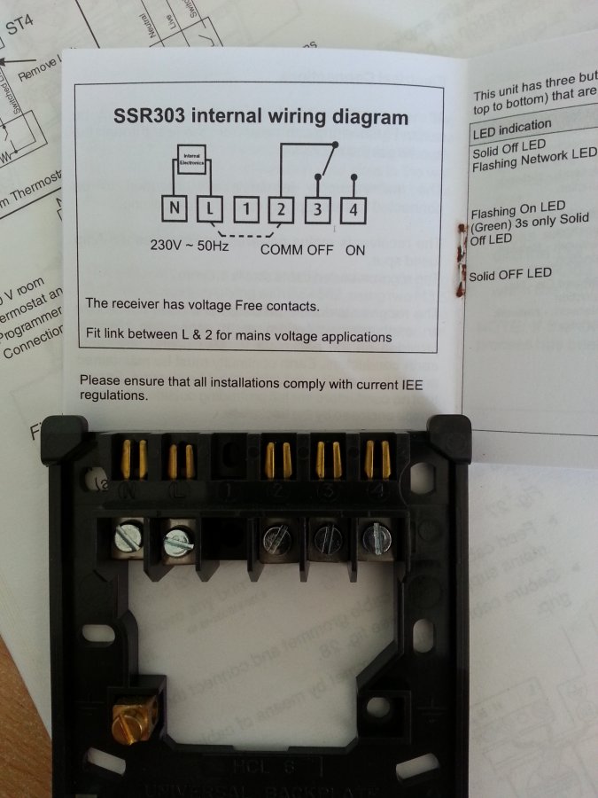

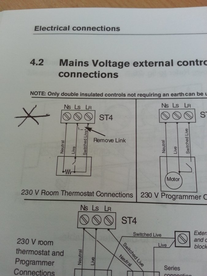

I wish to add a room stat to my CH system. The manual for the boiler shows the connection to the receiver as shown below
and that for the receiver is shown below
The receiver instructions also state that a 3A fused spur should be used to supply the receiver with L and N....so do I run 3C+E cable from the boiler's connection to a 3A FCU and then to the reciever? :) Sounds too easy
The boiler's mains power should already be taken from a suitably fused outlet so take Live and Neutral from the boiler terminals LS and NS to the receiver. Then if you connect the short wire link (shown dotted) in the receiver you only need a single wire connecting the receiver terminal 4 to the boiler LR.
Don't forget to remove the link in the boiler between Ls and LR.
