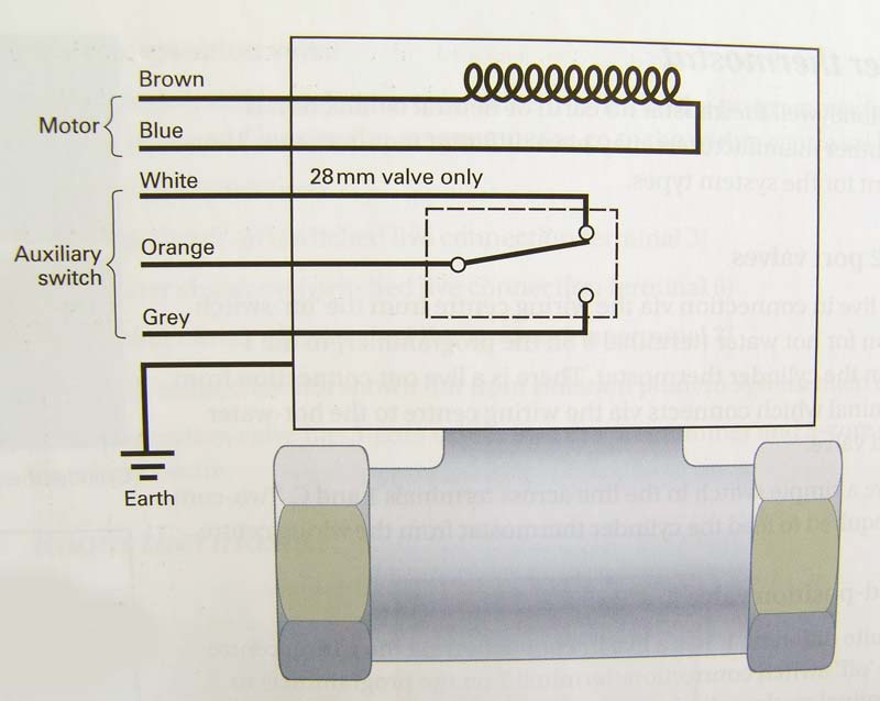

Just wanted to check the wiring on 2port valves,
so long as i connect live and neutral, the valve opens, (ie brown and blue), The Orange and Grey are effectivly in built switches to turn on something else - any voltage/current going through them would be whatever is put in at one end?
No
Blue is neutral
Grey is permanent live in
Brown is switch live in (from a programmer, for example)
Orange is switch live out (to a boiler, for example)
Yes
Grey and orange wires are connected to a microswitch
If you put 240 volts on grey, when valve fully open, 240 will appear on orange
If you put 1.5 volt in grey, that is what will be presented on orange when valve opens
If you connect your multimeter across grey and orange, you will see an open circuit until valve closes, when meter will show a short circuit

Also remember that when operating the lever it only throws far enough to open the valve, it does not go far enough to actuate the micro switch.

Yes that is all correct!
