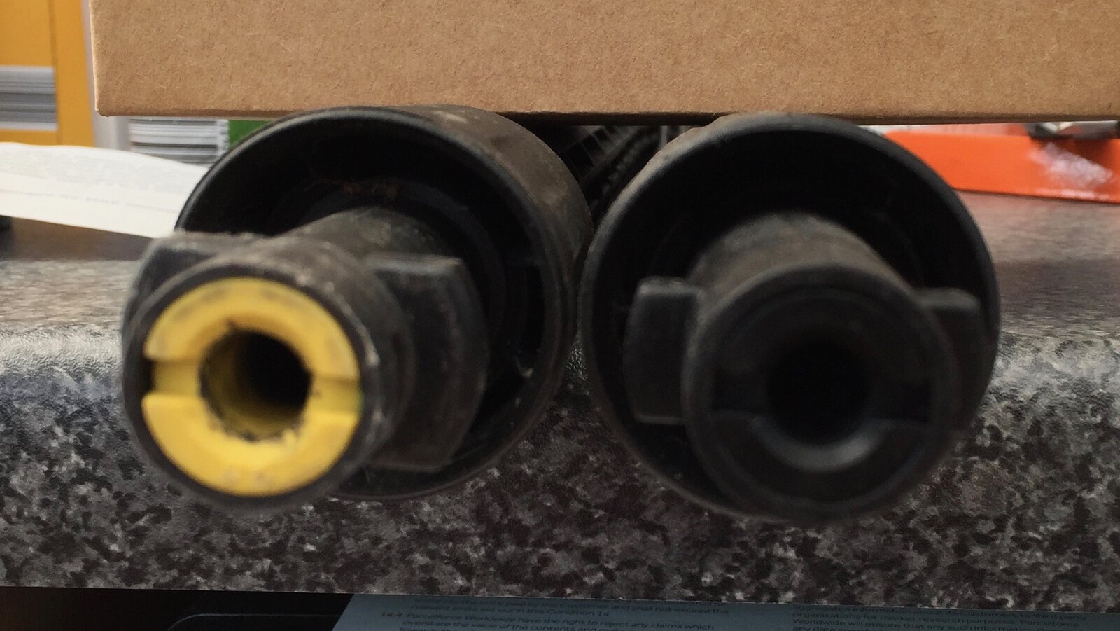

Been using this little unit a fair bit now, fairly early on it became apparent that the 4m hose was restrictive. I've since bought a s/h 6m hose which had a trigger and an extension included. The extension although looking the same as the one I already have differs, the lugs are smaller @12mm as opposed to all the other accessories I have being 18mm, does the black insert colour help identifying it? The trigger will accept either extension but this second extension seems of little use at the moment as it will only accept the smaller lugs at the other end. Appreciate it if someone could throw some light on this for me please.
