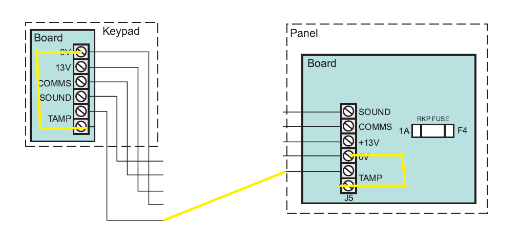

Hello all,
I recently posted about a power fault to the keypad. After a couple of weeks figured the black wire was not working between the keypad and the alarm panel.
That thread can be found here......
https://www.diynot.com/diy/threads/unusual-accenta-g4-honeywell-fault-keypad.555738/
I have changed the battery.
CURRENT PROBLEM
The cable that runs between the keypad and the alarm panel is 6 core. All 6 cores appear to be used. The cable is plastered into the wall.
The black wire does not have continuity so the keypad does not work. I ran a separate cable between the alarm panel and the keypad and it now works to power up. However the cable is unsightly.
  • As a work around I wondered if I could use the blue core wire as the black negative?
  • Doing this means the speaker in the keypad does not work. I am not too bothered about that.
  • So I have done this and run the blue core as the black core.
  • On powering up the alarm the siren goes off.
  • The keypad takes the previous disarm code and says unset.
  • However the siren does not stop.
To confirm, I have put the keypad and alarm panel boxes back together so no triggers are being set off.
Can anyone suggest how to stop the siren in accordance with unsetting the alarm? Or why the alarm is now unset yet the siren continues.
Thank you in advance of your help.
Cheers all.

Hi Secureiam,
Thank you for this. Is there any chance you could please dumb it down for me? Re the manipulation of the wire in the keypad.
Yes the siren was still ringing even when unset.

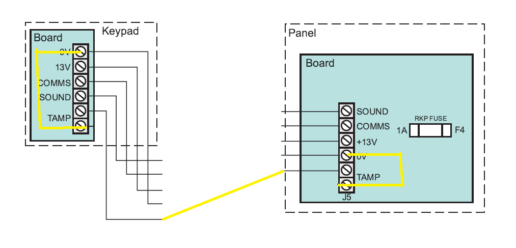

I would guess you would use 0v linked at the keypad to one side of the tamper switch and a single 0v return at the C/P
Thanks Sparky.
Sorry, would you also mind dumbing it down a little for me please re the 0v and what to do with the keypad! Cheers.
Probably something like the image.
I would have to test to be 100% confident.
First thing to try is link out the tamper at the panel for the keypad and wire the other terminals as normal and see how they keypad behaves.

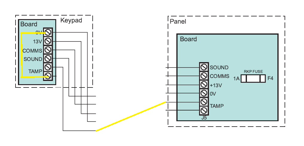

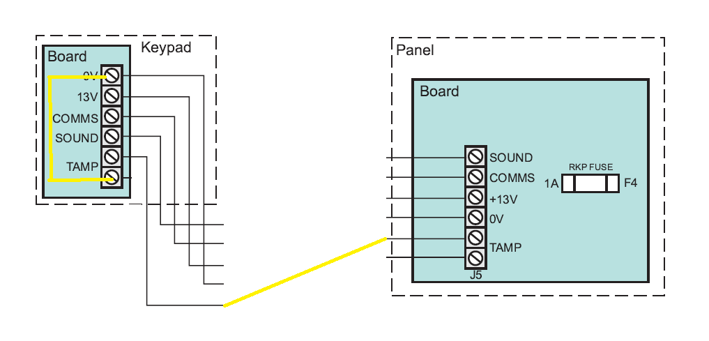

Not 100% convinced we know the full picture.
I would have to test to be 100% confident to be fair.
Then the keypad has to get 0V to the panel (assuming that's the healthy condition), the question is which terminal does it have to reach.
You probably dont need the 0V at the panel end linked in just the wire coming back from the keypad to the correct tamper terminal for it register to be secure.
First thing to try is link out the tamper at the panel end for the keypad and wire the other terminals as normal and see how the keypad behaves.
if the keypad functions fine but no tamper we can move on to the next step.
