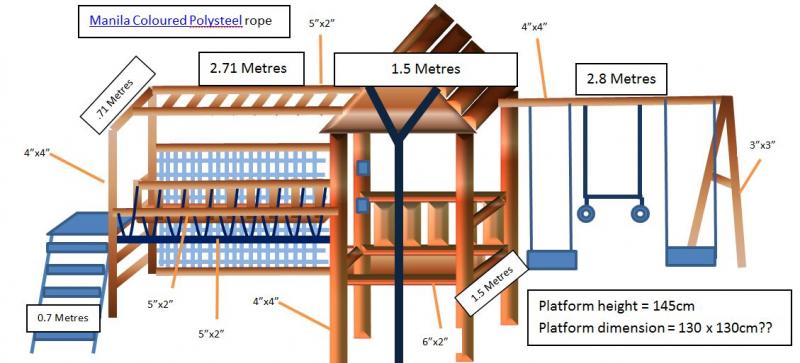

Hi,
I'm planning on building a kids playframe based on the attached picture. I've guessed what size timber I should need as shown in pic. Does anyone have any comments on whether my timber sizes are ok for the spans, or any other comments (constructive critisisms welcome). Could someone advise me, i'm not sure whether to concrete in the 4x4 posts or use post support bracket and bolt them onto a concrete pad. Also, should I use stainless steel bolts or those green ones? Also which size should I use, M10? and if anyone knows where to get cheap bolts suitable for this project i'd be very grateful. Also, which timber (tanalised green or tanalised brown) or something else. Also please let me know if i'm bonkers attempting this and should just buy one. I've priced up something like this which would cost around £1200. I reckon I could make this for a fraction of the price (correct me if i'm wrong). Any comments welcome.
Many thanks,
Andrew.
This structure seems to be largely self supporting - maybe with the exception of the RH swing legs which I think could benefit from 4x3" beams......therefore there wouldn't be any great need to concrete the posts in - just bolt them down with sockets/brackets etc.
For bolts, use A2 stainless (Screwfix or similar) - if you cant get the length you need then studding is available.
With these sections I'd go for 12mm bolts, coach head for easy self assembly, and over engineered for that 'sleep at night' factor.
Tanalised timber is required, but its often rough and subject to spelks etc.
I don't know about building this at a fraction of the sale price - you may well be surprised at the end cost - you will save a fair bit but it'll take some time too.....lets hear what the others have to say.
There's no hand rail for the steps, but this may be splitting hairs.

you got 6 x 2 joists supporting a small platform, but only 4 x4 for the main beam on the swings ?
suggest you make it 6 x 4 (145 x 90 ) easily done by using polyurathene glue and some screws.

Hi Fencer35,
Yes I see what you mean. Slight mistake there, i'm thinking of 6x2 on the side where the bridges start. Off this 6x2 I will have joist hangers supporting the 5x2 bridges. It's not clear on the pic but there's 2 bridges, the rope bridge supporting a 5x2 to walk on, and behind that there's a standard walk bridge. But yes, besides the 6x2 supporting the bridges, 4 or 5x2 will be plenty? Are you saying 6x4 for the swing beam? I would have thought 4x4 would be sufficiant (correct me if i'm wrong), I was thinking of buying one of those metal 'A' frame brackets which hold the 4x4's together, another £25 to the expense though. Would you just use polyurathene glue and some screws for this instead?
