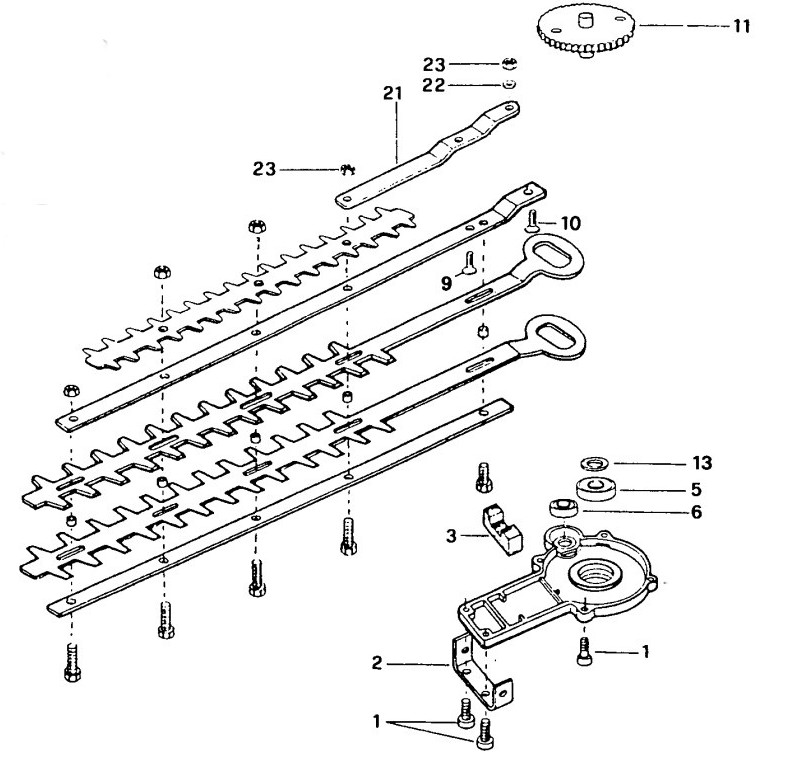

This shouldn't be a difficult job, it's only checking continuity over a couple of wires. Have a look online for an exploded diagram of your trimmer, then you can see how everything goes together/comes apart.
Can we have a pic of the errant wire please? The wire is usually single strand and varnished but it's easy enough to extend- if that's whats needed.

The attached photos is where i had concern as i didnt see what keeps the bottom section connected to the bottom of the body
