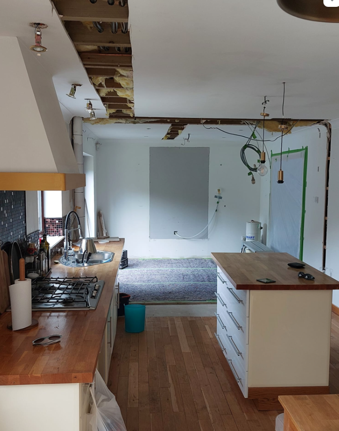

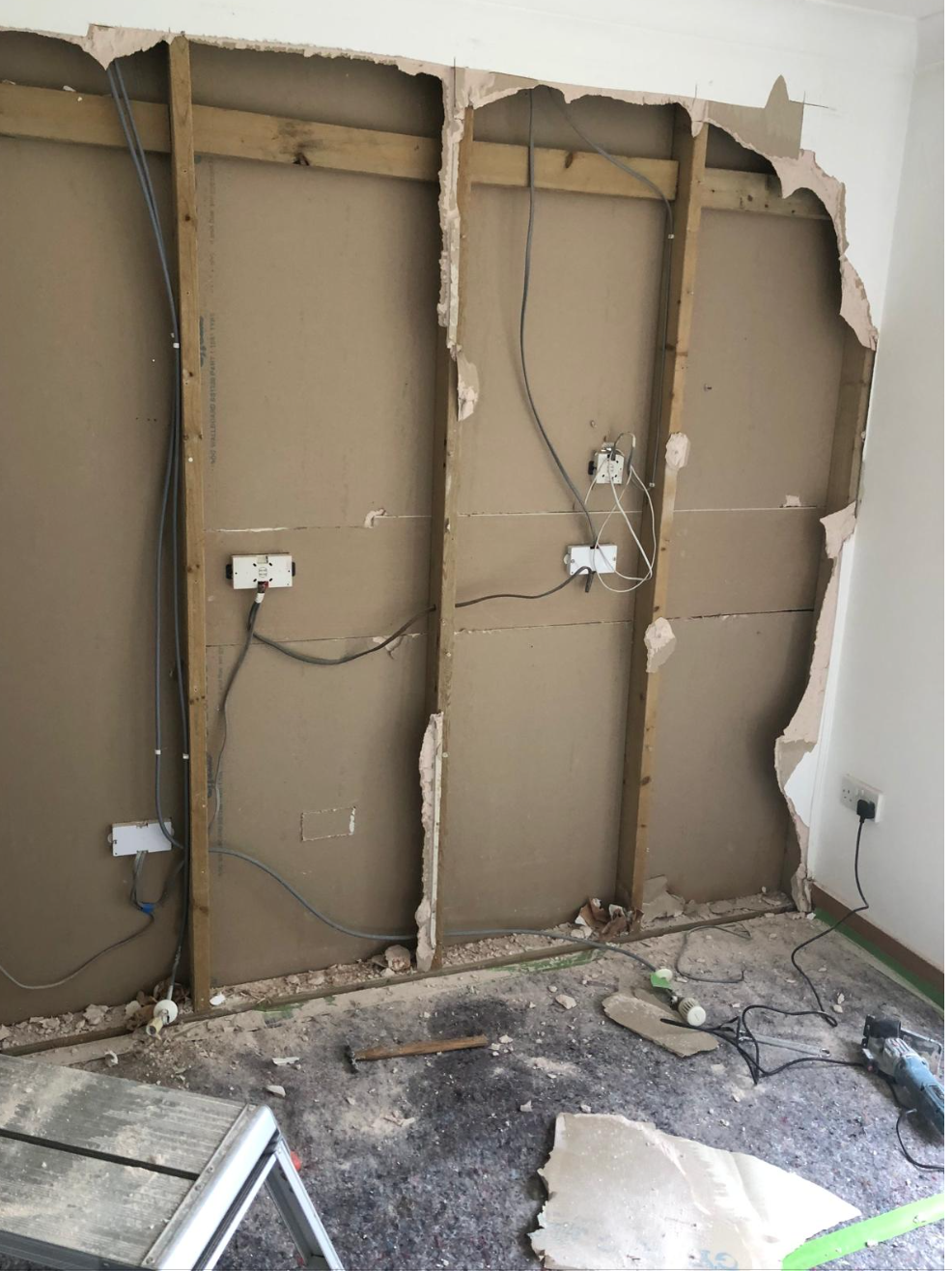

Made a start on taking out a wall between my kitchen and dining room. I stupidly mentioned the possibility to the boss and she's forcing it through!
WE built the house 29 years ago, and I was 98% certain the wall was non loadbearing, but handed over £180 to a local SE for him to confirm it.
Council were uninterested other than that fact, and in asking me about the stairs being still enclosed and fire exits etc.
So Day One...

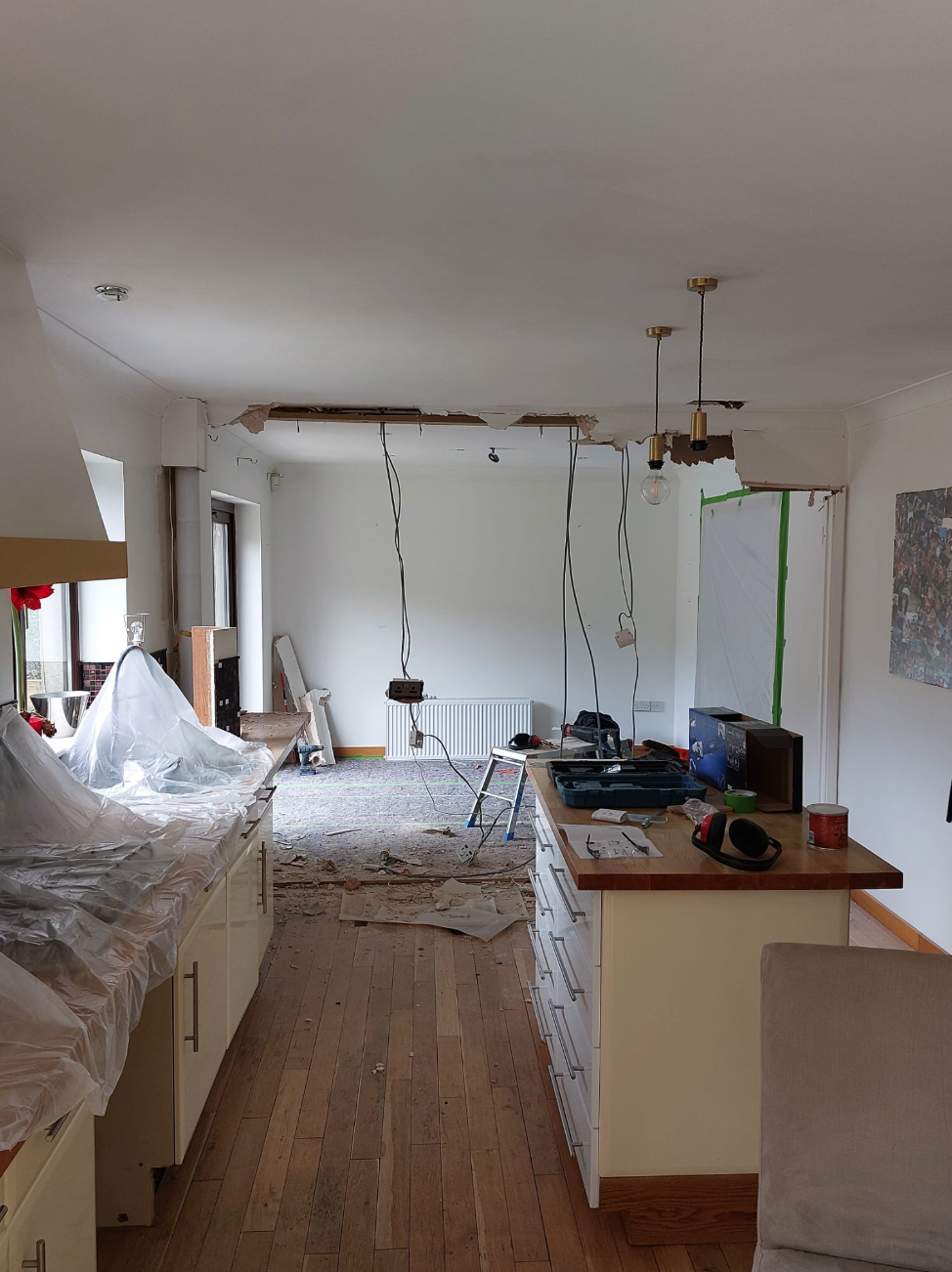

Mind all that mess on your nice wood floor or you'll end up with twice the work.

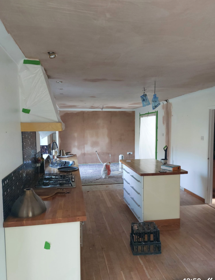

Wiring (inc new CU) all done for the appliances and new lights, pipework moved for the radiator that was on the demolished wall done at the at far end, plastering prep Friday, plastering proper, Saturday. I hope!

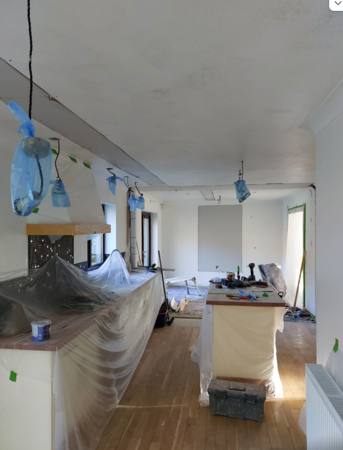

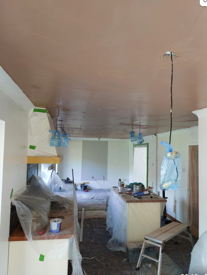

Gawd no! My great nephew and his mate from work stepped in (his Nan made him lol). Ceiling's done now, I'll post a pic tomorrow. The far wall and side gashes where the wall was will be done tomorrow.
When I plastered the ceiling, I just used thistle multi finish. Only used one coat and painted over.
