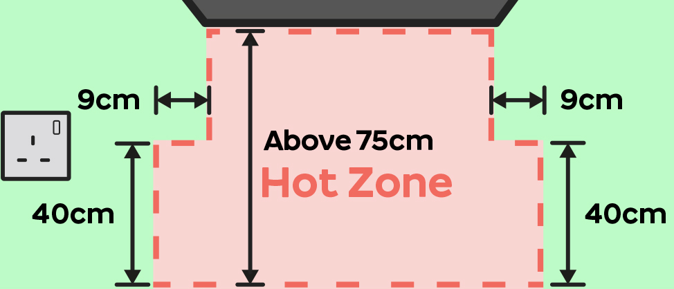

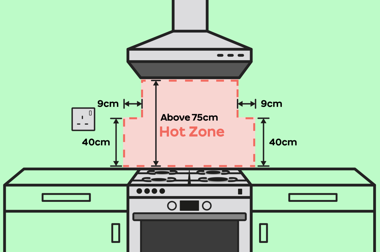

just been told its a GAS cooker, freestanding , and it was the normal sockets on the wall that they said need to be a certain distance and sent over some documents
Sorry for that, not getting all the information or not asking the correct questions , depending on point of view :) :)
I know my hob at 200°C Reduces Power Boost setting to Power Level 9, at 250°C Reduces power to 60% of power level setting, at 270°C Switches cook zone off, and at 300°C Switches whole appliance off. So there is not much chance of anything near the cooker being damaged. In the main we cook at 100°C a pressure cooker goes up to around 121°C (at 15 PSI) and a frying pan or deep fat fryer around 190°C so with an induction hob most woods will start to burn at around 300°C so even if the cooker hood was made of wood and was 1 foot above the hob there would be very little chance of fire.
Gas however is very different, AO show this upload_2022-4-25_12-41-49.png on there web site giving the minimum distances
and it would seem prudent to allow same distance for electric as gas, I know when I was fitting cookers years ago we went as a pair electrician and Corgi guy, shows how old now called gas safe, but if the gap was 10 mm too little he would refuse to fit. I would say around 25% of homes visited he would refuse to fit cooker.
