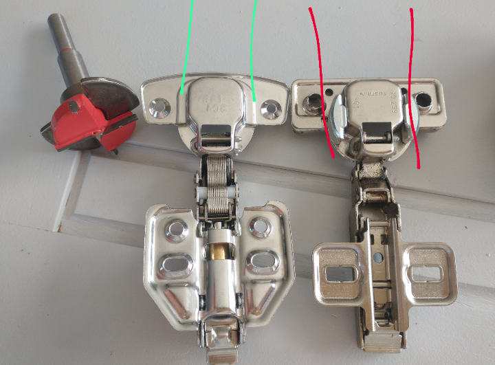

Making and installing a few extra kitchen doors for my place. The misses ordered the hinges of amazon. Wanting to know will they still do.
The left one is the newly bought hinge which is 24mm wide between the green lines. The original hinges that's on the other kitchen doors is 36mm between the red lines.
The new hinge still fits into the hole without much movement. Will I still be ok to use these..

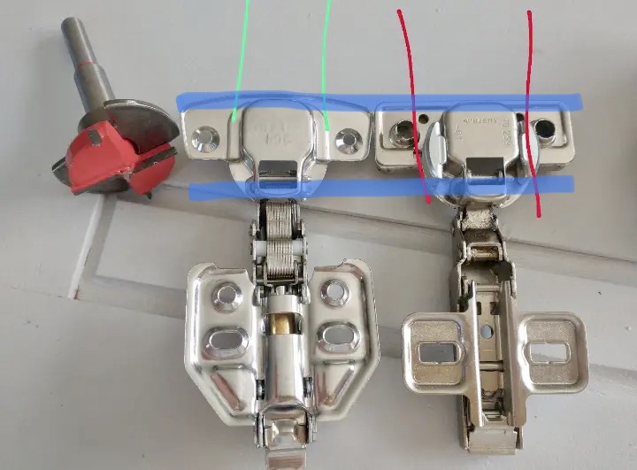

You measured in wrong direction both look to be 35mm hinges.j
That must explain why it's not to loose then . Although it's not as tight as the other one.
