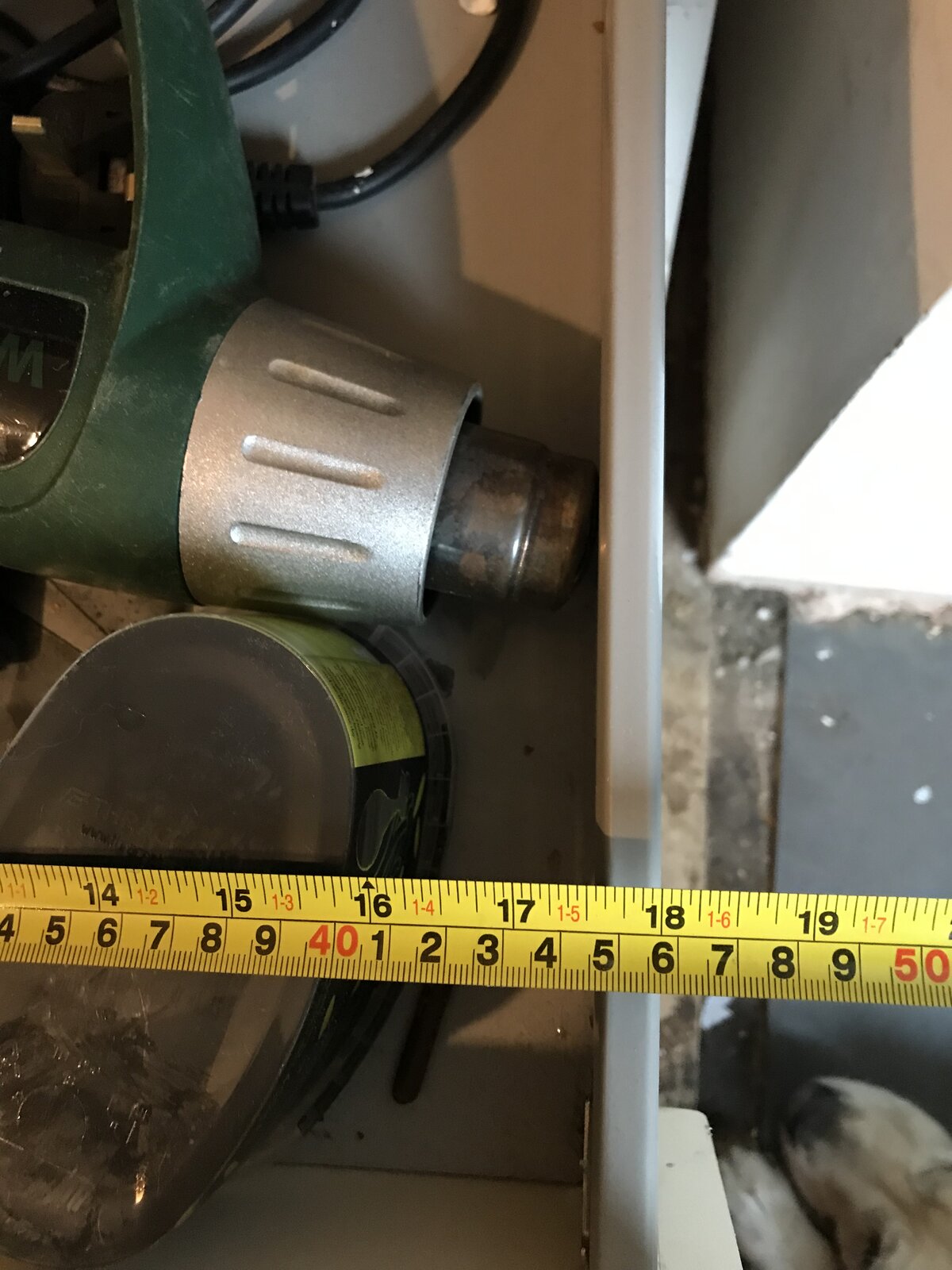

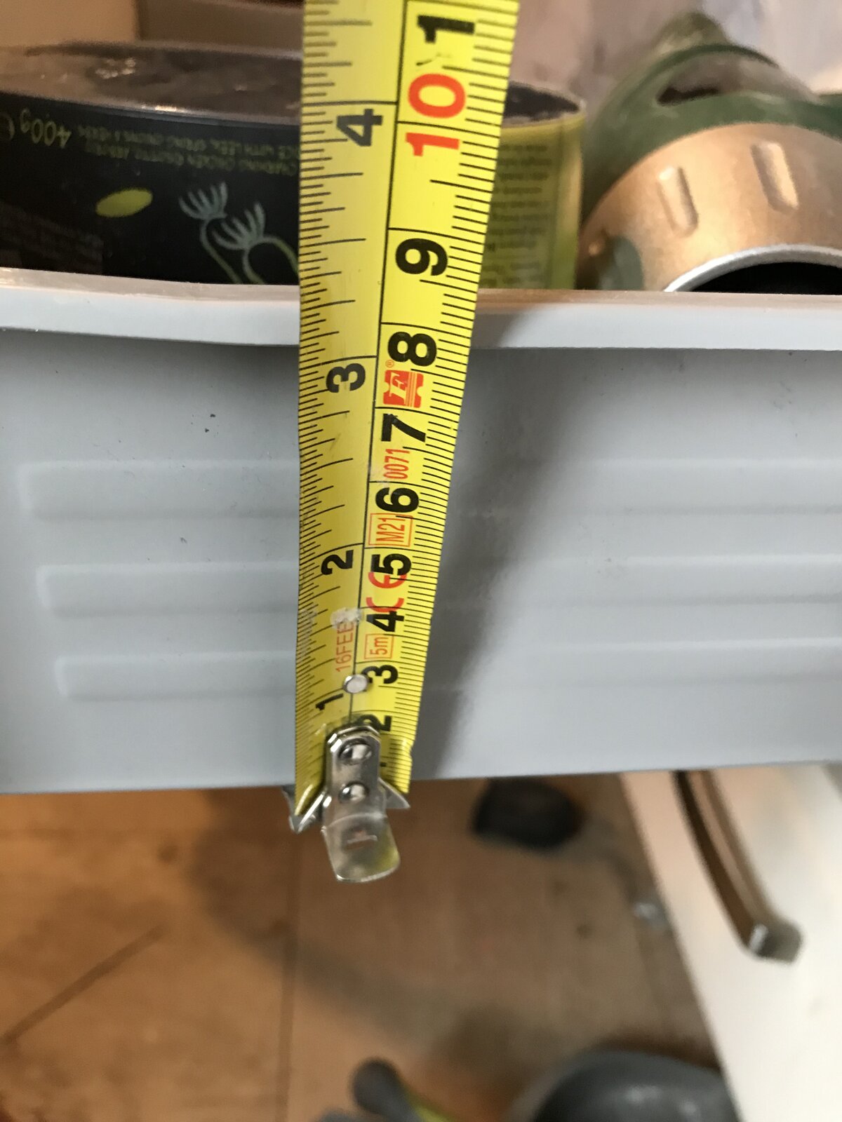

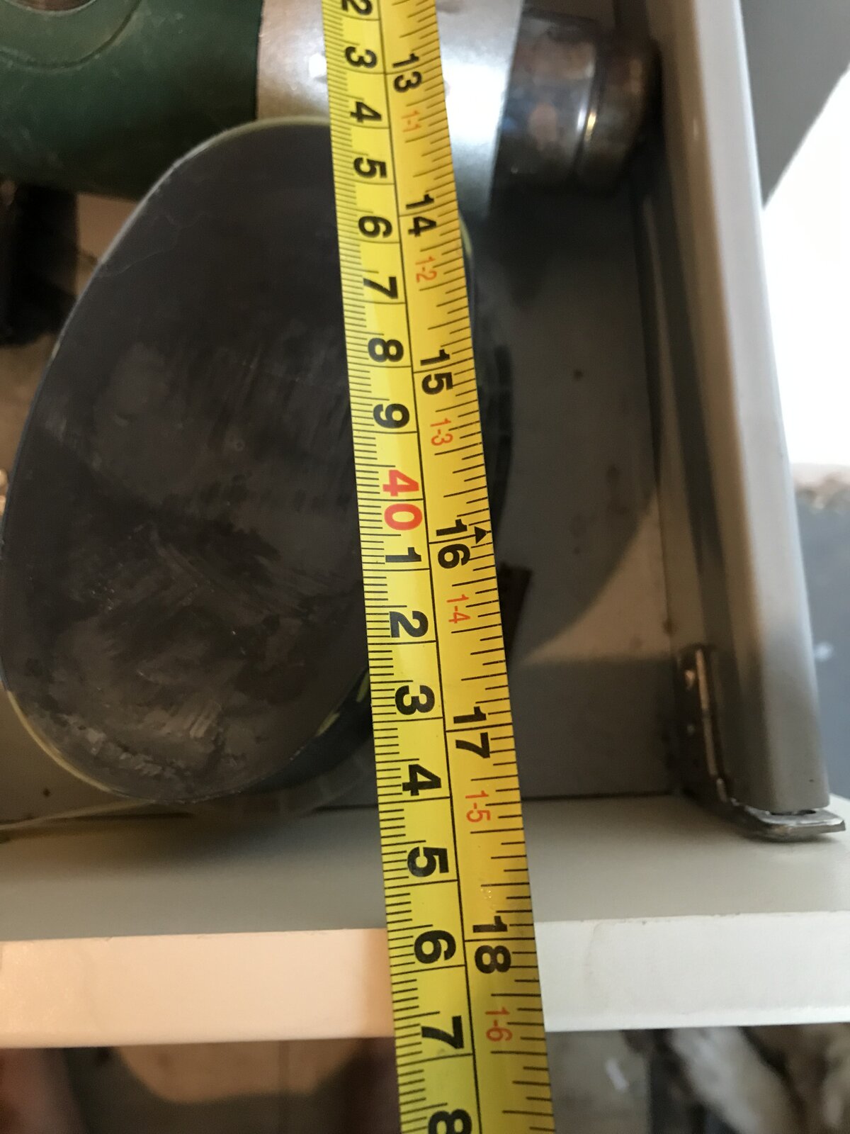

I’ve got a 500mm kitchen drawer unit that holds 4 drawers… does anyone one know if drawers are a standard size please as two of them are on their last legs!

Yes there are, and you may find one that fits your existing runners holes.
But they may vary depending on the thickness of the boards used for the carcase.
Include photos, from all angles, of your drawer trays and runners. Measure the precise thickness of the carcase, and the precise width of the cavity.
I usually get Blum soft-close which are fine, and sometimes Hafele. In a hurry, I once bought a B&Q drawer pack and was shocked at the poor quality.
Please explain what is wrong with your existing drawers.

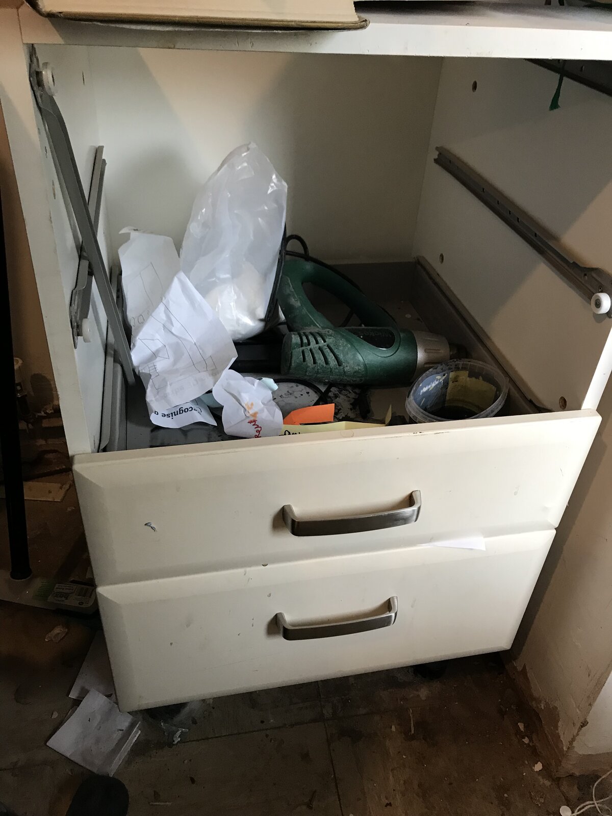

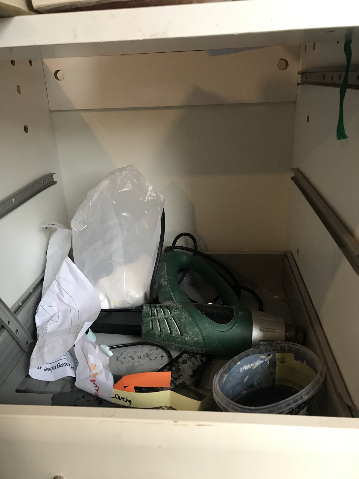

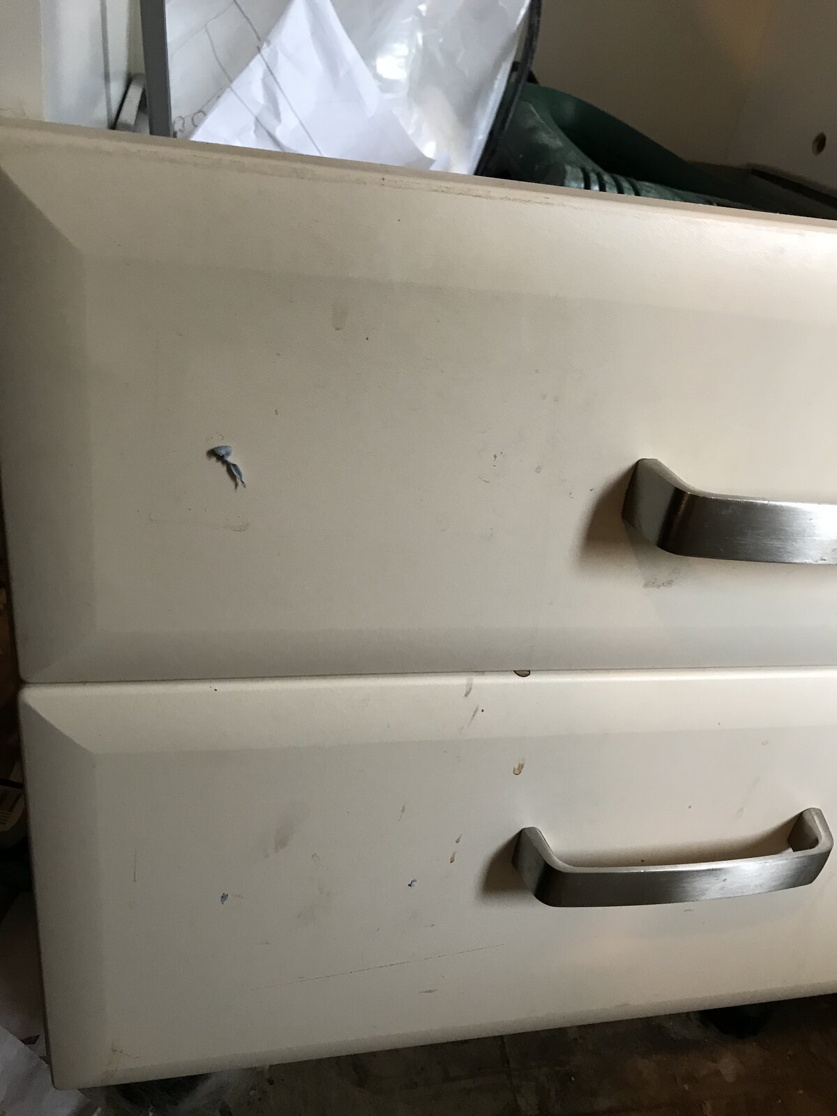

Here’s a couple of pics … I’ve actually removed the carcas whilst I do some
Plumbing work so thought now would be an ideal time to
Get it sorted and I don’t usually
Keep Tools I. Them Lol
Jake

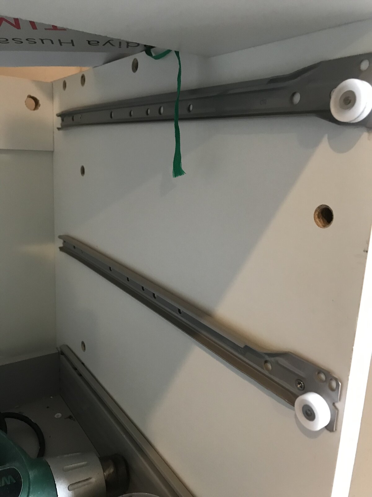

It looks to me like a couple of runners have come out due to loose screws.
Are there any other defects?
As far as I can see there is a metal channel with a wheel in the carcase, but I can't see one on the drawer box.
Ard there any letters or numbers stamped on them?
Are the drawer sides metal?
What is the thickness of the carcase board?

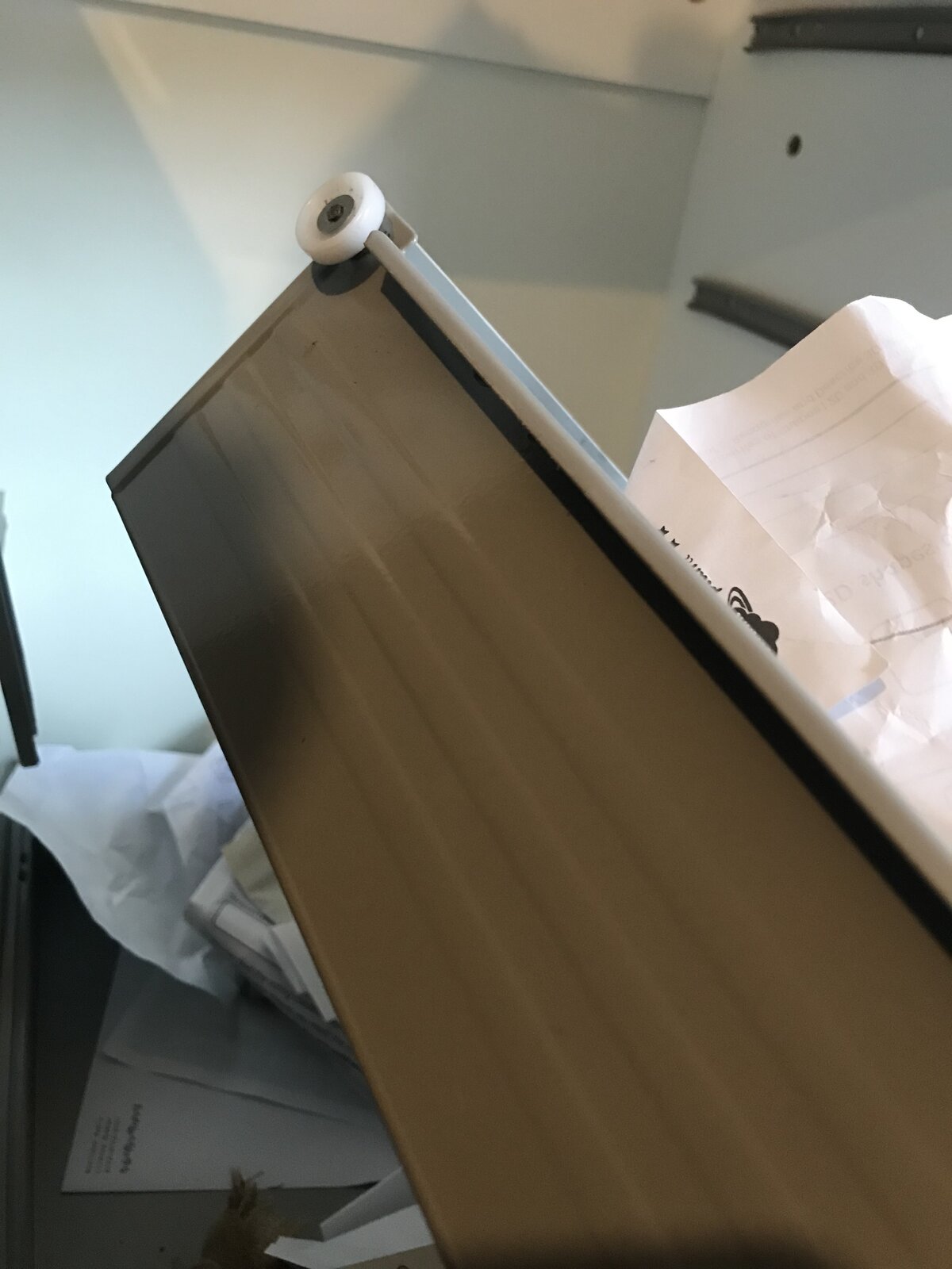

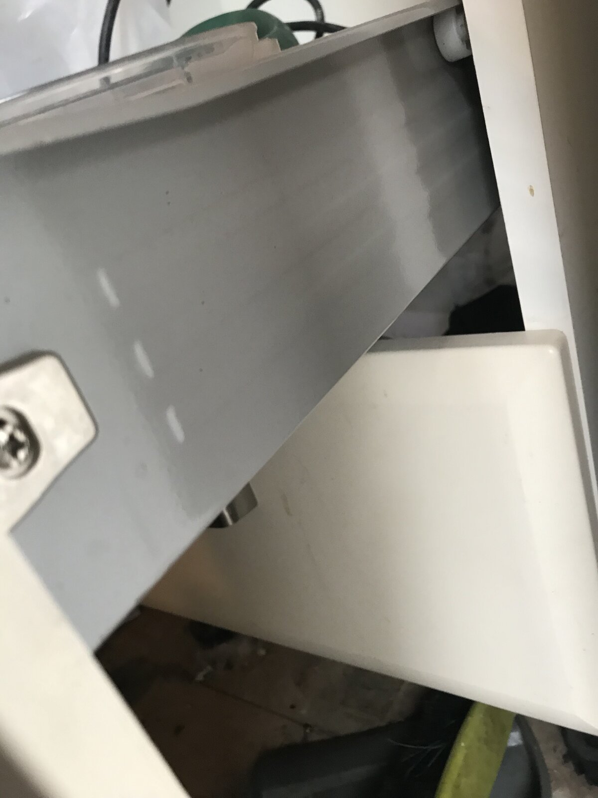

Hi John ,
I’ve got
The screw for the runner and no no other defects. Yes the drawers are metal, as mentioned Something damp
Got left in the and got
Damp and corroded.
I’ve checked for some number sn number etc and there’s nothing, the carcass is 18mm

Those metal drawer sides are available separately from Toolstation. You just cut make your own back bottom and front, and screw it together.
Is it the drawer box you are replacing or the fronts too?
here’s the sizes :)
Jake

I was looking, and new ones seem to be £20 to £35 per drawer.
In your position, I would look at drilling and fitting additional new Euroscrews for the runners. They have a coarse biting thread and you want the drawer runner ones with a strange recessed head. Measure an old one for size.

I'm pretty sure these will fit.
You can use some white chipboard to replace the wooden bits.
As for a a complete drawer box, already built, try your local kitchen supplier, even B&Q or Wickes should have something off the shelf.
