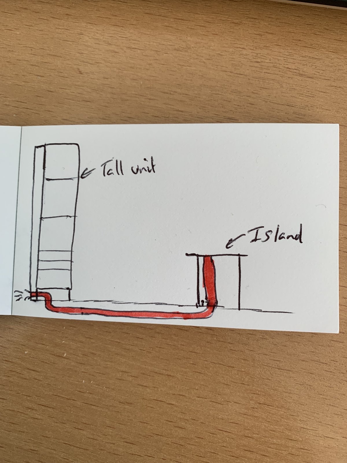

Kitchen extractor duct running under suspended floor and back up. Drawing attached.

The fan has a drip tray for spillages down it. Induction hobs are fantastic for boil overs as they just need a wipe with a cloth.
That’s dry ice, heavier than air , still doesn’t show what happens when you spill a pan of oil down it.
If that is the type of hob you are going to instal then search for a user/installation guide/instructions & it should tell you how to vent it away from your island.It may not be suitable for that situation but have to be next to an external wall.
