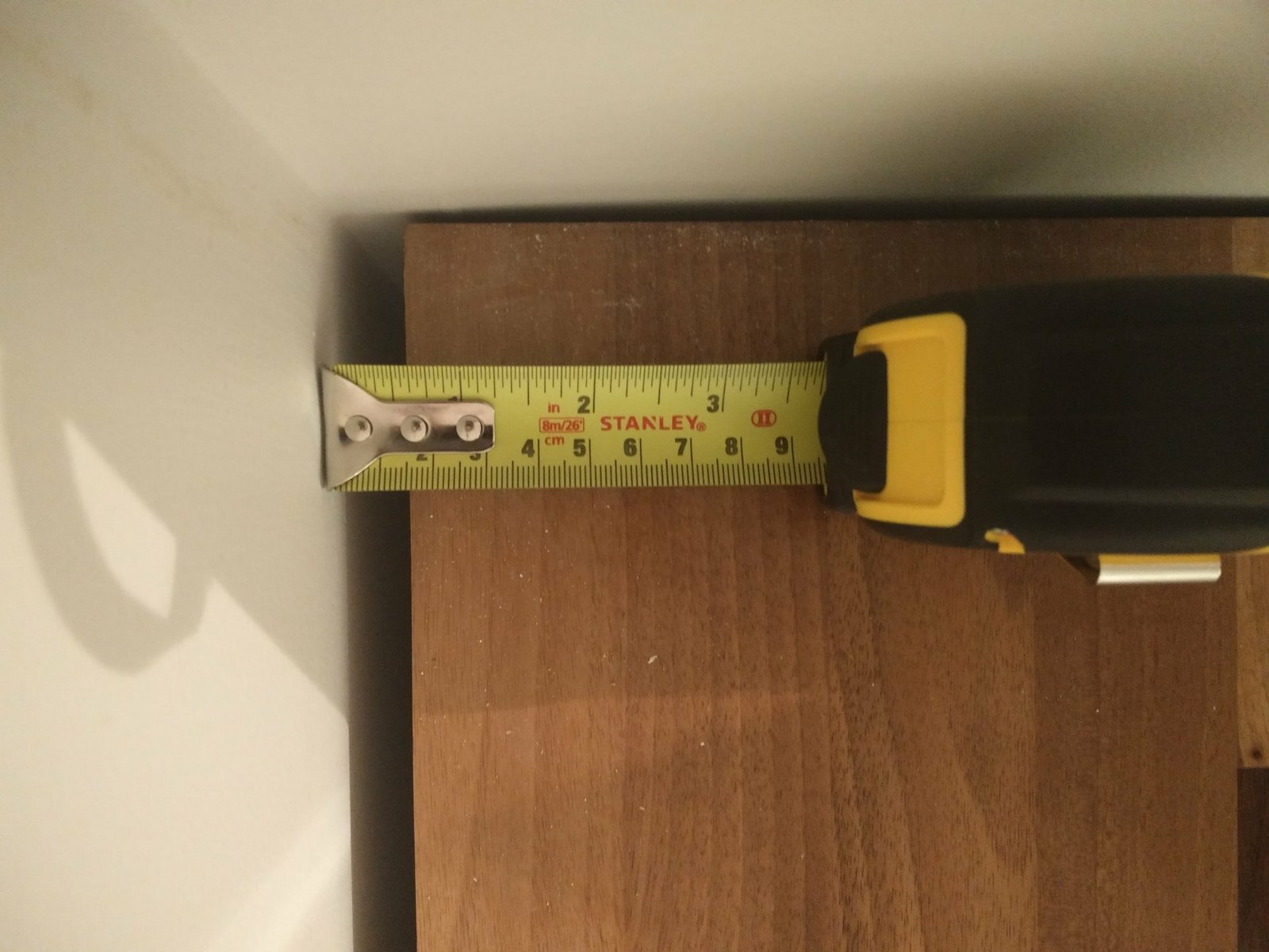

Hi,

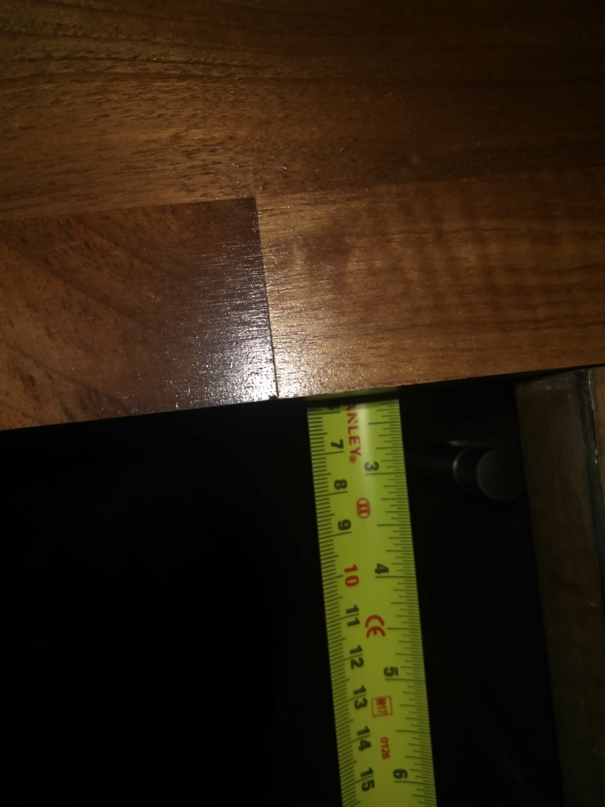

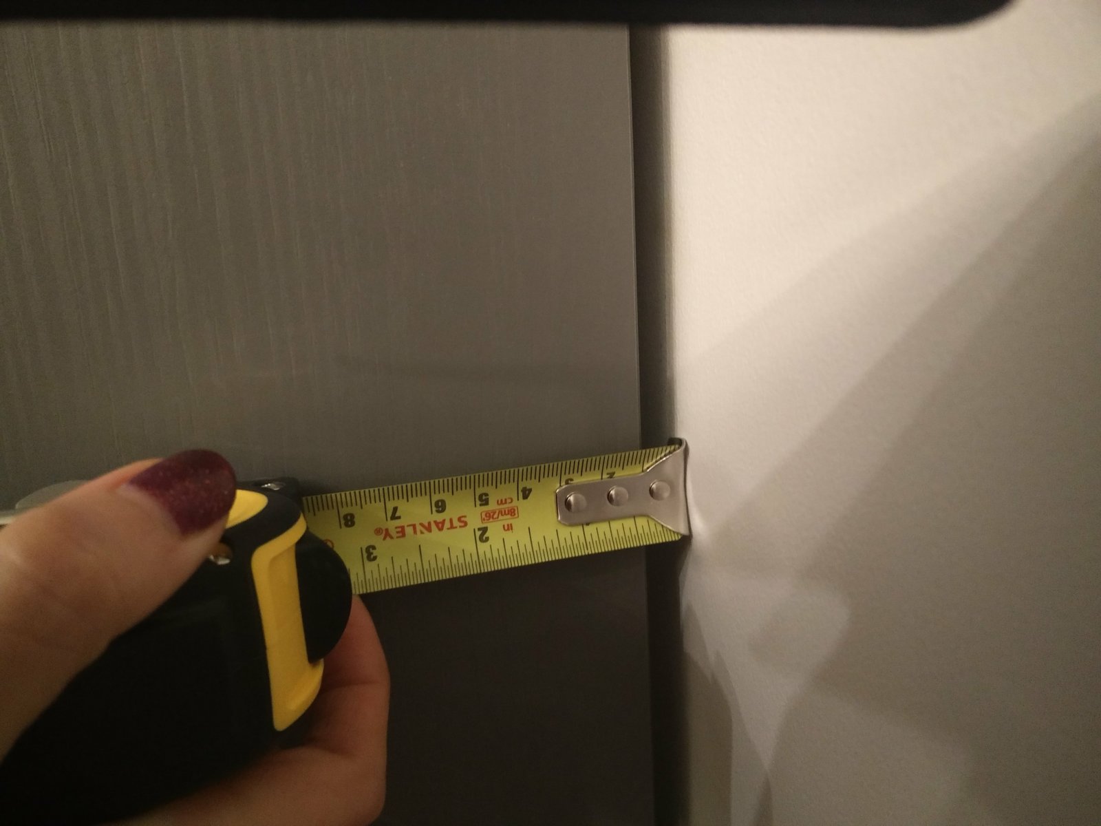

We have just had a kitchen fitted and are not happy with the finish. One of our corner units does not sit square to the wall and therefore the larder next to it doesn't either (larder is approx 10mm away from the wall on one side).

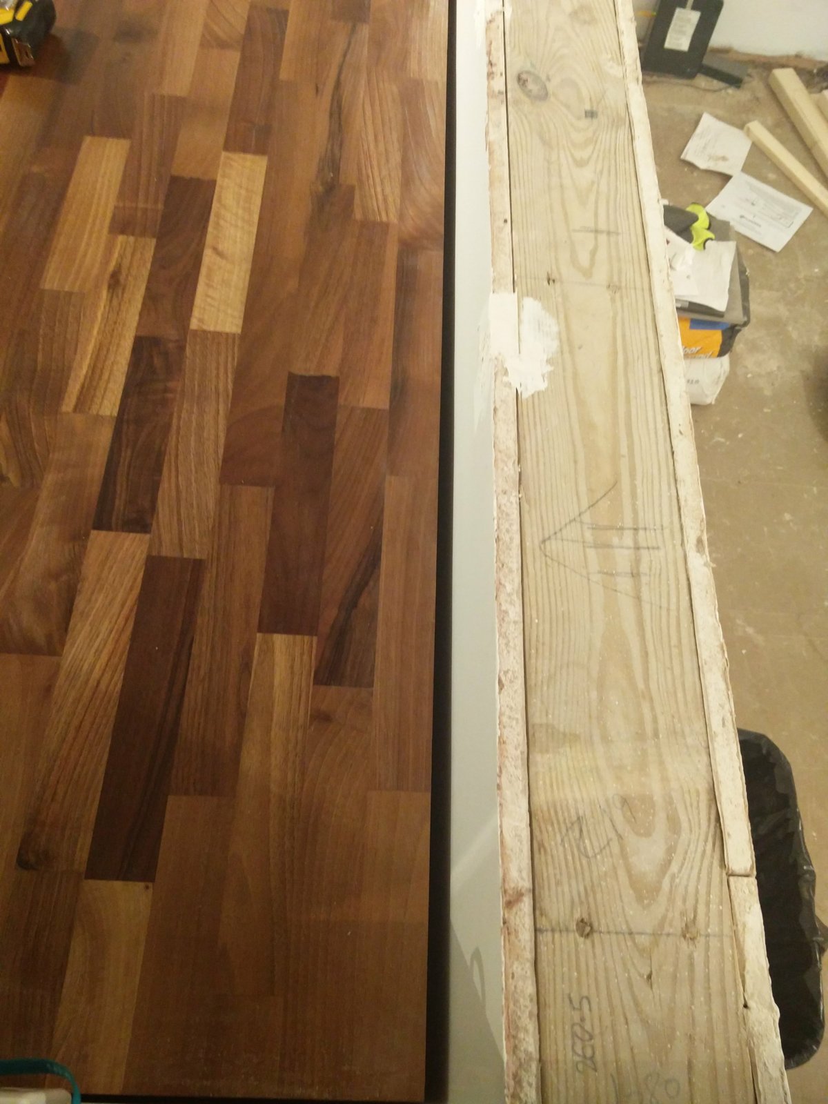

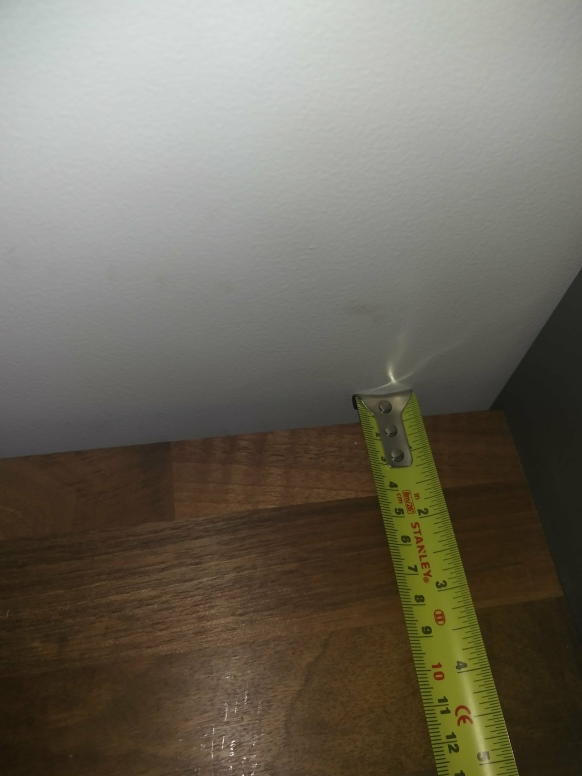

Two worktops do not sit parallel to the wall - one has a gap from 0 to 15mm over 2.5m, the other 1-2mm - 10mm over about 900mm.

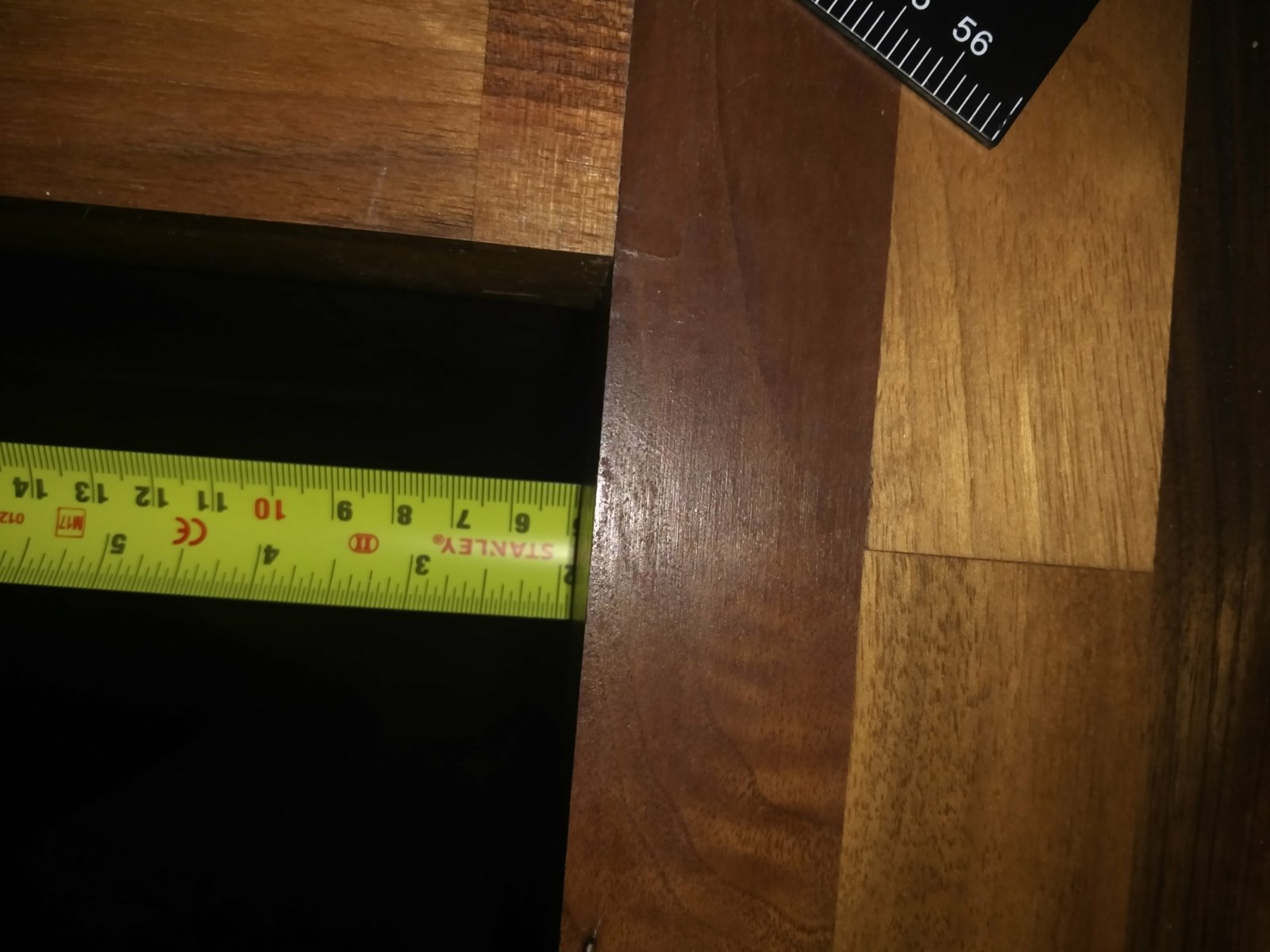

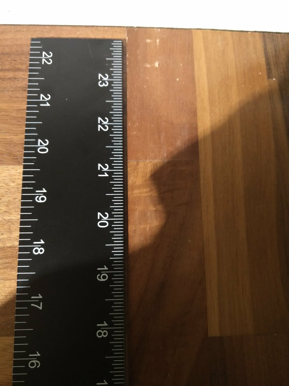

One of the worktop joints is not at 90 degrees its about 2mm off of square between the front/back to the worktop. This is resulting in the worktop moving away from the wall (by our calculations by about 6mm at the far end where the gap is currently 15mm). The overhang at the front of these cabinets is also not the same all the way along - being 49mm one side and 56mm the other.
The kitchen fitter is telling me is due to the walls not being square and we need to build up the plaster / tile to over the gap. He is saying they have done nothing wrong and it couldn't be fitted any better. He is also denying that the corner is not at 90 degrees even though the set square proves it is not at 90 degrees. To this he said i couldn't expect him to be more accurate than within 1-2mm of square.
We have discussed these issues with him but he doesn't seem to agreed that the fitting is at fault, but is just blaming the walls. We have tried to explain that if the cut along the worktop join was square or 1-2mm in the other direction most of these issues would be resolved. He has stated his cut is square (even though it is not) and that you 'wouldn't' ever cut to slightly off 90!

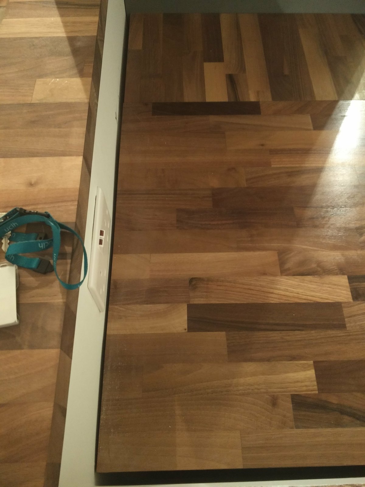

I cant make much sense of the pics -the close ups dont help.
Worktops -the joints should be cut to suit the room, not st 90 deg. Yours need to be re skimmed to pull close to wall. Its hard to get tight, plastered walls arent very straight. It shouldnt be glued, sealed with silicone or similar. Itll cone apart anyway.
The units should all be fitted in place first and the worktop cut to suit.
Why do you have such a massive overhang? 20mm or 25mm is typical. Was the worktop too wide? Or do the units need pulling out?

If you are tiling, a gap of about 5mm or so is acceptable to the rear. Its good not to bury the worktop under the tiles.

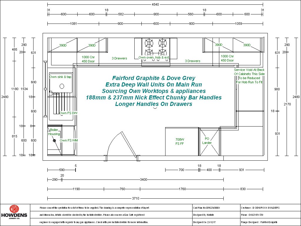

I also do not follow what you are showing in some of of the pictures particularly the thrid one. To be honest a plan of the kitchen area would help us to advise you.
Are you intending to tile or use Splashbach and upstands?

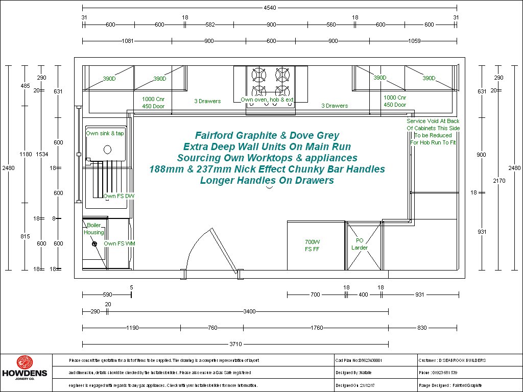

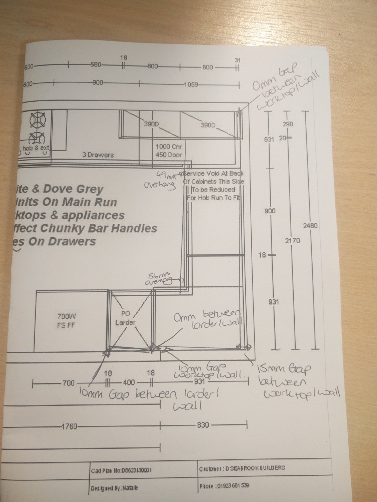

Hi, here is a copy of the kitchen plan.
We were planning on tiling along the hob run and window area, but didn't intend to tile around the other walls. However these are where we have 10 - 15mm gaps.

Don't understand why hob area needs to be narrower, would normally make fitting a hob more difficult.
Hi,
The hob run hasn't been made narrower. It's the cabinets running along the back wall that have had the service void reduced to fit the hob run length. I have tried to write on the plan where the issues are to help with understanding the problem.
Really we need to know if this is considered acceptable? Our fitters are denying they have done anything wrong and refusing to rectify.

I have since realised that the hob and sink are not even fitted squarely. They also cut one worktop too long and they cut a hole in the stud wall to get it in instead of cutting the worktop down.
