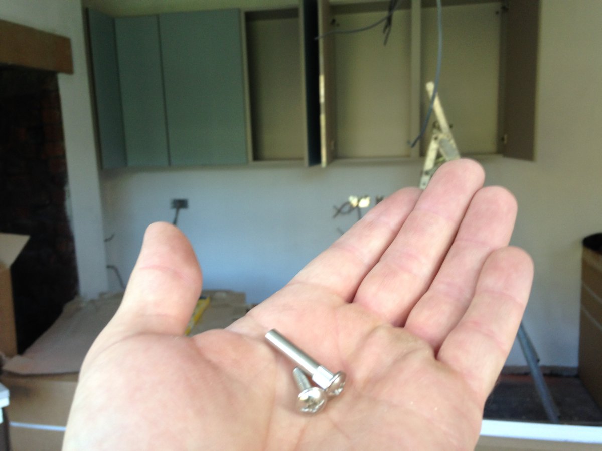

How many of these would you put between each set of units?
with the C&L units, you'll find 2 drill points at the rear top and bottom of the units, but just one T&B is necessary, but sometimes you'll fit one to the front as well - it just depends on how the units fit nicely side by side.
Thanks Doggit, I got an extra pack from screwfix so should be able to put at least 2 in each.

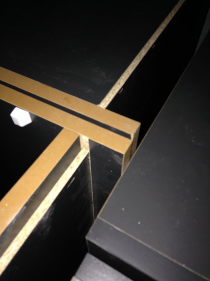

I had to hack a unit to make it fit, one of the expensive ones too!!
It looks a bit rough from the back but thankfully it fitted

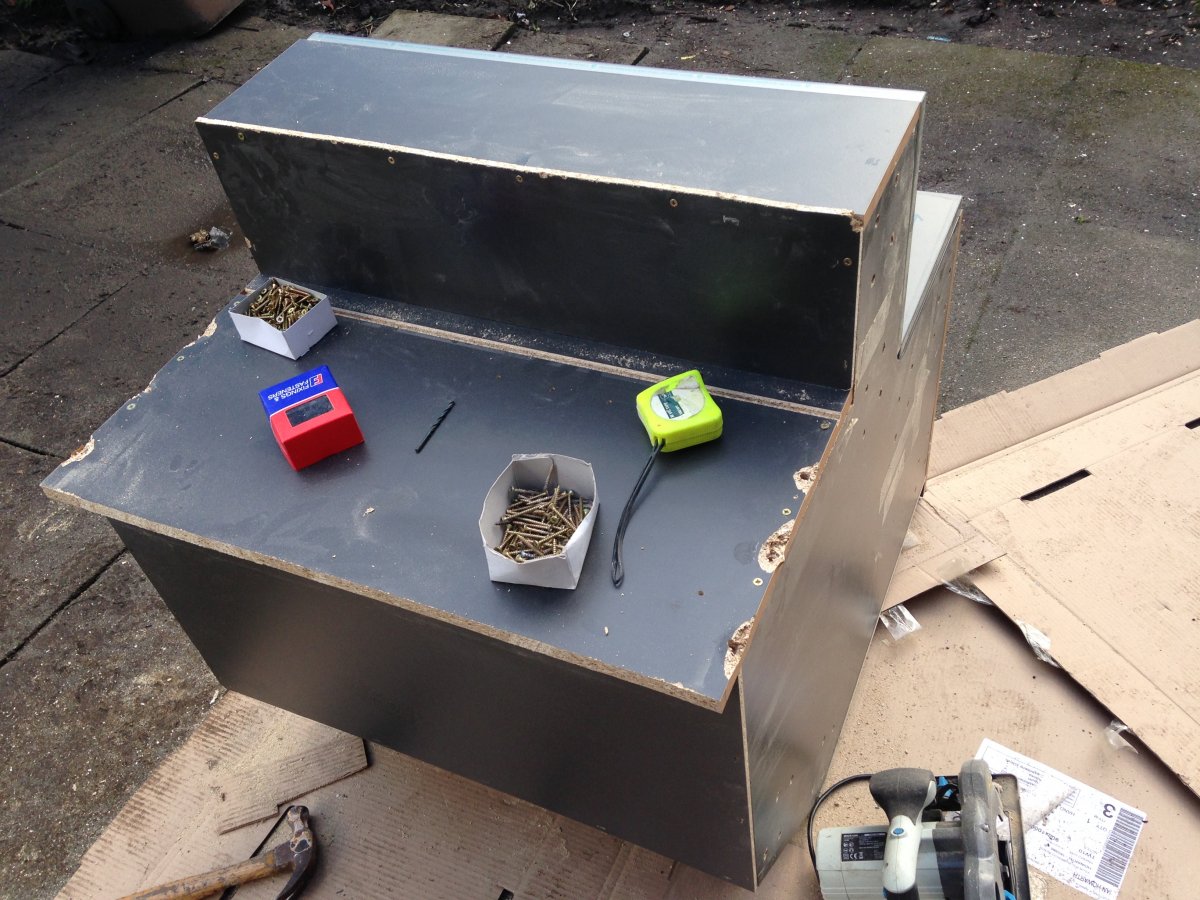

Tomorow I need to cut the back bits off 2 carcasses, because we are having a 900mm worktop over 600 and 300mm units (back to back).
The sticky outy bits are 43mm, would you just cut 33mm off to leave a bit of strength in the unit?
This is the bits:

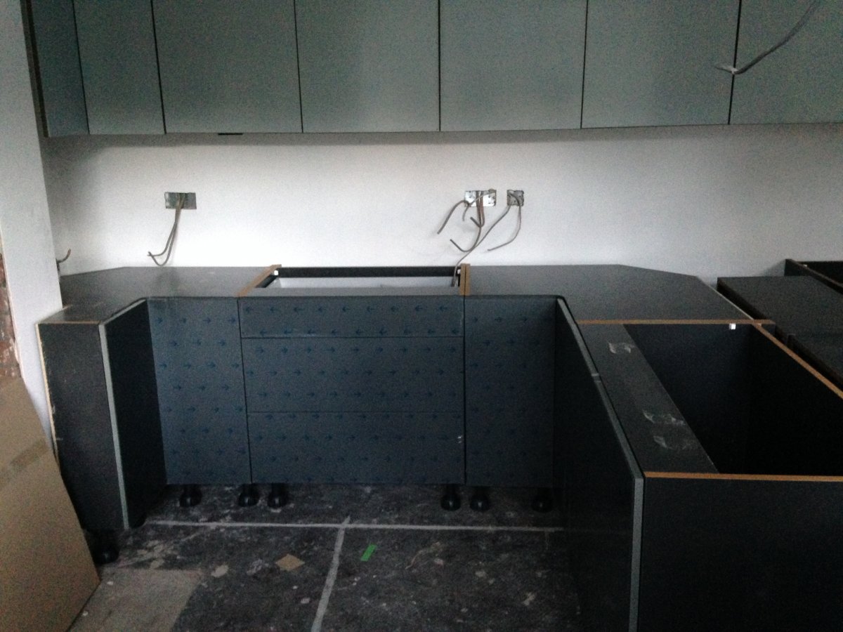

And where we are at so far:
Just cut of what's absolutely necessary, as the backs provide a degree of stability. But you cut bit more than that off, in order to get the right overhang. And well done on the unit, I'm sure it looks good from the inside though.
Yes, it does looks decent in the inside but shows an orange edge. I forgot to take the shelf out, cursed, then realised it needed cutting anyway!!!

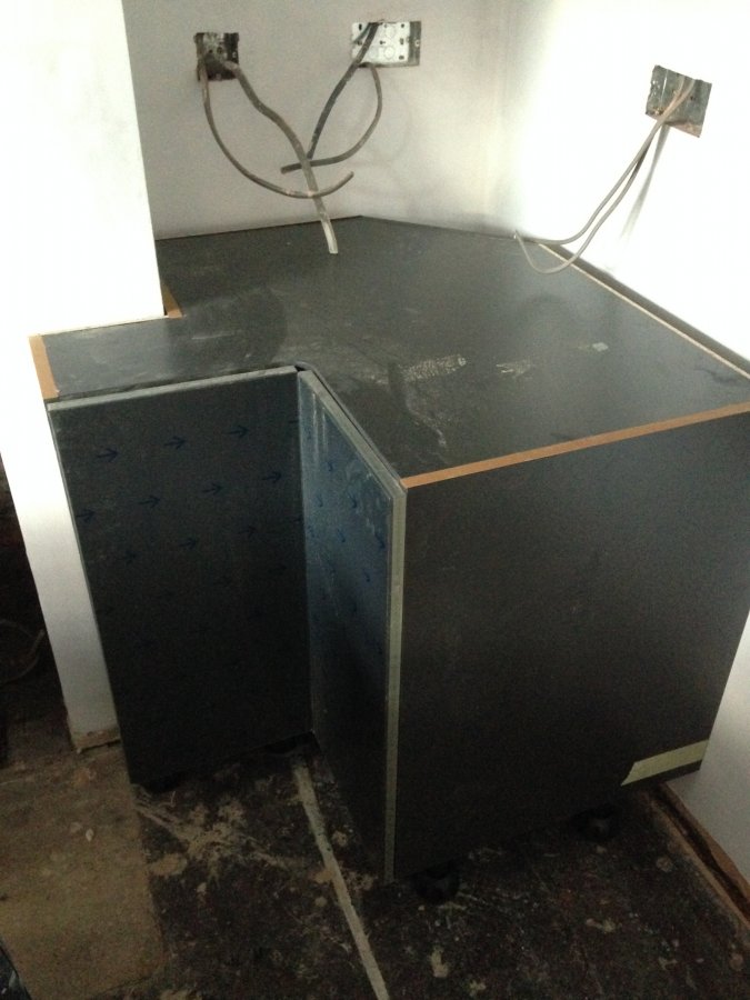

Just looking at the position of some of the pattresses for sockets etc, did you check the cable runs? Some look awfully close to where you'd have to drill for the wall cupboard fixings...
Yes, both of the corner wall units brackets are very close. The wires go up dead centre of the boxes so I should have missed by a bit.
Now you mention it though I might just open the plaster above the unit to to make 100% sure.
