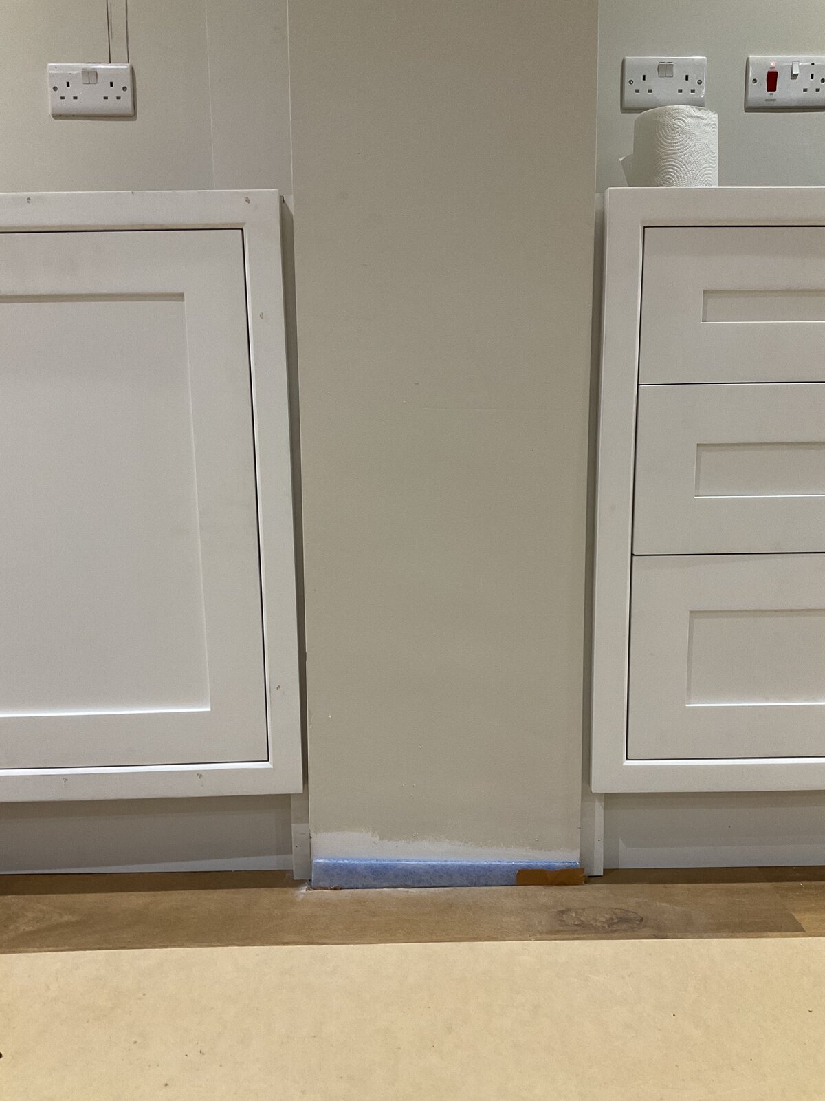

Hi
I’m after some advice please.
we are having a kitchen fitted, all bespoke. While you can see to the right of the old wall the units are level to the wall the left are not.
the difficulty being the units are level so obviously the wall isn’t. Is this something we just need to put up with or can it be made to look better?
many thanks
M and S
Picture attached

You would plan the kitchen so no unit meets tight to a wall and infill panel is used to meet uneven walls.
Though it’s hard to believe the unit on the left is vertical have you checked with spirit level?
Walls are rarely truly plumb, floors are rarely truly level, but something there is very wrong. I'd check the left hand unit front to back and side to side as well as checking the carcass for being plumb, with a 2ft/600mm spirit level, to see what is going on. Whatever is wrong the tops of the cabinets must be absolutely le el to ensure that your courgettes don't roll away or a spill doesn't run into your lap
Thanks both, agreed neither are truly level, how would he go about making the gap uniform along the edge without compromising something further down the line?
For example, the top right angle is 90deg dead on, if the cabinet is shifted to be in line with the wall how can the top be level?

Could you not put a tapered filler piece to fill the gap, attached to the carcass before you screw it to the wall?

Spirit level is showing it's all over the place, the wall is actually pretty good. most of the discrepancy is in the overall top length and bottom length being 6mm different (Shorter on bottom) which looks like is the main issue.
Either way as a bespoke build should I be expecting fillers to be used at all? It would look a lot better with the cabinets both sides of the wall to be flush against it I'd have thought.
Sadly whoever did the boarding wasn't doing bespoke that day. As you now have a wonky wall, you'll have to make the best of bad situation.
You could re-skim from floor to worktop height again, but straight this time, but it's one hell of a faff.
Think a filler will be as good as it gets.
Once they are scribed a cut they will look good, you won't notice them when the kitchen is fitted.

The wall is actually pretty good, it's the frame that's out. Looks like a fun conversation to be had...

He is a professional kitchen fitter, installing a kitchen made to measure for your kitchen.
The techniques and methods used by him to make sure the cupboards are true and the worktops are level and there are no gaps as per the photograph are part of the expertise you are paying for, so make him exercise it.
