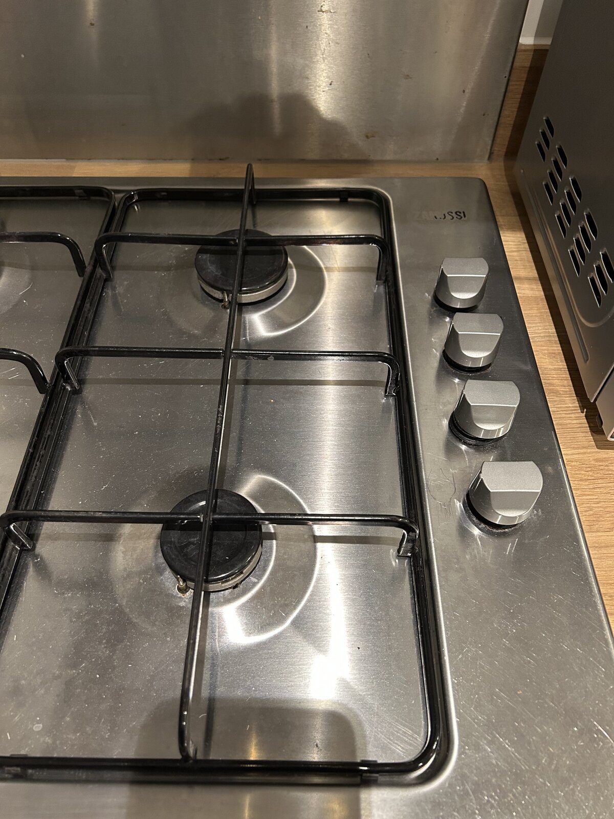

Hello,
I have a kitchen that doesn’t have the stop valve anywhere nearby, quite shocking.
In case of a fire, I should try to extinguish the fire and then take the key, go outside and close the gas there.
This is the scenario where the little buttons on top of the kitchens don’t work.
Normally the fire doesn’t develop inside the pipe, so I should be safe, but you should also know that my pipe runs inside the garage, then on top of the plasterboard till the kitchen, this is also quite shocking.
(along the way there is also the boiler)
I tried to open every available lid, but unless it’s behind the back panel, I didn’t see it.
I don’t think this is under regulations, anyway, one thing at a time, I want to replace this damn gas powered kitchen with an electric one, but I already have 2 ovens and I don’t need other two (it usually includes 2 ovens).
So, as a matter of simplicity, is it not better to buy a portable one?
Though the issue with the gas remains, I should still remove it at some point, and if so, then I can simply install a fixed electrical unit.

Where you turn on the gas at the moment of firing it up, like any gas powered kitchen, maybe “button” wasn’t the right term .
I can't envisage what your set-up looks like, a few photos would help. But what makes you think it's any more risky than any other gas installation? Have you had somebody qualified, to give an opinion?
In attachment you find the famous “buttons”, like any other gas powered kitchen.
For me it’s risky for 2 reasons:
1. There is no shut off valve
2. The pipe comes from the main, then garage, then boiler, then kitchen, all on the ceiling plasterboard, at some point it goes down to the kitchen.
The “last mile” is behind the kitchen and that’s ok, but there is no shut off valve as I would normally expect.

In any gas event where there is a gas escape or uncontrollable 'fire' at a gas outlet then always evacuate the building and turn the gas off @ the meter.
The gas mains pipe connected to the meter should have a valve on it, that is called the Emergency Control Valve (ECV). Usually that would be located in the meter box/location (unless it's marked that there is a remote ECV and where that is) and that is where the household gas should always be shut down in an emergency. The ECV should always have its handle on it and that should never be removed. Can you post a picture of the gas meter and the gas mains pipe leading to it?
Any other valves located near to the appliances would just a service valve and are not designed to be used in an emergency.
