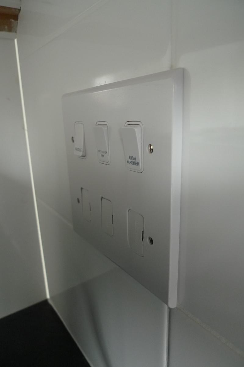

I'm in the process of buying a newbuild house and the builders have unfortunately put in this grid switch in the kitchen:
I want to replace the white switches with chrome or brushed stainless items. However, I'm not sure where I can get one of these, or even what I need to look for.
The switches are for Fridge/Freezer, Dishwasher and Extractor Fan and there looks like 3 fuses below? What do I need?

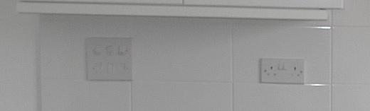

I'm talking about replacing all the communal switches/sockets with something like this:
I'm not sure if that entails swapping the rocker switches or just the faceplates. I thought they came as a unit?
Yes the light switches and sockets will come as one unit (generally)

Screwfix have some grid switch options, maybe have a look there and see if anything matches?

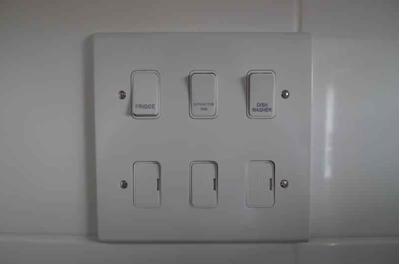

As requested, here are some bigger pics of the grid switch...
There are fuses in the bottom three modules, the spurs below the worktop aren't fused.

Two, possibly three issues:
1) There is a valid point of view that as grid switches are not rated at more than (at best) 20A they are not suitable for use on socket circuits which are > 20A, e.g. a 32A ring.
2) If it's a ring circuit then a bank of grid switched appliances will produce a concentrated load at one point on the ring, which might imbalance it.
3) You say "the spurs below the worktop aren't fused" - do you mean that the appliances have to be hard-wired to flex outlet plates, not plugged into sockets? At best that's an inconvenience. You could argue that cutting the plug off an appliance invalidates the warranty (it doesn't, but you could argue it if you wanted to.)
And it's the wanting which is key. These are all grey areas, and you'll find just as many people who want or are in favour of grid switches like that arguing that it's OK to use them. You would have to really want to be shot of them to start arguing with the builders that the Wiring Regulations have been contravened.
