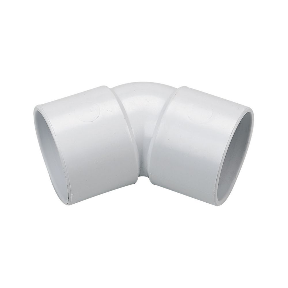

I meant plastic, (found some swept bends by googling as I haven't got the equipment to bend plastic pipe), although not an issue if I go for 40mm solvent weld pipe. Will a standard 90 degree bend be OK?
If you mean this sort...
ae235
Then no. There are 'slightly more swept' versions though...
...so, maybe!
At the wall end though, you're not allowed to chisel out a 40mm chase, unless your inner leaf is 120mm thick. You can only chase out 1 third for a vertical chase. Are you battening out that wall?
3 x 25mm steel conduits is the best solution still, and solves some of the issues, but probably the most expensive.
Indeed - or, alternatively, a couple of these, joined with a very short length of pipe (giving a total of 90° bend)...
ae235
... I've done that in the past, but whether or not it makes it easier to feed cables through, I'm not certain.
