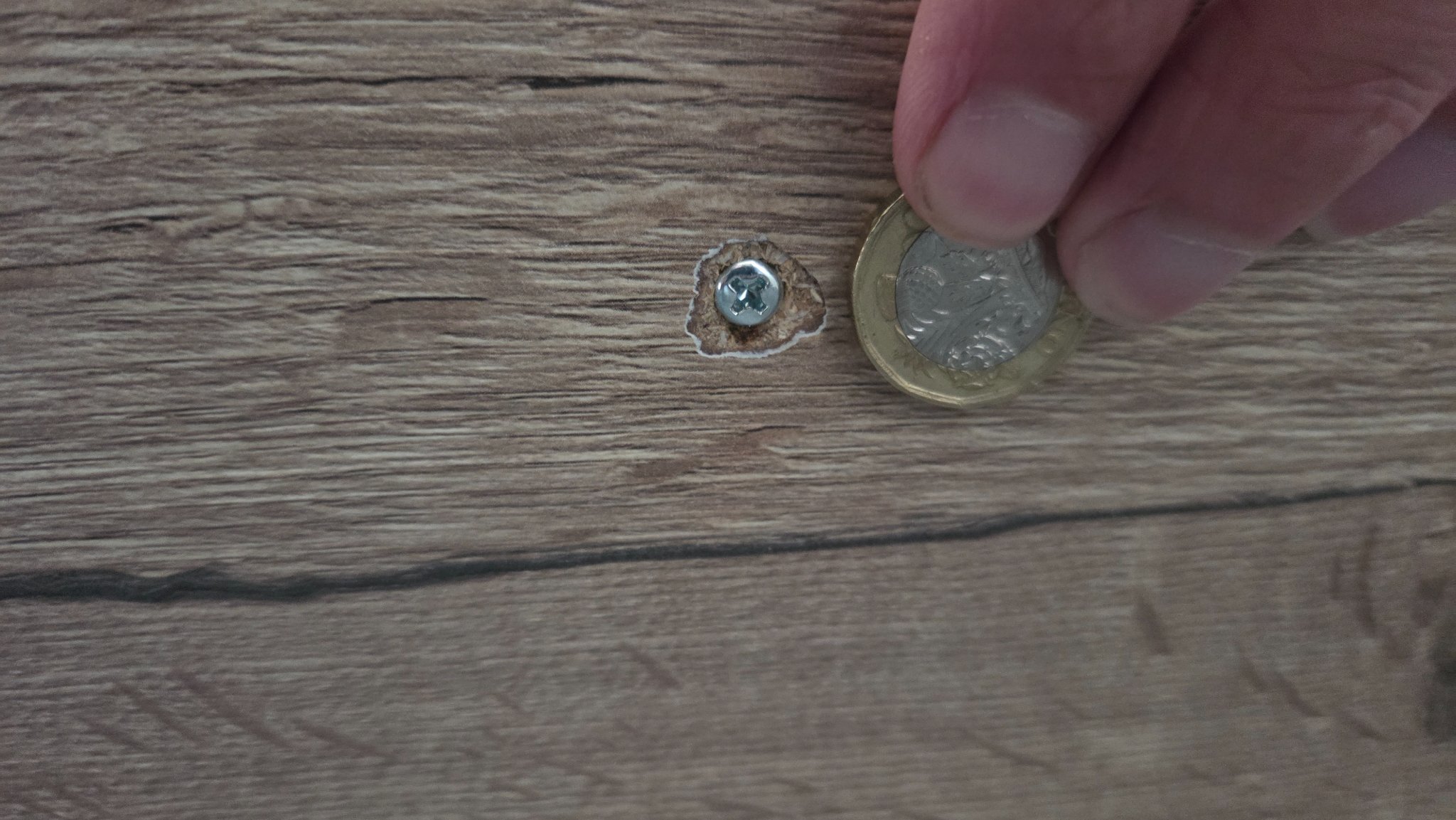

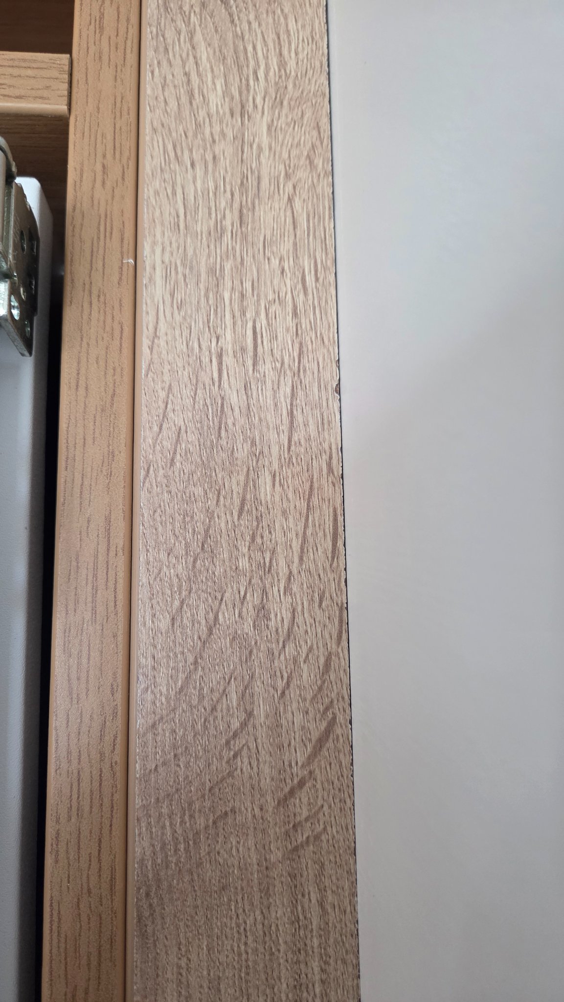

I've recently had a new kitchen installed and I'm pretty disappointed with the fit and finish of a lot of it.

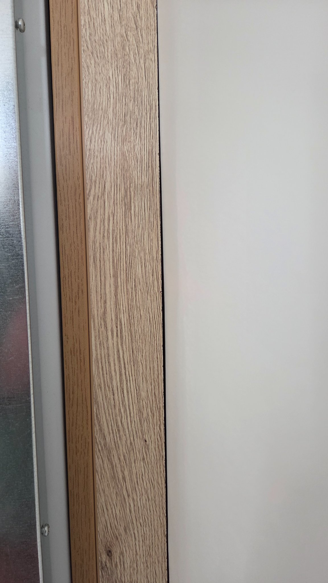

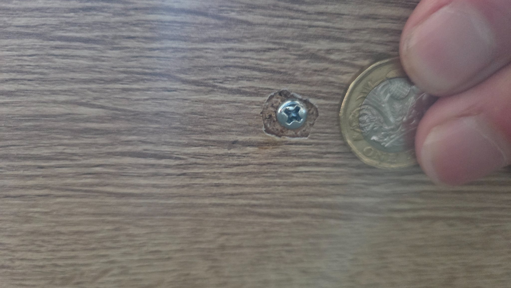

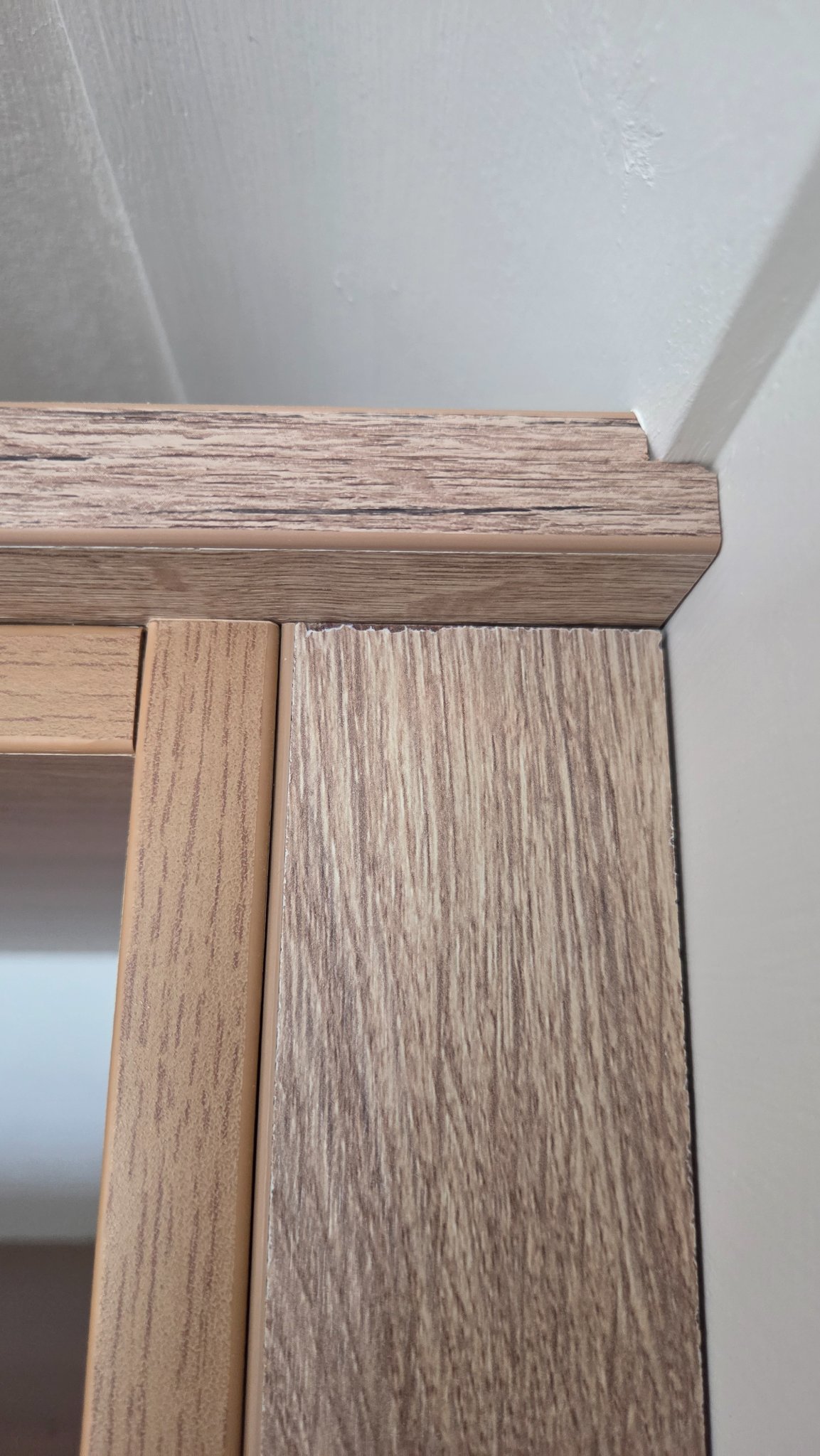

I have no issues with the quality of the kitchen, its the work by my joiner. Some of the cuts are rough, lots of splintering and chipping of the cut edge. He's also popped the laminate when he's tightened the handle screws too tight. The filler pieces are not the best, haven't been scribed very well and the edges are all chipped.
If it was one or 2 things I probably wouldn't care, but it's literally 90% of all units.
Is this "normal" and if not what remedial actions would you recommend pursuing?

There’s no excuse for not having a sharp blade, nor not knowing how to avoid tear out or absolutely minimise the risk. X dining is another essential skill. You might be able to hide or cover some of the splits with judicious use of colour fill or similar. Badly scribed infills should be ripped out and gone again.
Hmmm, I wouldn't accept it as a finish.
I fit Kitchens. Some products are more susceptible to being more brittle than others. A new 48 toothed plunge saw blade and masking tape is my go to. if it still chips then I get my power planer out.
The scribes are substandard, sometimes I cant get them bang on so I use a colour match caulk, yours are lazy scribes, no caulk.
The screw, that's unacceptable.
List all of your concerns, email the fitter and tell him/her you want them resolved at their own expense.

I would have set the scribes back from the front edge , getting them flush never looks right imo .
I prefer them set forward cut to the same height as the door and fitted on the same plain as the door frontals, unless its an open shelved unit then im in your camp.
Who did the electrics & gas?
If not a qualified fitter you might be able to use illegal work as a lever...
I would rather they were flush with the doors, so bring them forward....
I agree but we don't know if the edges of the scribing panels are veneered (that said, iron on veneer is occasionally supplied). Additionally, we don't know if the radius on the door edge matches the scribing panel.
If it does, then all he needs to do is scribe a new panel, pack it out by a couple of mm and glue it to the existing panel.
That said, looking at the cornice, it looks like the scribing panel might have a finished edge.
