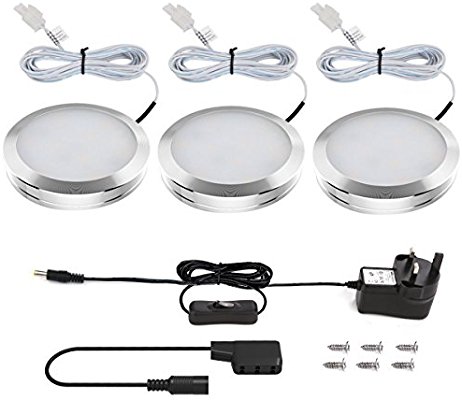

First time installing under unit lights in kitchen and a bit of confusion has arose.
Eventually found ones to buy (harder than I imagined) but these 12v lights come with fused plug. Reason for confusion is I have 1.5mm T and E coiled up coming from 3amp FCU to wire these.
Firstly, are most low voltage cabinet lights wired like this?
Secondly, as I have wired in 1.5mm but now have to wire into socket instead (My initial thought was this would go into a JB) is it acceptable (sockets would be above unit so nothing else would get plugged into it) or any other options advised.

It's a power supply so cannot be cut off - without complicated solutions - so you will have to have a socket.
This could be above the units or somewhere else inconspicuous.
I am sure you can buy the bits required to light under the counter, question one has to be if already wired for low voltage, why buy extra low voltage lights?
Lights sold as a kit are made for easy installation, lights sold as independent lamp, switch and cable are designed for hard wiring.
The GX53 lamp is around 5" designed to be hard wired and lamp is renewable, runs on 230 volt. If you buy something not suitable then it takes more time to convert it.

Primarily I was thinking of safety, although I know I am just being overcautious more than anything. I was told 240v lamps could also get hotter, even though it's a LED light? The one I have seen is this one -
https://www.downlights.co.uk/under-cupboard-led-lights.html
Indeed. As I said/implied, you're fairly unlikely to ever come into contact with the lights, yet every day handle plenty of 230V items in the kitchen. However, I would never knock 'caution'!
Well, if we're talking about LEDs, if you have 12V ones, then at least some of the heat will be generated in the (separate) transformer/power supply, whereas with 230V ones it will necessarily all be generated within the LED lamp/bulb.
