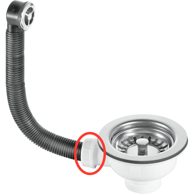

Hi,
I have bought a new kitchen overflow and want to connect it to the waste. Plastic flexihose is inserted into the compression with rubber washer and all tightened up. But no matter what I do, it leaks at that joint when water goes down the plughole from washing up etc.
The flexihose is new, so no kinks or damage. But I think the corrugated nature of it doesn't allow a watertight seal with the washer.
Any suggestions? Attaching an image, this isn't the one I have but exactly the same principle. Leaking from the compression nut in the red circle.
Thanks in advance...

Iirc the conical washer fits one way, make sure of this 1st.
