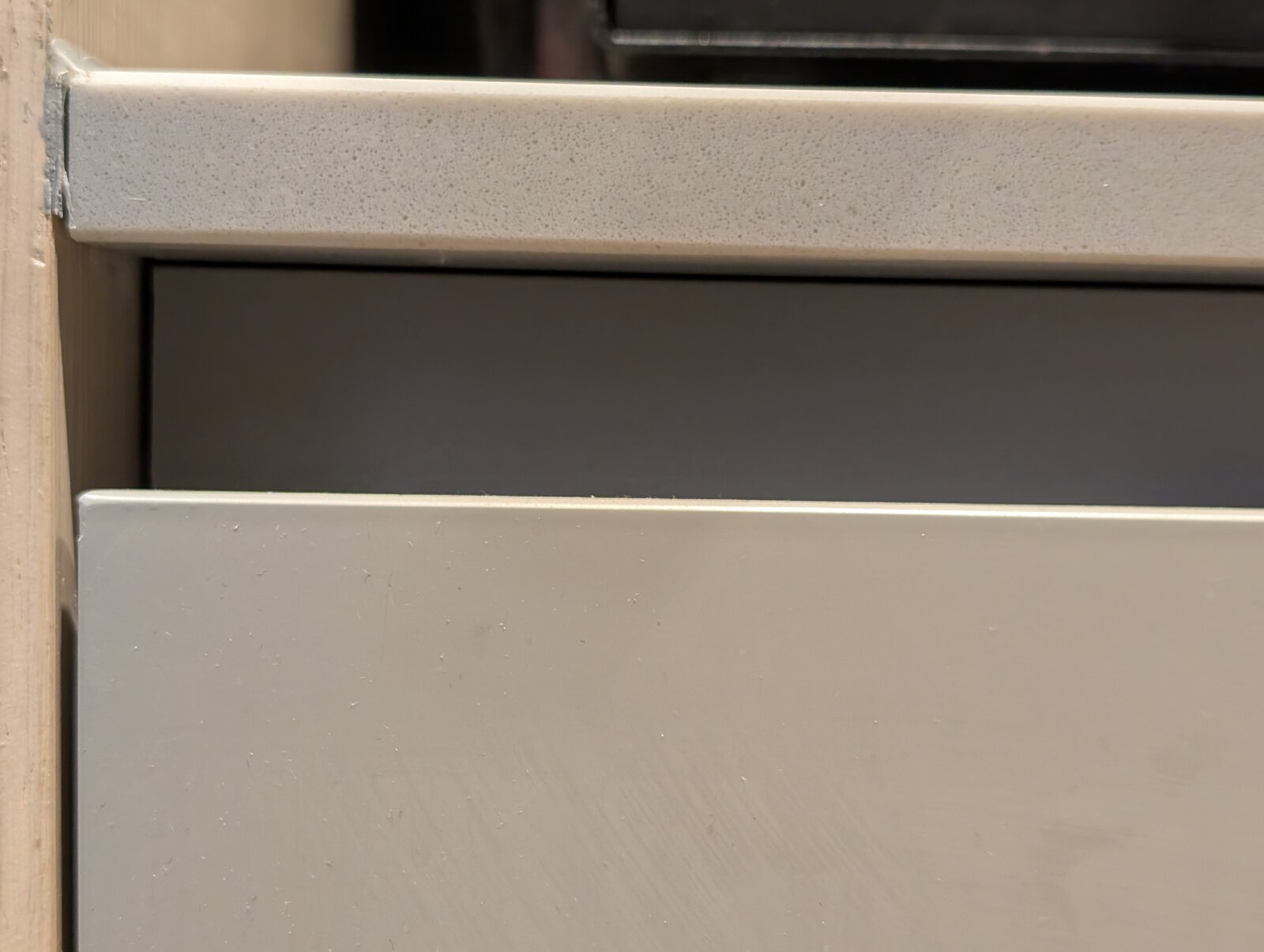

So I got a kitchen worktop made of Dupont Quartz 2cm.thick and am looking at purchasing coffee machine however it weighs around 31kg.
Attached picture of the area where it would sit and thre is slight gap between stone and top of unit. I can fit credit card into gap but can't further along the worktop.
Would this be risky putting that much weight on it?
I think you would find the work top is sitting on the side panels of the units rather than the fronts or backs, so it will be well supported and take the wieght of any coffee machine.
So the slightest gap on left side where it meets the wood is fine?
If you are referring to the gap in your pic then yes it's fine. If you have any doubts get in the cupboards and view across the worktops from underneath and you will see where they touch the units.
