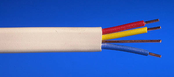

Had a look at the switch wiring. As I've said, there are two redundant switches in the middle of the kitchen/diner, and one switch at the entrance to the kitchen, and one at the entrance to the dining room.
The two redundant switches have a single cable going to each of them, 4 core.
The swithes at the entrances to the kitchen and dining room both have 2 cables going to them, a 3 core and a 4 core.
The switches, both one gang, 2 way, are wired as follows: -
Terminal at the top, marked 2 way, has the RED wire from the 4 core cable.
Terminal at the bottom has a YELLOW wire from the 4 core cable, and the RED from the 3 core cable.
Other terminal at the bottom has the BLUE from the 4 core cable, and the BLACK from the 3 core cable. I have left out the earth wiring at this stage for simplicity.
im guessing that by three core you mean twin and earth
and by 4 core you mean 3 and earth
with your setup if you just connect together the two cables currently going to the redundent switches (using a 4 terminal junction box or similar) the lights should work fine.
