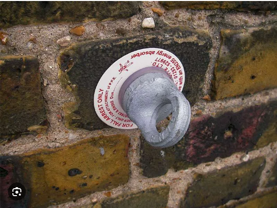

Many thanks. I know the other poster earlier said to put them 1-2m off the ground, but surely the higher up towards the roofline they are, the better? Or is there some reason to set them lower?
I like ladders to be firm, at both top and bottom. 1-2m is a compromise, meaning you can drill and attach the fixings without being at risk on the ladder drilling. At the top, I would still want the ladder lashed in place.
