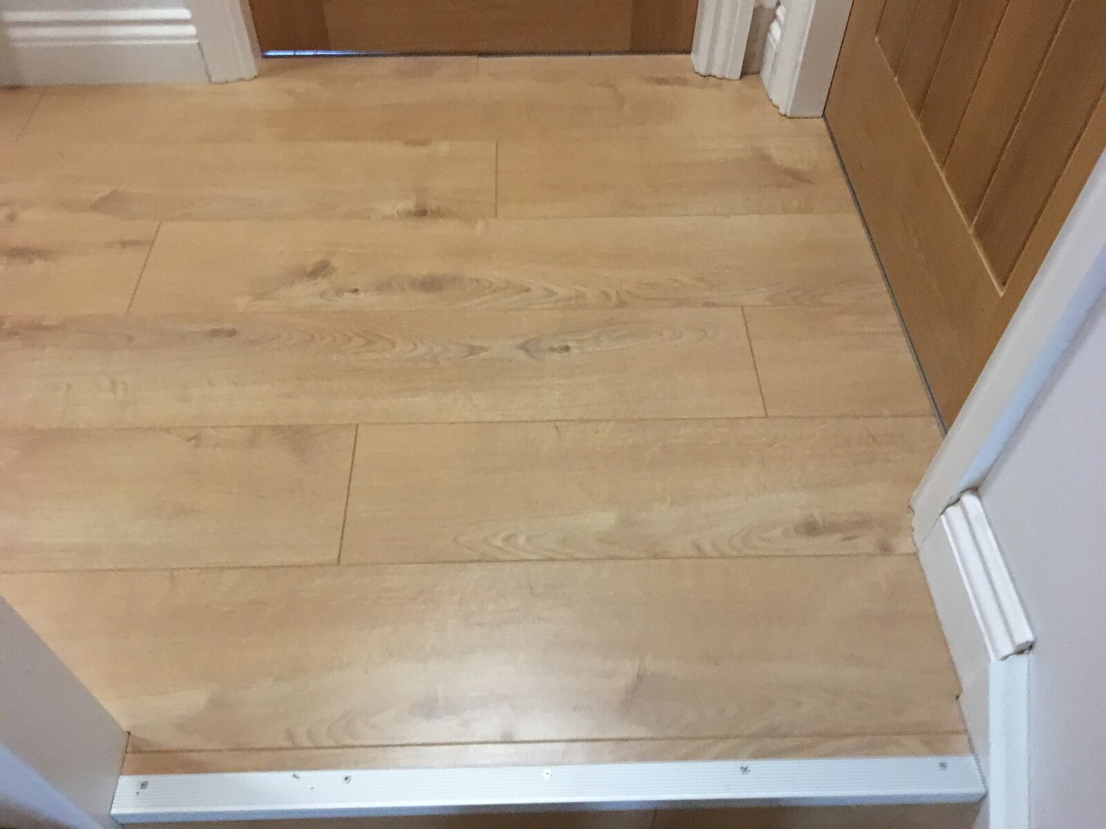

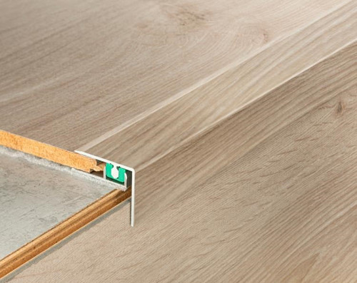

Daughter has cats and wants to replace her hall, stairs and landing carpet. Hall will be vinyl plank to match the lounge but the stair…. she has looked at oak overlays and they are out of budget but have found these which say you can use standard laminate
has anyone any experience of using them?

No experience of laminate on stairs but very smooth, almost slippery tread surface doesn't sound like a good idea to me.

Completely agree about a laminate on the stairs though, not a good idea.

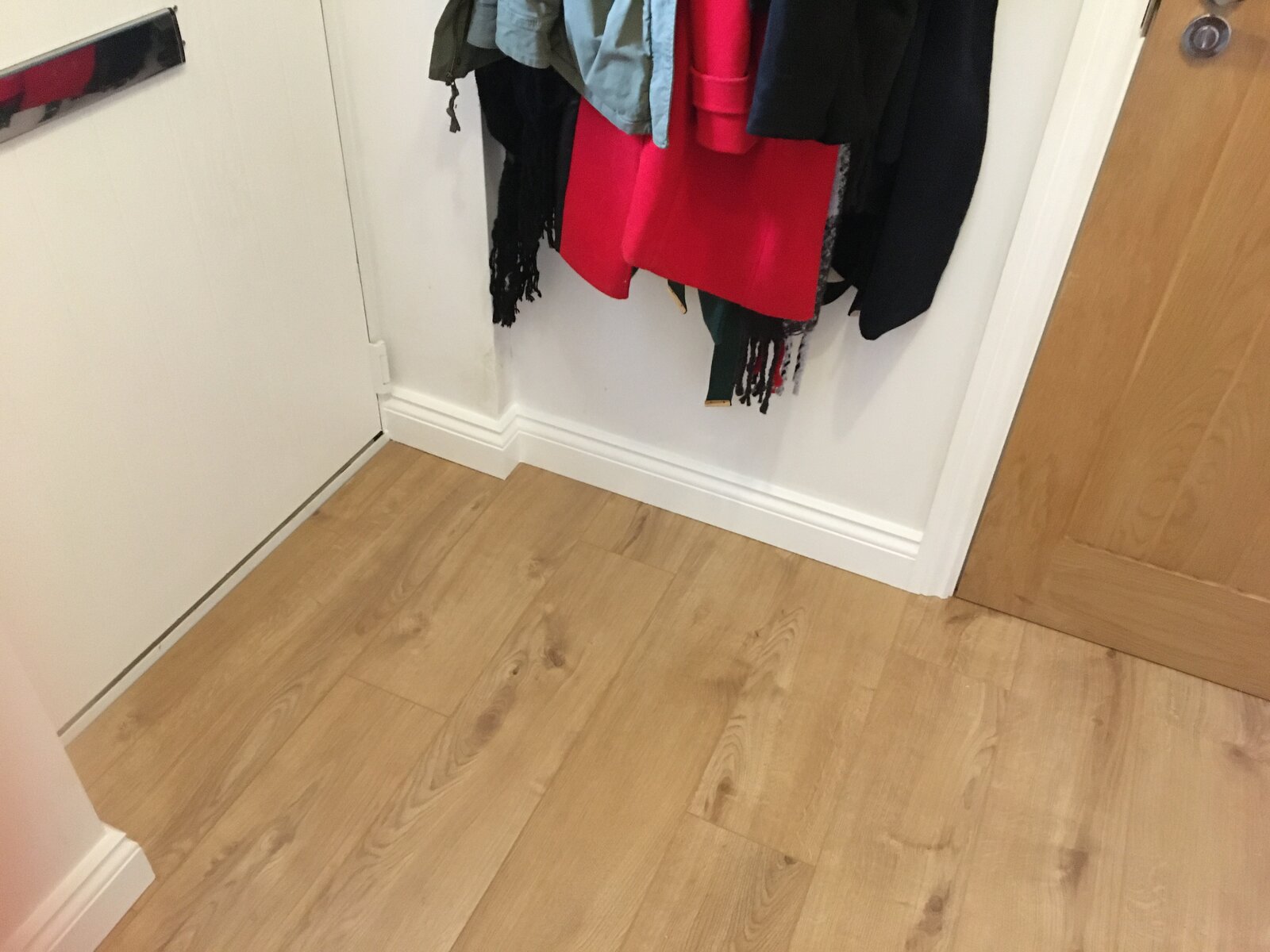

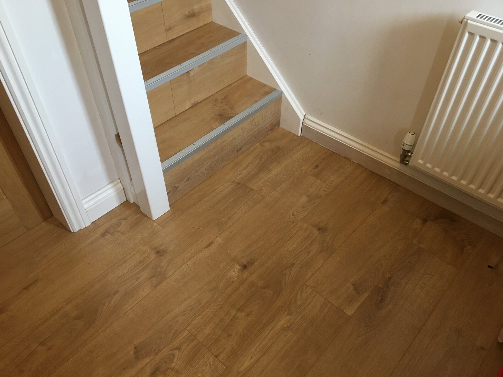

After several months, a house move (ours not hers) and a number of other events it is done apart from a strip of sealant inside the front door. MDF screwed to risers to avoid removing the tread radius and laminate glued down with Screwfix best grab adhesive. Aluminium strips came from B&Q.
Main delay was moving 100 miles so it was a little harder getting over to work on it but about 5 days to do,
She is happy.
