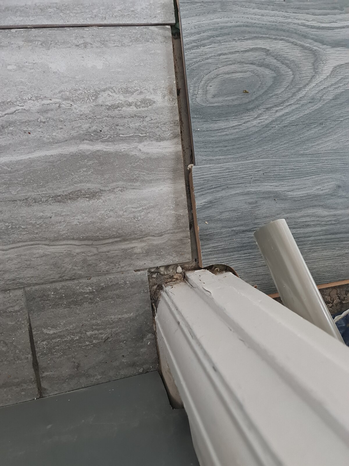

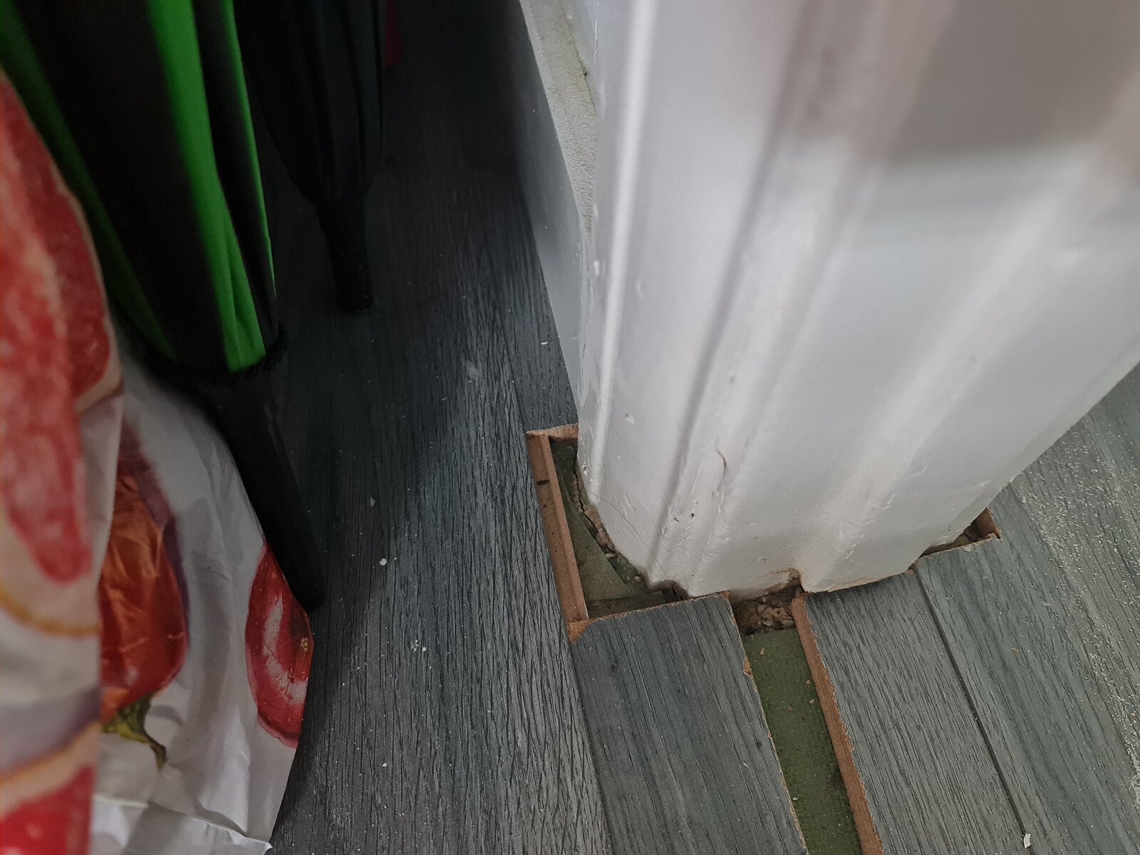

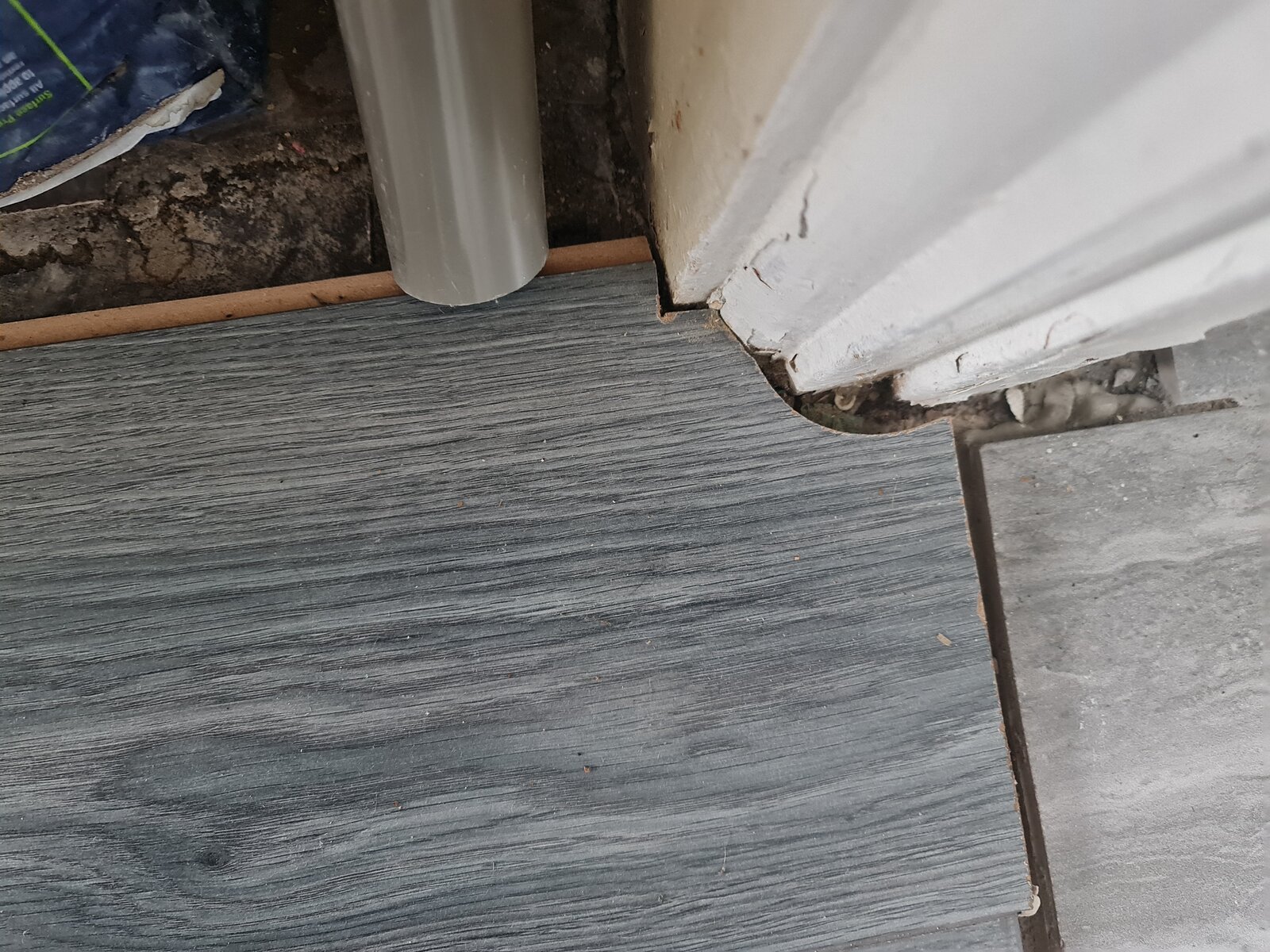

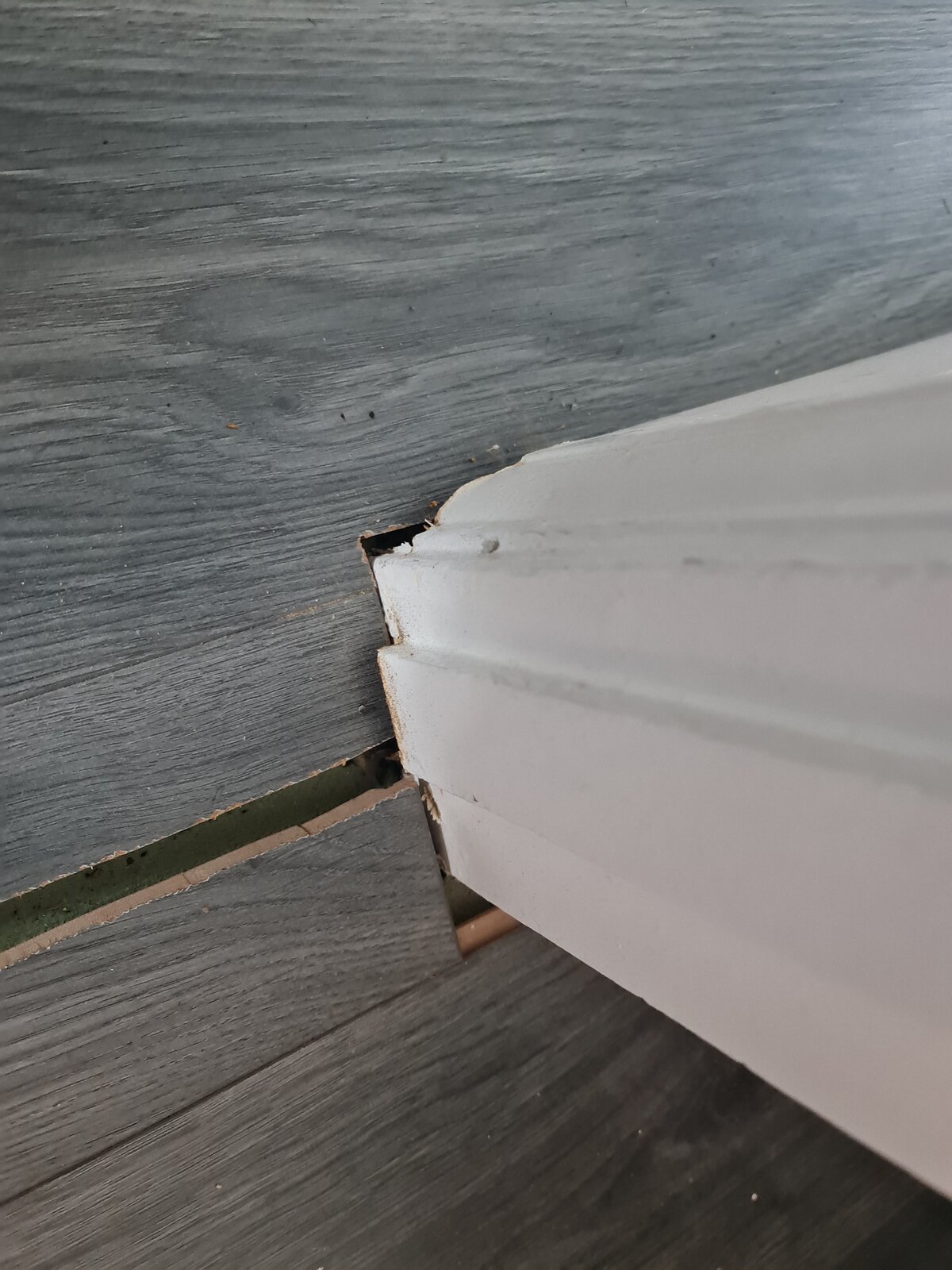

Hello,
I hired a builder for refurb on rented property. He's laid the laminated flooring and has done a cowboy job leaving exposed areas around door frames and shortages around the skirting. I know I can use beading to hide around the skirting straights but how do i fill these exposed areas. The builder has taken my money and is not returning back.
Any suggestions on how to rectify and make it look decent for tenants will be appreciated.

The proper way is to remove skirtings and refit on top, plus undercut door frames - so laminate edge is hidden, but still with a gap for movement.
To avoid doing the above, you can a fibre quadrant moulding strip, which pins to the skirting, to hide the gap, but not so easy to use around door frames if at all. Problem with the fibre quadrant which is sold for the job - is that it is expensive, and the with any moisture it swells up and looks terrible. Better is a plastic quadrant strip designed for double glazing trim, which is available in brown or white and is stupid cheap, from Eurocell.

You cannot use filler, laminate needs to have an expansion gap around it, to allow some movement. Filler will set solid.
Undercutting is not always possible in which case colour matched caulk can be used .

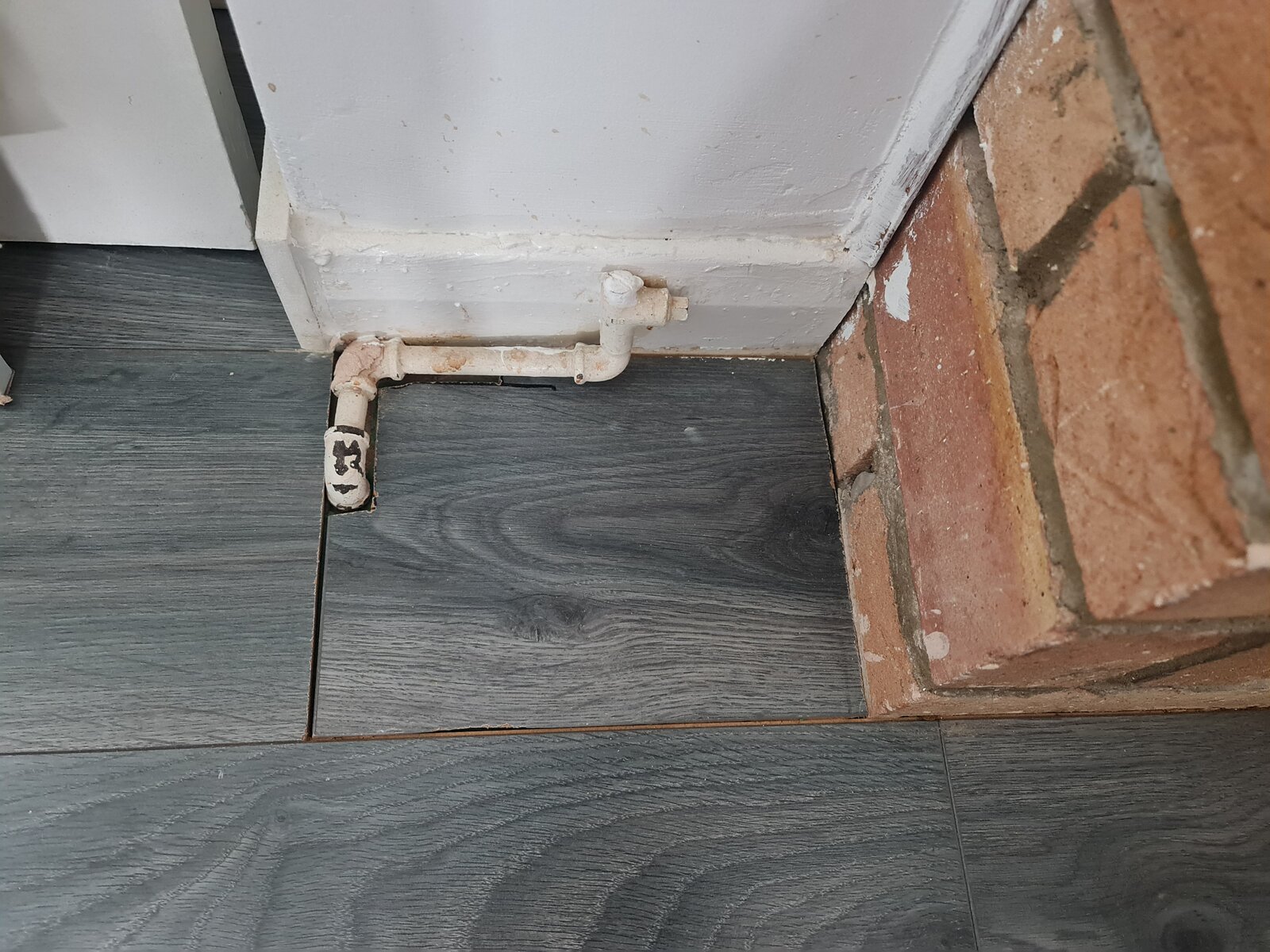

This is not a cowboy this is insane I will be crying I had 2mm gap under cupboard
once in customer house still can't forget how did I do this

Bottom line I've been taken for a mug, he done me over good and proper and now nowhere to be seen.....just trying to find a way to rectify his crap and make it half decent for my tenants.
