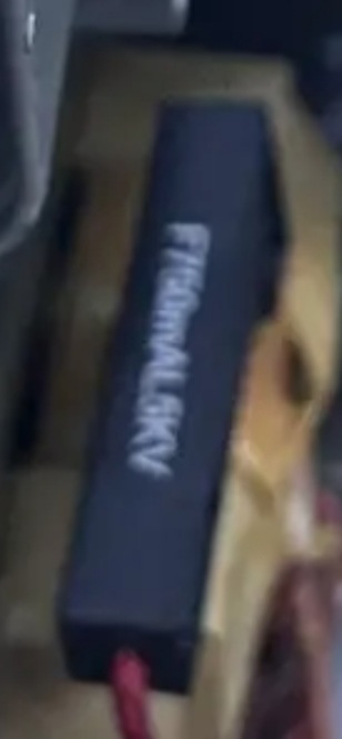

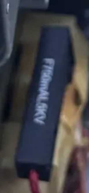

I have a Lamona microwave and yesterday the fuse blew off when it was running. I could hear the sound and smell the smoke. I opened the microwave but I am unable to figure out where is the fuse. Attached is the picture. Any help would be greatly appreciated. Thanks

If you have a model number, you could search here for spare PCBs that should show you the position of any fuses...
There is a high-tension fuse in an in-line fuse holder in your pic:
However, a fuse blowing is indicative of further issues. If the microwave is old, or cheap, it may already be beyond economic repair.
Thanks @RandomGrinch and @SFK for valuable advice. The microwave has been in use for almost 9 years ( based on when the previous owner did the kitchen). So it is probably time for a new one. Much appreciated.
