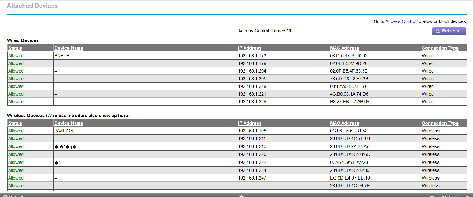

Below is what my main router shows, but it has my Pavillion laptop wrong, it's not 241, it should now show 195. It doesn't differentiate between wired and wifi, for things connected via my second router, under Ethernet, but the pasted image below that does.
MAIN..
SECOND..
Weirdly, my main router is continuing to report the IP of my laptop as 241 (exactly as is the upper screen grab), rather than it's new actual IP of 195, and despite refreshing the main router's web page some hours later. I wonder if that might have some relevance?
You seem to have 3 devices using 192.18.1.221
What happens if you tell your laptop to use 192.168.1.241
From memory, a domestic router can deal with 32 wifi clients at any given time.
Not that I could see, but it has somehow allocated 211 twice, to similar devices. 221 is my IP cam. Don't forget, they are the listings from two separate routers, so some device IP's will appear in both lists.
It was allocated 241, at the beginning of all this going wrong. It seems quite happy, on 195 since yesterday, though only able to get a full connection to my nearest/second router. My main router, is still mistakenly reporting my Pavilion laptop, as being on 241.

Double allocation shouldn't normally occur with DHCP allocation as the client (and sometimes the server) will check if the address is in use.

Whilst the information on the router may be useful I'd not rely on it, I'd look at the clients and check which DHCP server it thinks it's fetched an address from (ipconfig /all on windows will show this) as it still sounds like there are multiple DHCP servers to me, if the address ranges are the same but the gateway address differs it would produce symptoms similar to what you're seeing, you should also be able to see if the gateway differs from ipconfig /all.
Simplify the test scenario, test using a wired connection to each router whilst disconnecting the second router from the first, the laptop should be able to fetch an address whilst connected to the first router but if the only DHCP server present is on the first you shouldn't be able to fetch an address via DHCP at all on the second.

Sorry, my bad. In image 1 there were indeed only two on 211.
I don't understand how two devices with different MAC addresses can be assigned the same IP address.
DHCP leases are an allocation of an address for a certain amount of time, standards compliant DHCP servers won't allocate an address it's already assigned a lease for but if it's a device where it doesn't have persistent internal storage and it's powered off it's possible.
If you have multiple DHCP servers serving overlapping or the same address pool you could possibly get double allocation, there are normally mitigations in place for the server and client to check if an address is in use on the same physical network at the time it's allocated, if you have laptops or devices in some kind of sleep mode or they only connect intermittently this can stymy it.
I think that was probably a peculiarity of the Plusnet main router telling lies.
