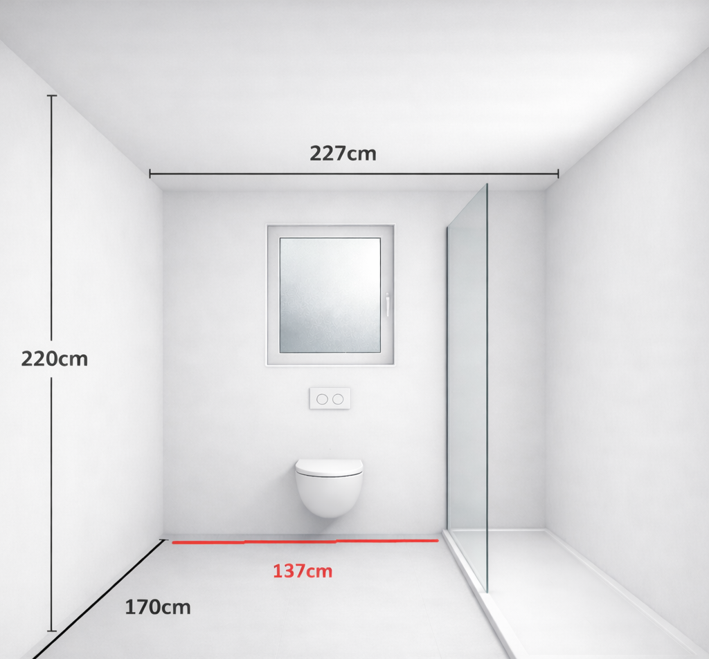

I’m planning to tile my bathroom next week and would like some advice on the best tile layout, mainly to avoid awkward-looking grout lines.
The bathroom is quite small, and I’ll be using large 120 × 60 cm porcelain tiles. I’ve made a simple mock-up of the room layout which is attached below (the view is from standing in the doorway).
When you walk in, the wall directly in front is about 227 cm wide and 230 cm high. On the right side of the room there’s a shower tray, which leaves about 137 cm of usable width from the edge of the tray to the left wall. The remaining floor space is roughly 137 cm wide (left to right) and 170 cm deep (front to back). There’s also a window recess on the back wall.
I’m planning to lay the wall tiles in a landscape orientation (120 cm wide, 60 cm high). Since two full tiles are wider than the wall, I’m trying to decide where the vertical joint should fall. One idea was to centre a joint on the toilet flush plate and trim the tiles on both sides, but I’m worried this might look odd with a grout line running through the middle of the toilet area. The other option, which seems better, is to centre a full 120 cm tile on the wall, leaving equal cuts on both sides. This would avoid having the toilet and flush plate sit on a joint.
I’m also planning to use the same tiles on the floor. If I go with the centred wall layout, I’m unsure how best to lay the floor tiles to suit it. My current thinking is to run the 120 cm length left to right and the 60 cm length front to back. Should the floor layout also be centred front to back, while keeping the same joint alignment left to right? And how much of a cut tile should ideally be at the doorway versus at the back wall near the toilet and window?
Hopefully that makes sense. Any advice from experienced tilers on how to achieve the most visually pleasing layout would be really appreciated.
Without knowing how far the centre of the toilet flush differs from the true centre of the wall, it’s hard to say. I’d probably go the join down the centre of the flush.

i'll get that measurement when I get home later this evening. do you want the true centre from wall to wall ignoring the shower tray? or true centre from shower tray edge to wall?
Ignore the shower tray, that’s irrelevant- the wall is the wall
P.s. I presume the centre of the widow ties in with toilet/ flush centres?
Yes the flush plate is centred to the window recess opening. But the window recess is not centred from wall to wall. from left wall to left edge of window is about 70cm and from right wall to right window edge is about 87cm approx

The colour of the tiles is beige. If I go with a joint down the centre of the flush plate that would mean 1 vertical joint line down the centre of the room. Whereas if I place one full piece in true centre position and then cut two equal ends for both sides that will mean 2 vertical joint lines
I would place 1 full centre -But I would also want as minimum grout lines in the shower as possible so if that means the grout line is still outside the shower wall on the loo wall then ok.
Ok so I measured this. To the exact centre of the flush plate, toilet pan and window: from left wall to center equals 100cm and from right to centre is 118cm I made mistake of measuring total width as 227 it’s actually 218

My shower tray runs along the entire right-hand wall of the room. On both the right and left walls, the tile layout works out to one full 120cm tile plus about 54cm of another tile.
I’ll also have a shower screen that comes out roughly 100cm.
Aesthetically, I’m unsure whether I should leave it as one full tile with a smaller 54cm cut tile near the entrance, or cut both tiles so the layout is more balanced (roughly half-and-half on each side).
Just looking for opinions on what would look best.
