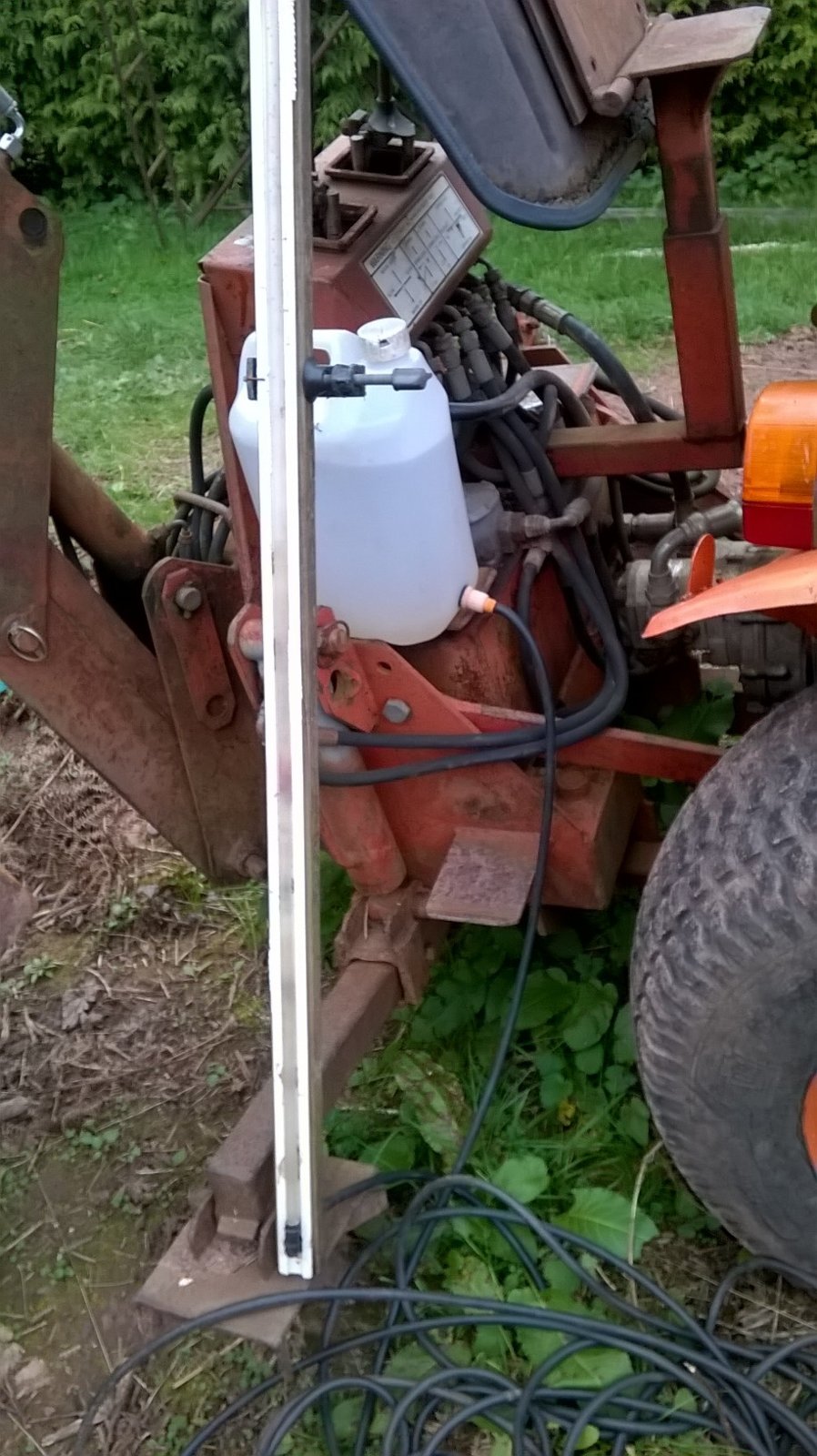

This pic was taken in 2015 of a single handed water level I made about 25 years ago . I have since replaced the 5 litre container with a pump up sprayer which gets rid of air bubbles quickly . My Son borrowed it to lay drains and do the foundations on a barn conversion a couple of years ago and ive not seen it since...good job ive got the laser:)

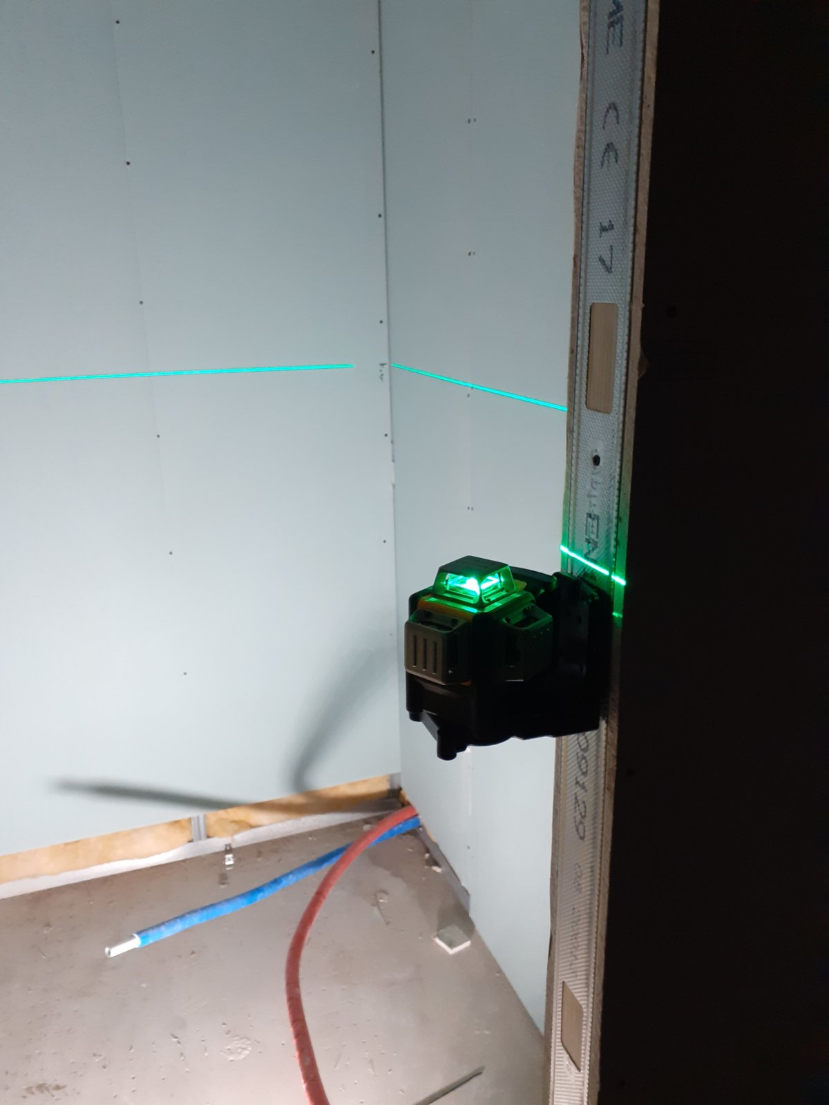

It's a red line laser and they don't work well in bright light situations. Much better in subdued light situations. Bright lights always overwhelm laser lines TBH. See pic below to see the levels of lighting we work in for optimal results (that's a 3 axis green laser)

Yes. Never come across a trade rated laser that does less than 40 metres. I was working near our dry liners this afternoon. They were using the green version of the laser you mentioned. Easily projected from one side of an apartment space to the other (about 20 metres) with no issues. Red version projects same distance as the green, the only caveat being that you may need subdued light to see the line on the red one - shouldn't be a problem at this time of year, it's high summer when you can have issues
