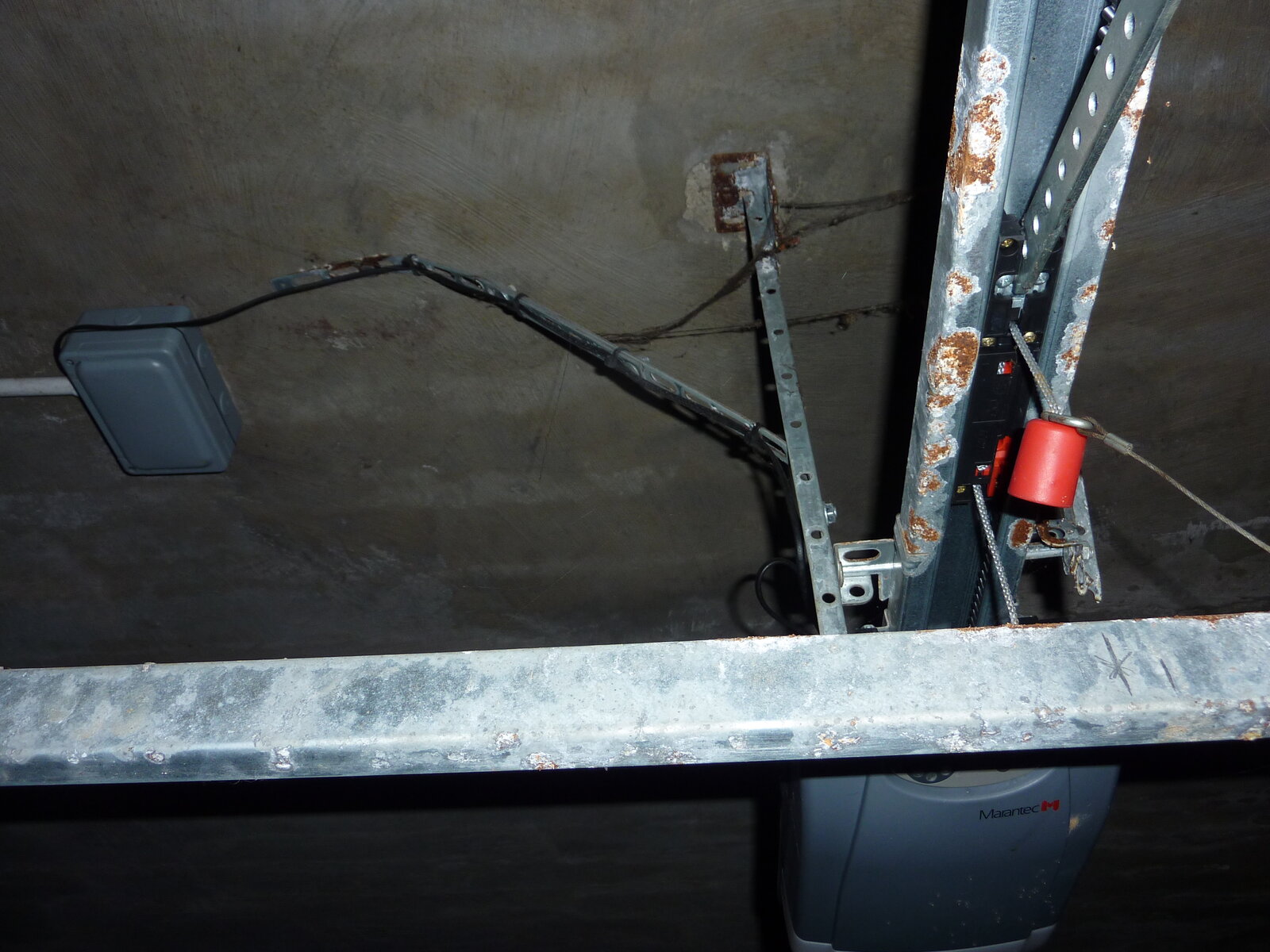

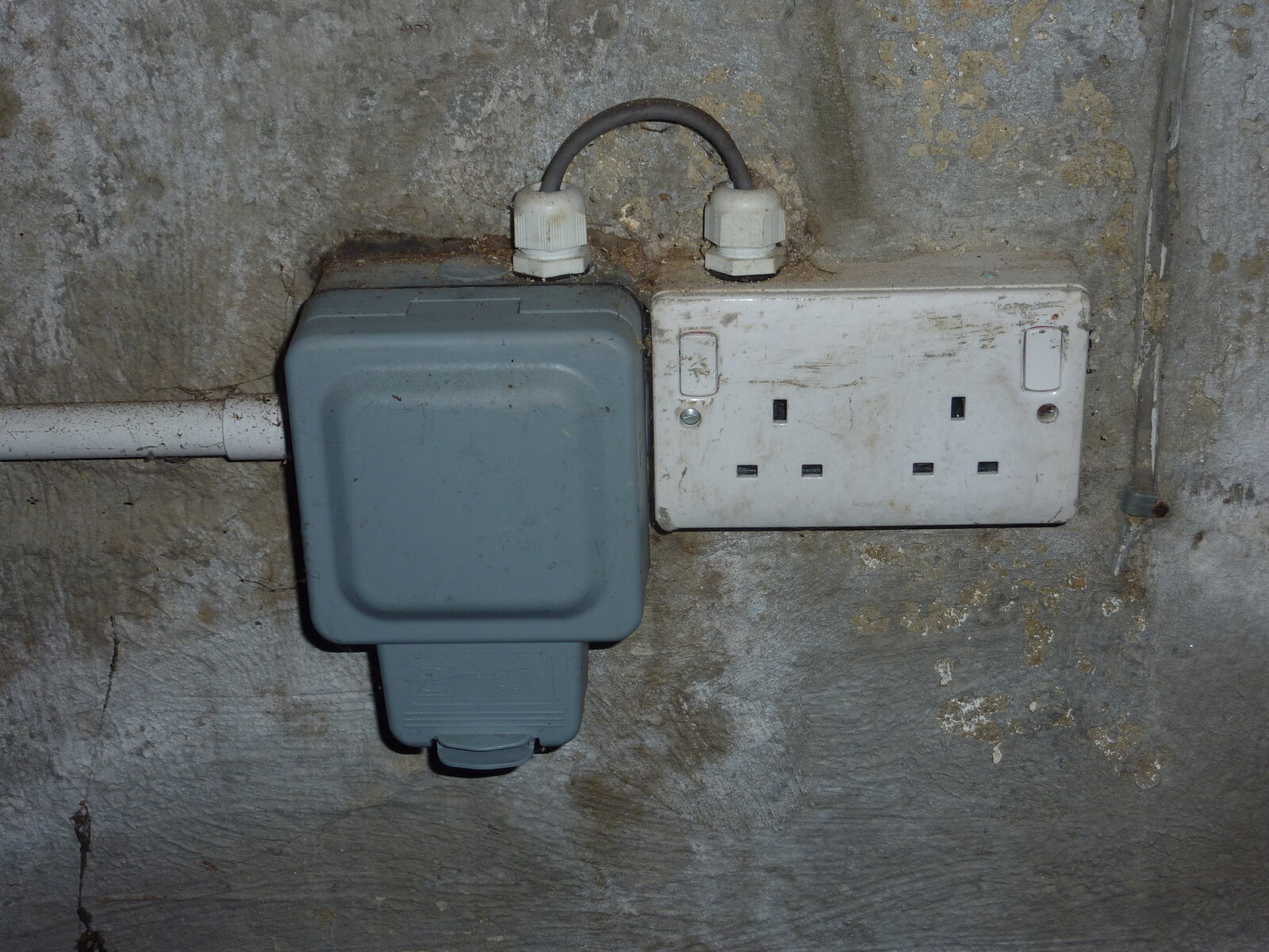

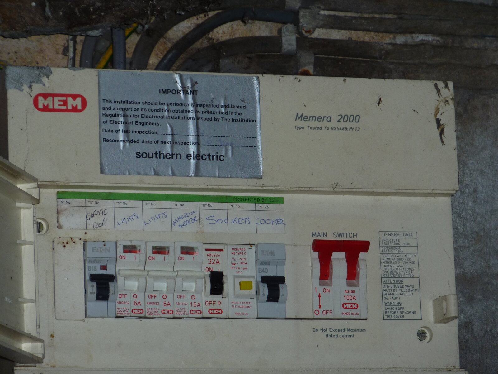

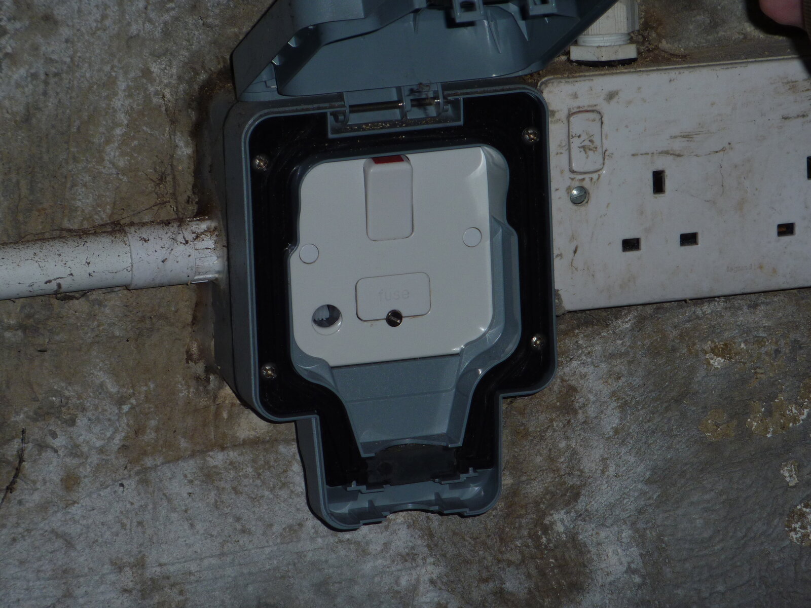

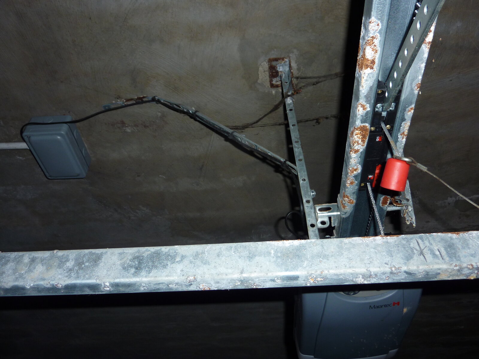

P1060164.JPG P1060164.JPG P1060159.JPG P1060161.JPG Hi guys,
its helpful discussion, RFLighting has got it correct, the garage door controller is plugged into the weatherproof RCD box on the roof with a female two pin lead. When I've worked out how I'll post pictures. - 4 thumbnails added I think!
Just to remind people, I don't mind the door opener tripping out, but as it never trips out after resetting until another interruption of the supply to the property, I would prefer not to have to:
1 manually open the garage door (ladder or steps needed)
2 reset a ceiling mounted RCD on the garage roof (ladder & steps needed)
oldbutnotdead - I understand your logic but if the rcd was in the consumer unit & it tripped I would still have to action 1 & 2 above (as the CU is also in the garage) ?
I see more thoughts have been added, I'll look over them when I've checked these thumbnails are available for you all to see.
these comments are all helpful - keep em coming thank you - effsweet

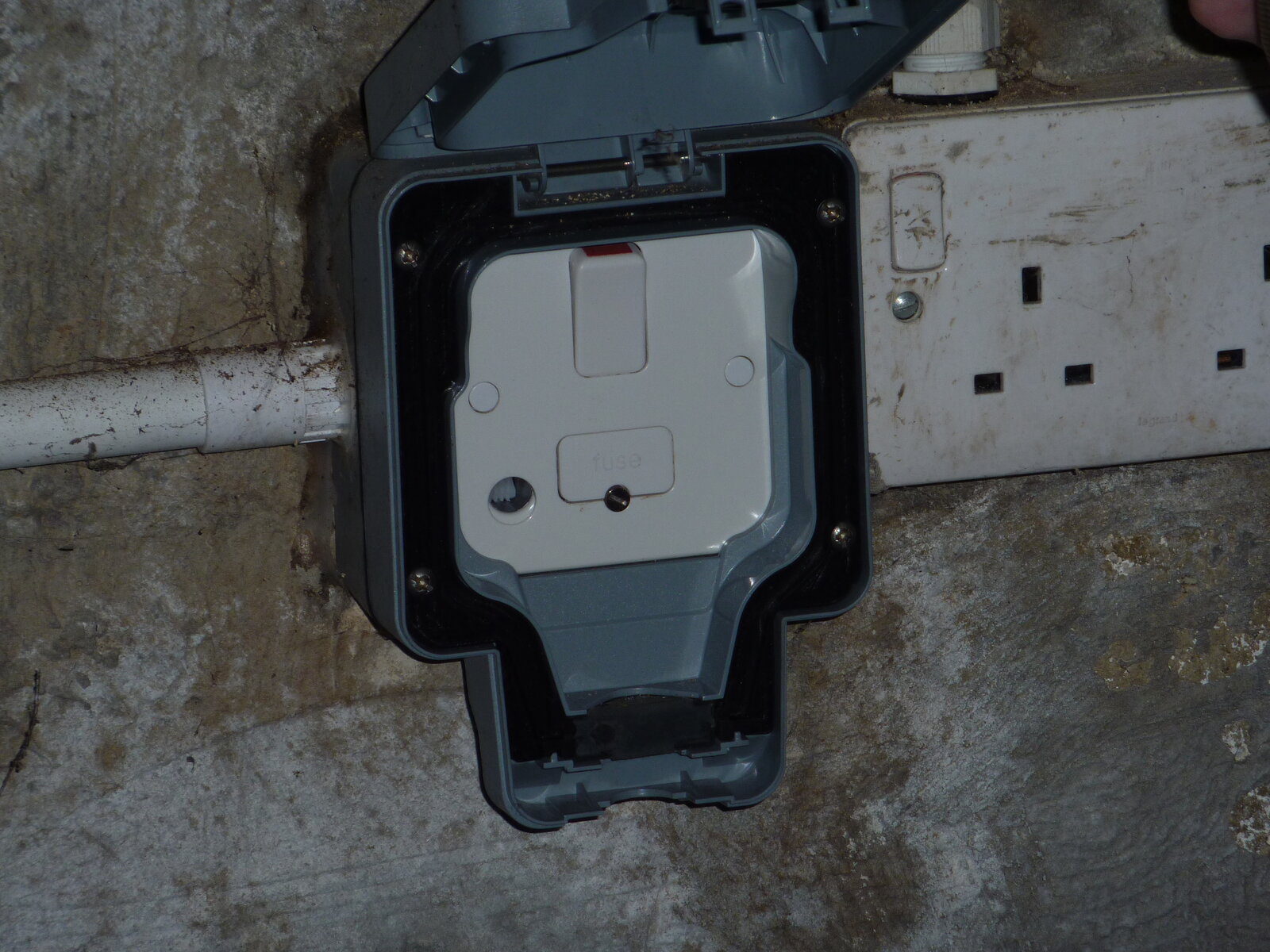

Lovely pictures thanks. I'm a little surprised to see type 2 and type C devices in a domestic installation, it makes me wonder if this is/was a commercial property.
Strictly speaking the reason the door opener requires RCD protection is that its socket was provided, other than that none of its specific installation is buried in the walls and RCD not required. However I see how damp the environment is and would advocate RCD just for that reason and additionally I'd prefer to see the double socket on the wall also RCD protected.
The easiest solution would be to replace the MCB with an RCBO and the ceiling mounted RCD socket with a socket. I suspect the cheapest option will be to swap the 2 sockets over and replace the FCU with a passive [latching] RCD FCU.
Indeed. In terms of current regulations the requirement for RCD protection applies at least as much (see **) to the socket on the wall but, since 'regulations are not retrospective', they were only obliged to provide RCD protection for the 'new' socket (on the ceiling).
[** I imagine that, in terms of an EICR, some would say that the absence of RCD protection for the wall sockets would be a "C2" {"requiring urgent remedial action") because a socket in a garage would be likely to be used to power outdoor equipment ]
Maybe - or even, as I previously implied, replace the RCD socket on the ceiling with a junction box. This approach would, of course, have the added advantage of RCD protecting the wall socket.
I'm not sure which sockets you're thinking of 'swapping', but would not the simplest solution (and one which would have been simpler in the first place) be ...
1... To replace the FCU next to the the wall sockets with a passive RCD FCU, and then just have a socket on the ceiling
OR, even simpler ...
2... Keep the non-RCD FCU next to the wall sockets and replace the RCD socket on the ceiling with a junction box (i.e. cutting off the plug currently in use).
However, your first suggestion is probvably the best, since it provides RCD protection for everything in the garage.

I suspect the cheapest option will be to swap the RCD DSSO on the ceiling with the DSSO on the wall. and replace the FCU with a passive [latching] RCD FCU.
https://www.screwfix.com/p/british-...I_Otoda2vmxLzk5mqWcaAr-5EALw_wcB&gclsrc=aw.ds
This will effectivelybe the same as this;
but would not the simplest solution (and one which would have been simpler in the first place) be ...1... To replace the FCU next to the the wall sockets with a passive RCD FCU, and then just have a socket on the ceiling
except it avoids having to buy a socket and all garage sockets will be RCD protected for jut £16
