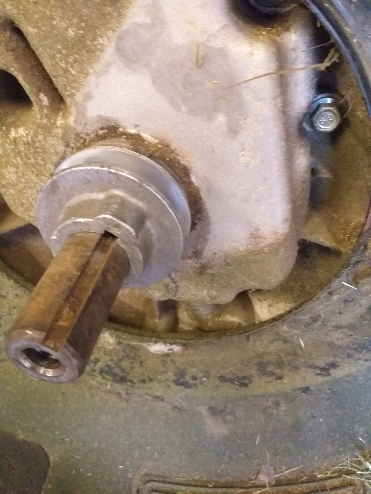

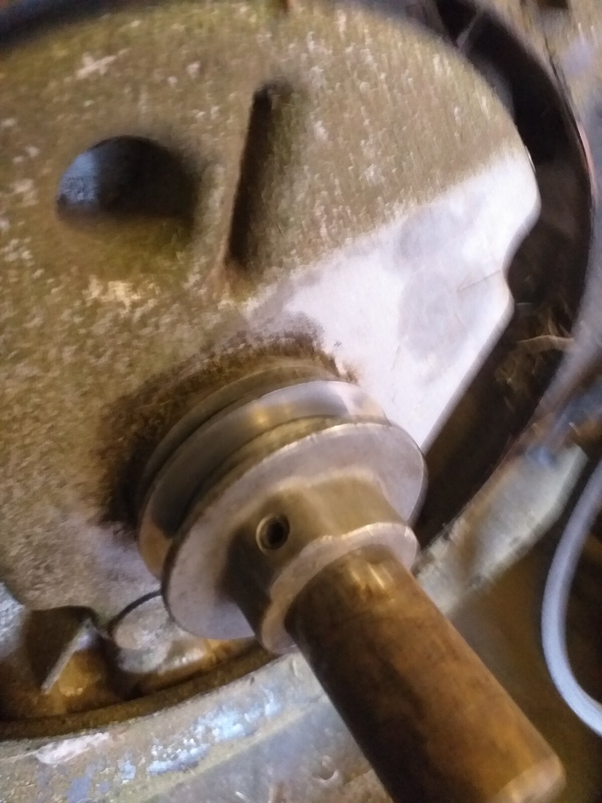

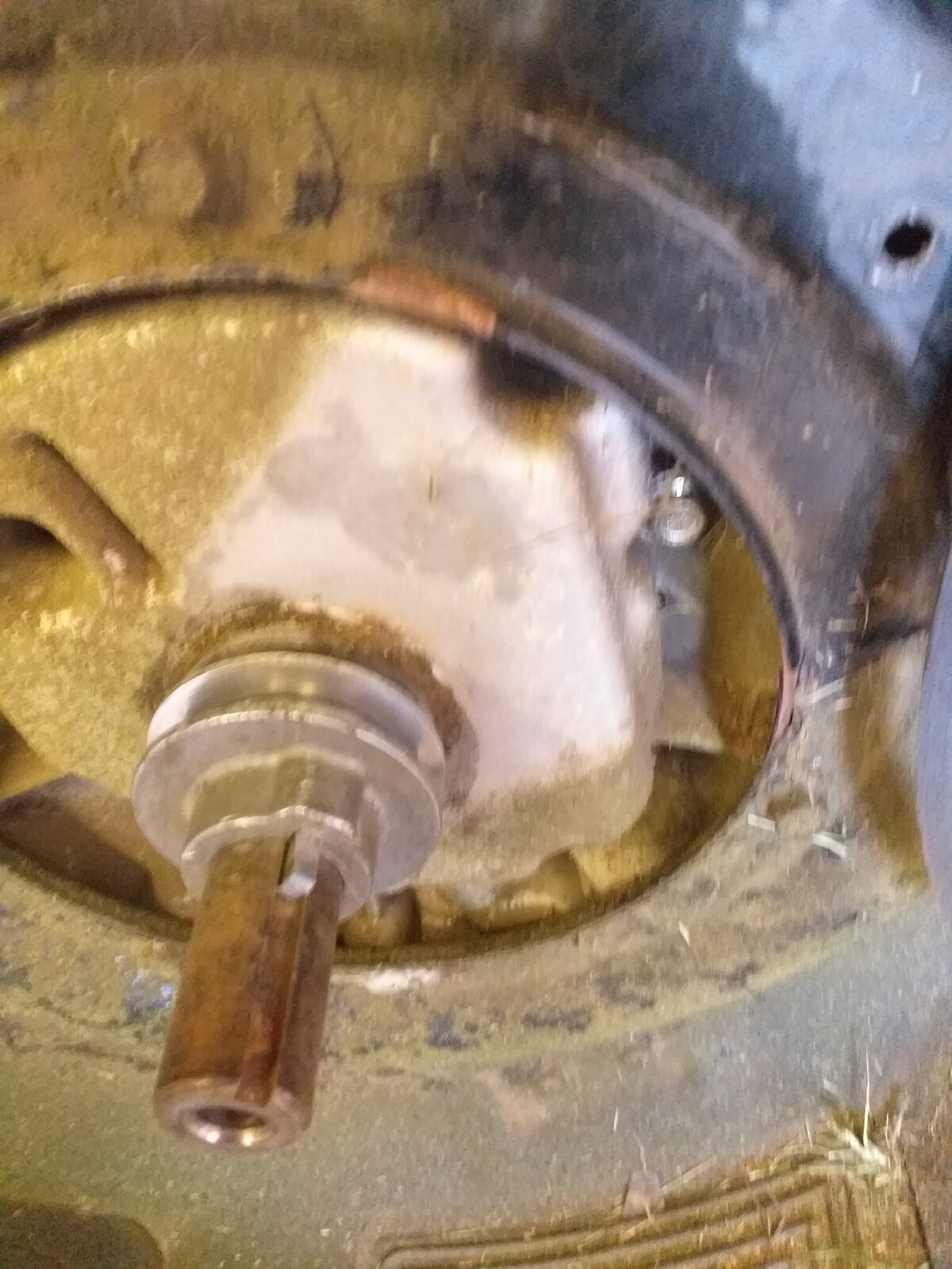

I had another look at the problem, I ended up at the Drive shaft and the wheel drive pulley wheel which drives the belt which in turn drives the wheel gear box. After dismantling and detaching the wheel drive pulley, I noticed that the only thing securing the wheel drive pulley to the drive shaft was no more than a minute grub screw. Looking at the design there looks to be a requirement for a steel key required to secure the drive pulley to the drive shaft as there is a keyway in the drive shaft. This key way is used to locate the cutter blade shaft to the drive shaft. I could not find a key to insert in the Pulley boss to secure the drive to the wheel drive gear box. I of course may have lost the key to secure the wheel drive pulley to the engine drive shaft when dismantling the unit or there was never a key in there. Search as I could, I could not find any key, if it was ever there.
I hope this lot is making sense!!!!!!
So the question is, if there was supposed to be a Key to secure the wheel drive pulley to the drive shaft I need to get another one or some how make one. Have you any idea where I may get a key for this function. I Have used the minute grub screw to tie the pulley and drive shaft together. I reassembled every thing and the wheel drive function of the mower worked although I doubt it will be for long as the minute grub screw is the only thing securing the drive to the the belt which drive the wheel drive gearbox.

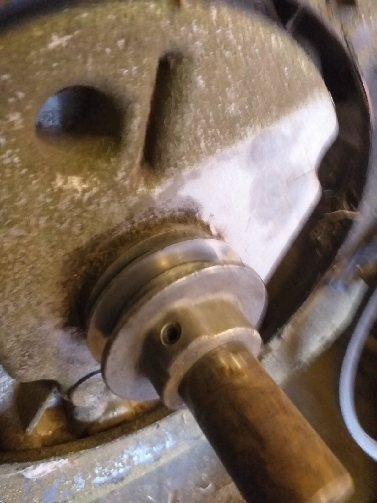

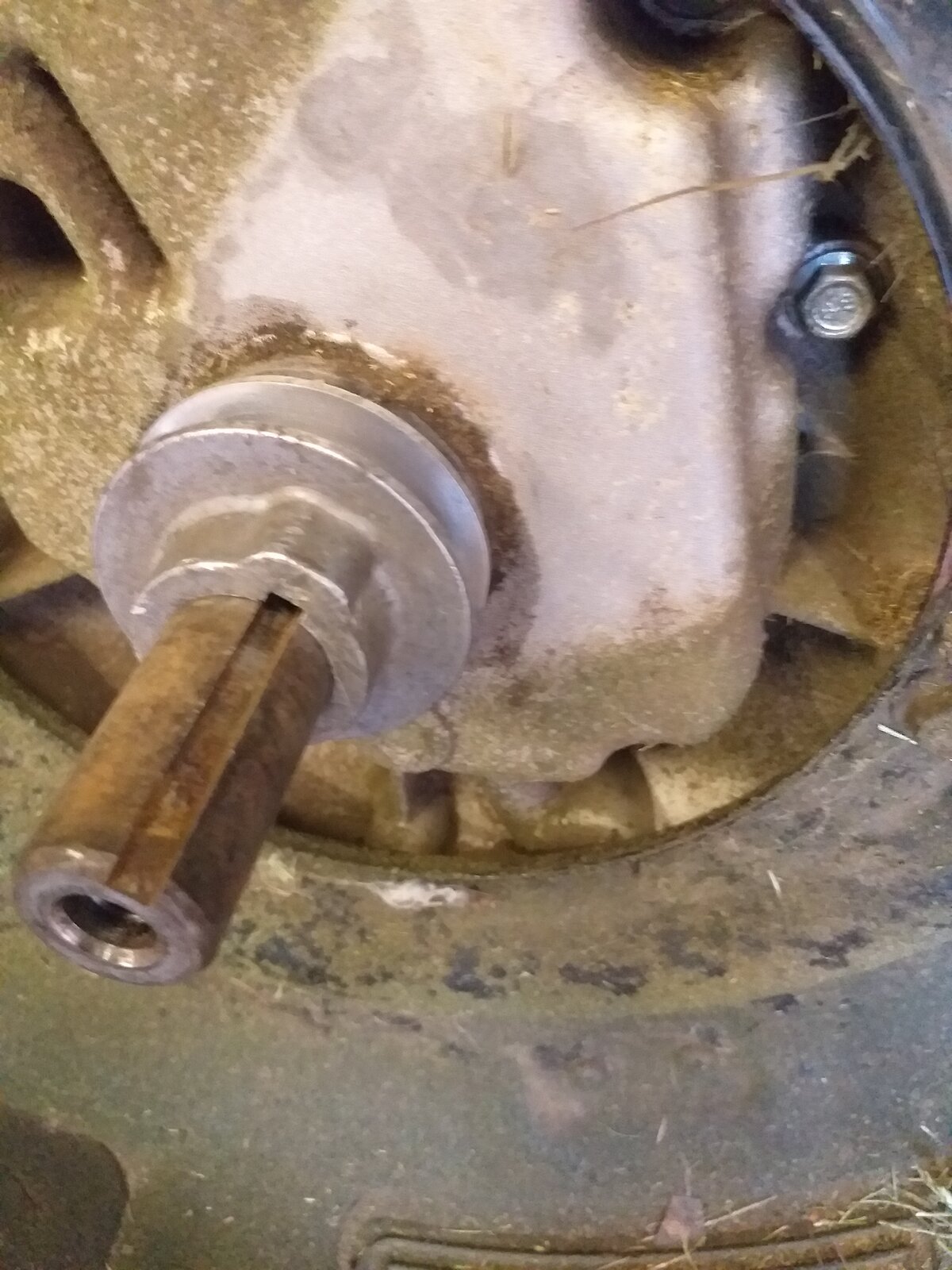

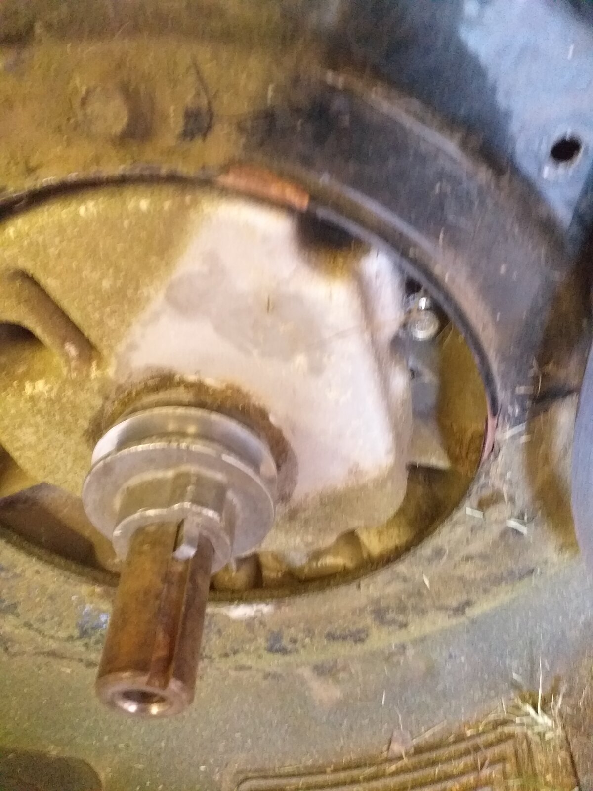

Hi John, Mower Fixed and running as new. The problem was that there appeared to be no square Key in the Wheel drive Boss and was relying on the Small Grub Screw to hold the boss to the drive shaft, or maybe the key had dropped out at some time. I attach the photographs for your information. Mower Boss 1 shows the boss in place on the mower blade Drive shaft without the Square key in Place, Mower Boss 2 shows the Home Made Stainless Steel Key in place. When the Mower Blade boss is put in place on the drive shaft, the Blade Boss fits closely up to the home made Key and as such should prevent the key coming out. When I get the opportunity I will try to find a supplier for a proper manufactured key, but I think that will be difficult to locate. Mower Boss 3 shows the Small Grub Screw to which I previously referred.
My mower is up and running now, it remains to be seen as to how long my 'Botched Key' survives.
I wouldn't bother - that SS key, is much tougher than the cast-alloy pulley it is driving. The pulley will collapse long before the key.
