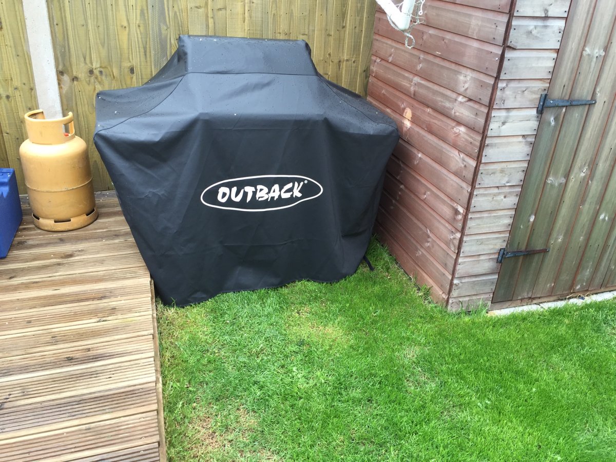

Morning All
I have a small area of 1300mmx1250mm in between my Decked area and my shed that I have decided I would like to have as a stoned area to place my BBQ on.(Photo attached of Area)
What is the best approach for laying it? Do I really need hardcore and whacker plates or can I get away with an alternative smaller hardcore and sand bed?
Any advice would be welcomed
Andy
If you dont want to go the full route of 75-100mm ofhardcore then 30-50mm of bedding then you could just lay them on 50mm of decent mortar.
What do you intend to lay? flags? block paving etc?
