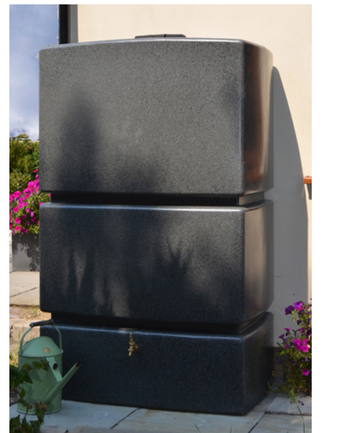

The water butt in question holds 1200 litres so it does amount to a decent bit of weight when full.
My plan is to lay a level concrete pad to sit it on and attach the top to the wall of the house using resin fixings to stop it moving.
So based on the above I need the pad to be strong, if that means I need to make the former and lay it in one go then that's what I'll have to do, I was just trying to save a bit of messing about with the former but it's not worth it if it's going to compromise the overall strength.
Yes spread, the sizes I put in first post will leave about 50mm all around it.

Looks like the one in the picture is happily sat on a couple of 2x2 flags.
