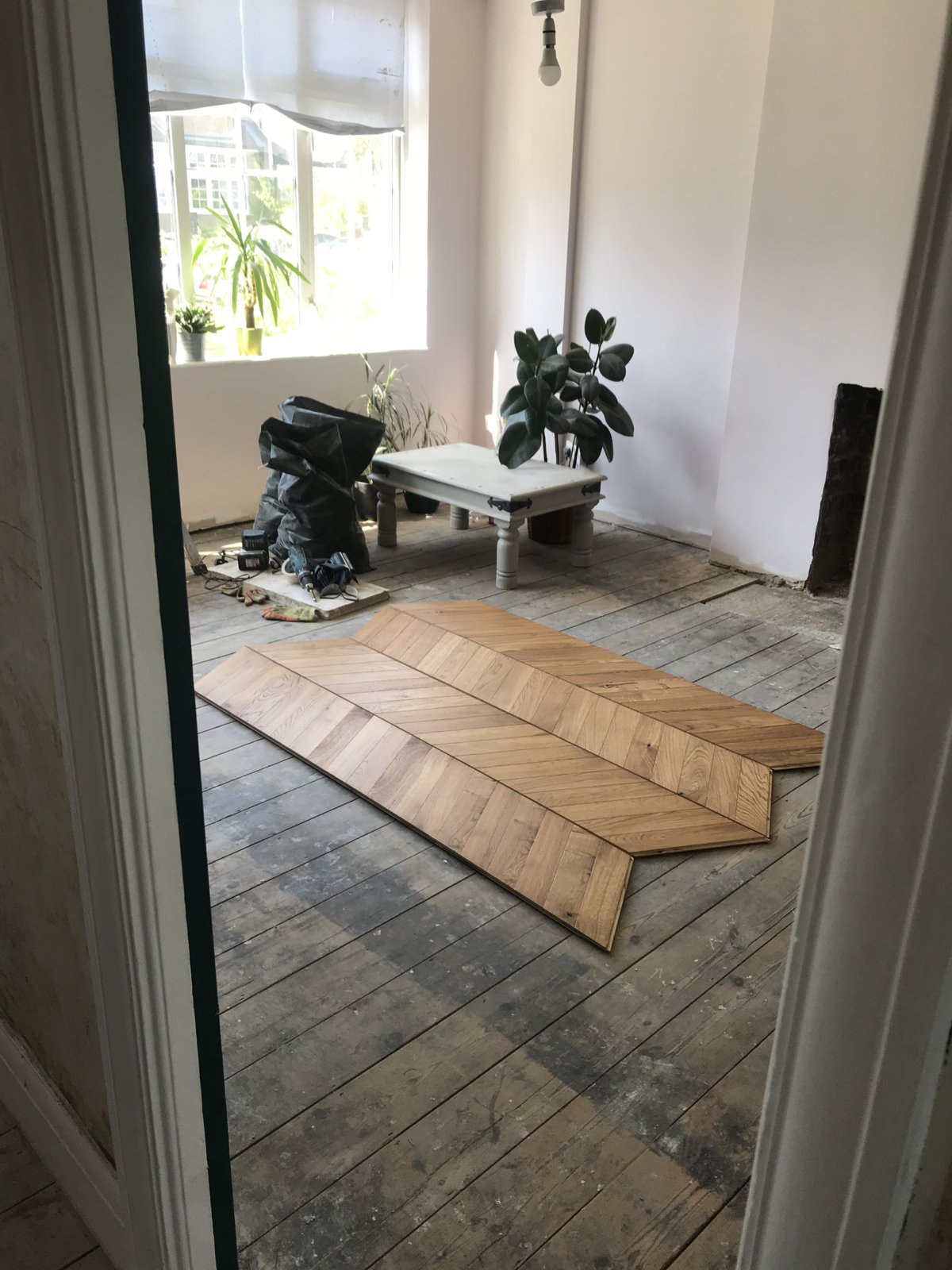

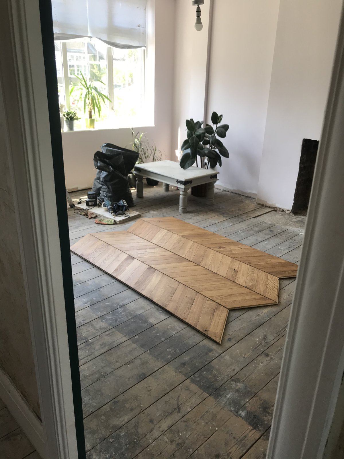

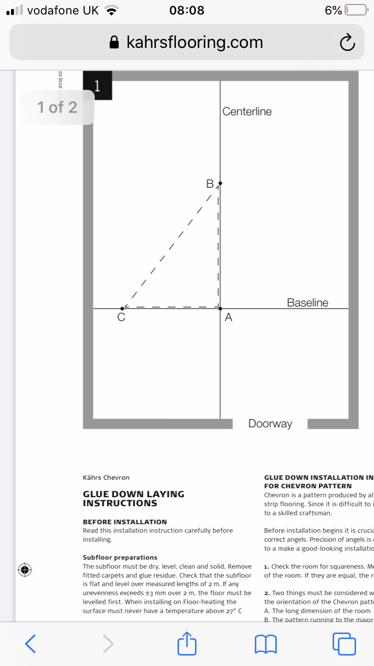

Hello everyone just a quick update. I’ve laid the plywood down and feathered all joints and slight ridges between boards to get everything as level as I can get it with stopgap500. I’m just wondering where to start the installation.
I’ve attached a picture of my room and the picture of the installation instructions. I was just going to start from the door and work my way left to right. However the instructions seem to say start from the middle and work one way than the other? The floor will be running as laid down in the picture with the chevrons running towards the window.
I know the obvious awnser is the follow the instructions but just a bit confusing as my room shape and door position are completely different to the picture In the instructions!
