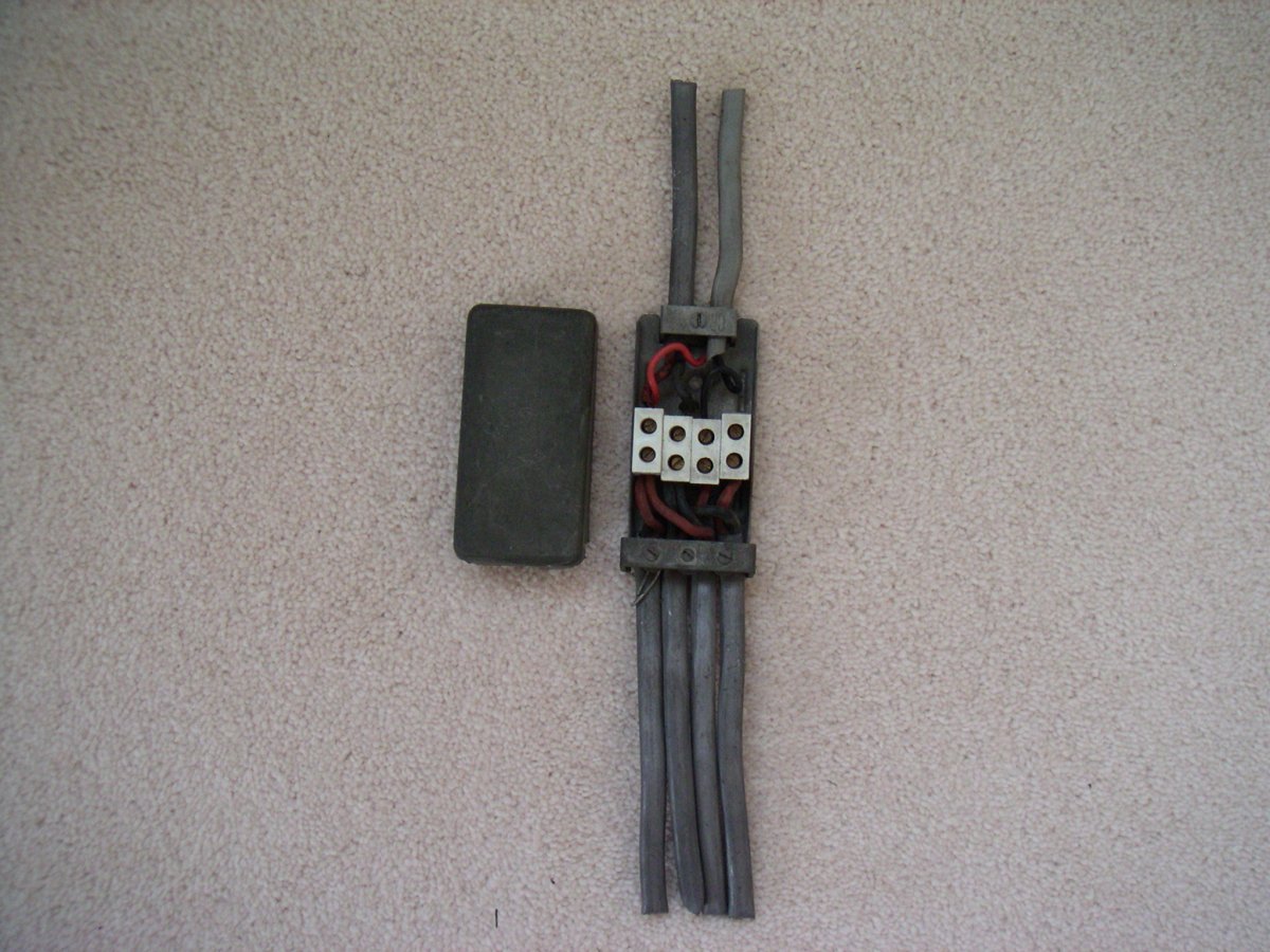

I just knew this pic would come in handy one day…
