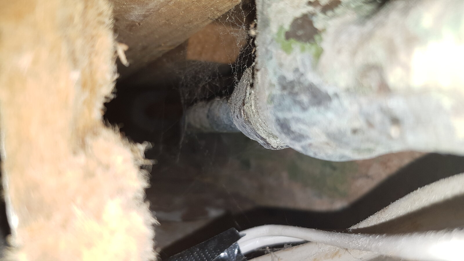

Hey guys,
Ive got a dilemma, the lead stop cock is leaking and I just want to replace it, but I thought I might aswell take the opportunity to replace the length of lead pipe. I can only replace the section from the front of the house as the drive is concrete printed and cant afford the work.
Is it worth replacing the length of lead under floorboards with 25mm mdpe? (I would like 32mm not sure if this is possible) The 25mm could be as long as 6m or 9m if I more the new stop cock into the kitchen. Would I notice a highier flow rate replacing that section of pipe? The water pressure here is horrendous lol.
Thanks for any help.

You need to take some measurements with a pressure guage and a weir gauge (or a calibrated bucket with stopwatch). Measure your static pressure and then measure the dynamic pressure with an open tap, whilst also measuring the flow rate.
If you are getting a massive pressure drop, then upgrading the pipe size will reduce that pressure drop. This can result in a higher flow rate than if you had undersized pipework. However, you'd always be limited by whatever your incoming flow rate at the boundary is - you can speak to your water company about measuring this at the boundary, to try and establish if the upgrade would be worth it.
This seems your only option for now. Use 32mm, it won't do any harm and will cost pennies more than 25mm.
Cheers for those detailed responses, I've got my plumber comming to look at it so hopfully we can do some tests, I'm just imagining push back with a 32mm mdpe pipe, I'm sure hes going to say I dont need one and recommend a 25mm, but bigger is better right :p haha.
Hey guys thought I'd report back, had the work done today, had 25mm fitted to the end of the lounge about 6 meters, was a nightmare thames water had to come out and replace the outside stop cock, but flow is alot better noticable improvement can now have tap and shower on also the old connector was a push fit in the road the workers said these are prone to fail and replaced them all I think there was a slight leak before maybe. Anyway that's all. :)
