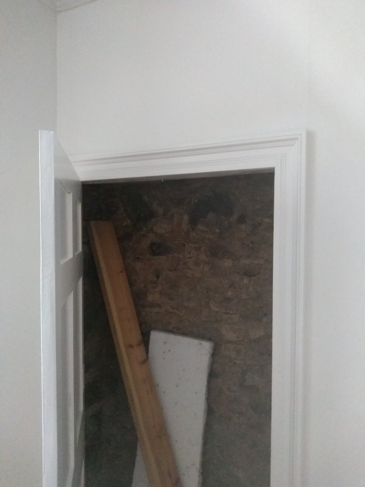

Hi,
Got a bit of a leak coming in at the gable end wall upstairs. There was dampness in an old Edinburgh Press (shallow cupboard set into stone wall) which I thought was condensation and I ripped the wooden lining out to find a leak coming in from above. No dampness or water ingress at all in the attic space above, and as the cupboard recessed into the wall, I presumed it was probably coming in at the skew stones and seeping down the inside of the wall until it hits the open space at that cupboard.

The pic is the cupboard which is in the corner of the room (the corner where the drainpipe is in the outside photo). Water seeping in through the stone above the wooden lintel for the recessed cupboard.
No pic of attic as its a nightmare to get into that point again, but it was dry as a bone above, which makes me think the water tricking down through the centre of the wall.

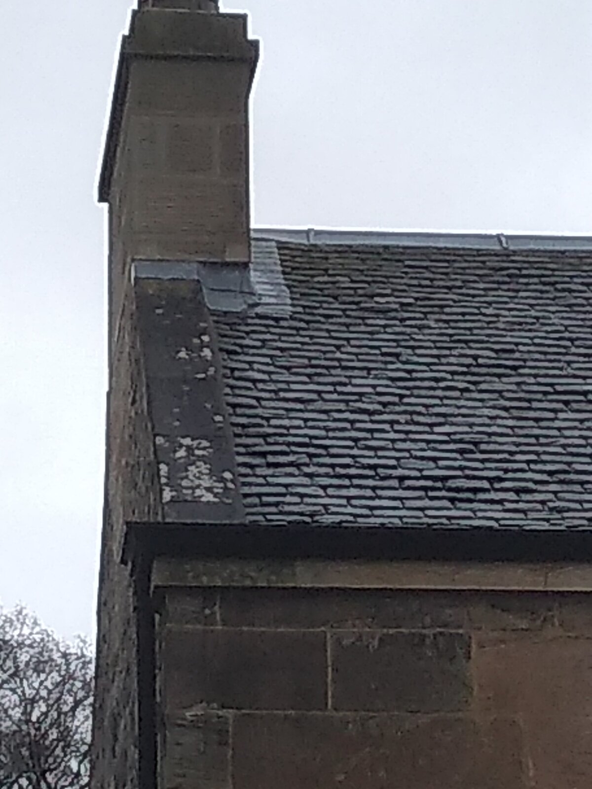

Outside pic of gable end of roof where I think it is entering.

it looks like the parapet gable needs re leading.
Id guess that needs a scaffold to be done
Thanks. I had to look up parapet gable, I think the roofers around here call them skews.
There is no lead on them at the moment, its cement between the slate and the stone. If I understood correctly I think the roofers that were out were proposing covering the entire skew/parapet with lead, and running it under the slate with a kink in the lead (under the slate) to prevent run back.
I am a little sceptical that the sandstone is porous enough for water to enter so quickly after rain, but maybe if they are already saturated, I don't know. I suppose the idea of running lead over everything means that it takes everything out of the equation from the stone to the seal between the stone and the slate.

Get the skew and joints between the stones re-done first, that can be done from a roof ladder unless it's a 3 storey.

The sarking runs up to the edge of the last rafter which runs up the side of the gable wall, the cope oversails the sarking and slates which is where the cement fillet/skew is formed.
Ok thanks, given that the wall is much wider than the cope, if the cope oversails the sarking even slightly, a section of the sarking will be sandwiched between the top of the wall and the slate and will not be visible from the attic. Although that may only be about 150-200mm, which is a good bit less than the roofer was quoting to replace.
My gut tells me that the water is coming through or under the cement skew, as the rain usually drives towards this junction from the south west. Water coming in at this point would enter the inner skin and run down the small rubble fill cavity, which seems to be roughly where it is entering the cupboard inside.
Water coming through a saturated cope would mostly come in to the outer skin of the wall, which you might think would be less likely to appear so high up on the inside skin of the wall, but its obviously hard to predict the course that water will take through a wall.
Its difficult though, if a tradesperson tells you what needs to be done and you suggest otherwise, it usually doesn't go down well and both so far have been quite insistent that most of the water will be coming through the sandstone cope.
I coated a sandstone cope with a couple of coats of thomsons Water seal a few years ago, the customer had the same problem as you, no problems since. That was after renewing the skew and re-pointing the joints.
