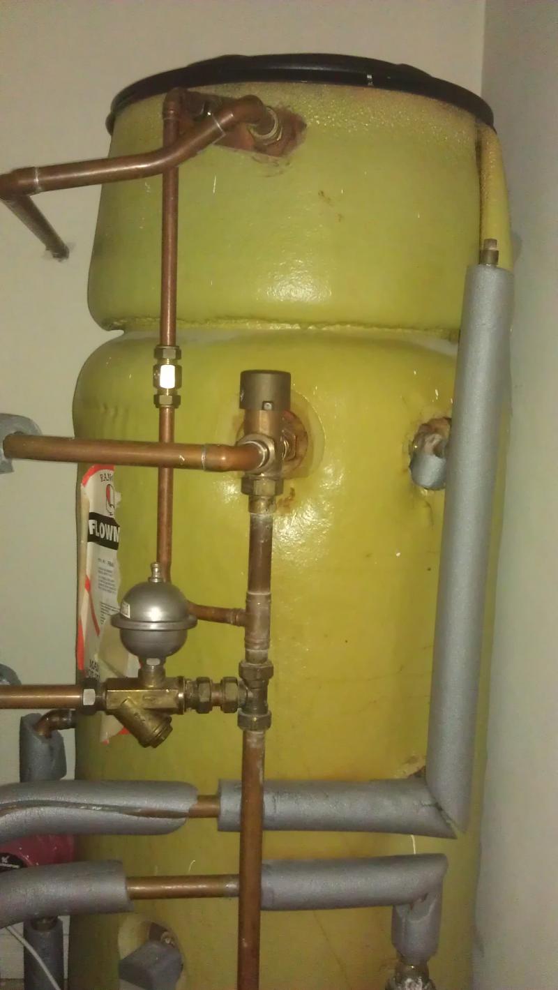

Morning all,

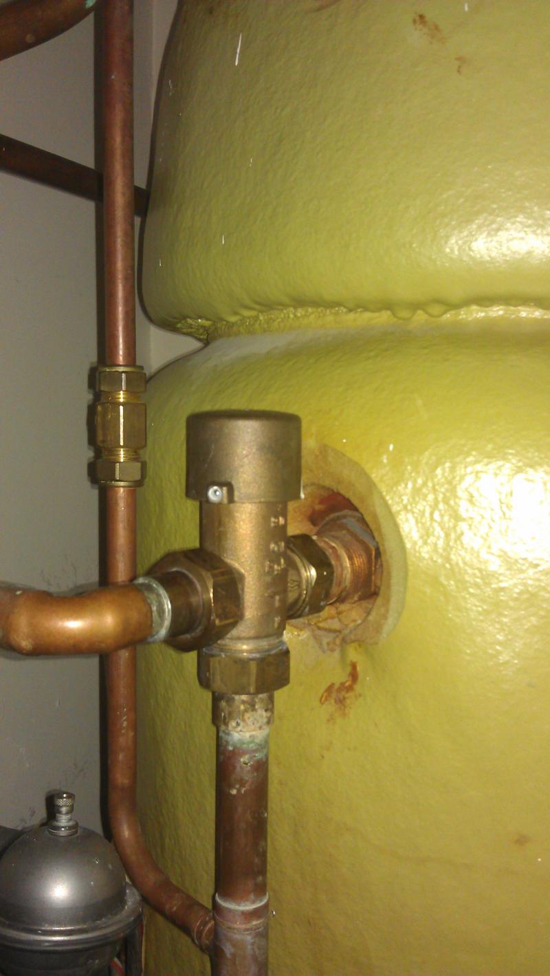

I have just returned from holidays to find a leak coming from our hot water tank in the airing cupboard. I had a plumber out yesterday and he replaced an O ring where the leak appeared to be coming from but yesterday evening the leak stared up again and I can see it's coming from the mixer valve (thermostatic valve?).
Sadly, I am sceptical about calling the guy from yesterday because he seemed to suggest that I might get a problem from the mixer valve and he told me you can't get this valve any more as it's obselete and would potentially need to replace the whole tank (at about £2000!). A coincidence that it's gone wrong now? Maybe I'm just synical but I'm also just being cautious.
The tank is a Range Flowmax and whilst the sticker showing information is ripped, I think the product reference number is either 4661 or 4651.
I wondered if anyone can give me some advice as to
A) What the problem may be and how I can resolve it?
B) If I need to replace the mixer valve, where is it best to obtain it from?
Any help would be very much appreciated.
Thanks.
If its the blending valve you are referring to then it can be replaced. Post a pic if you can. Contact Range for them to provide a part and fitting is simple if you follow the basics.
Hopefully this works .........
So this part should be readily available then? Is there anywhere you could recommend getting it from or is direct from Range the best bet?
I can only suggest you contact Range for a part number and then try to source from your local parts centre. I think they are made by Oventrop.
Not cheap though.
Is it leaking from under the brass cover?
Is it going to be a definite case of having to replace it or is there some kind of seal that could be the issue?
(I've contacted Range and can get the part for £102 delivered).
No I didn't ask. To be honest, for the cost involved, I would sooner replace the whole valve otherwise sods law says something else will go faulty on it in a months time.
Thanks for your help, it's very much appreciated.
