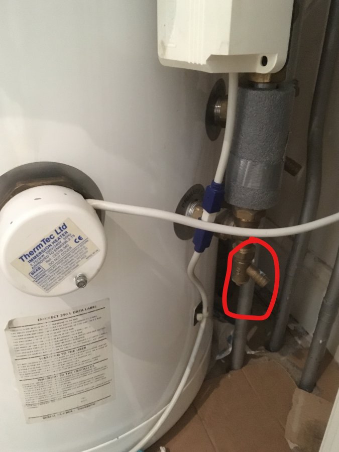

Engineer came and confirmed immersion heater, which is on order. Said he would need to drain system as TheRealPIn5 indicated earlier. Just so I can keep him honest, would he have to drain from the point ringed in the picture?
Poor guy, he's going to try & do the job with your chin on his shoulder!!
