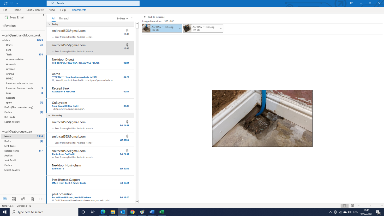

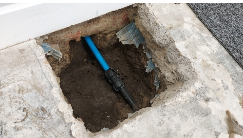

Leak from water pipe (picture included)
Thanks Madrab.
It looks highly likely its a damaged pipe under the floor. So I've got to take a stab and start breaking out somewhere, the listening stick won't help me pin point it though, will it?
Yes, I can turn it off in the street.
As the wet patch is so close to the external wall, start by digging outside. If you are lucky the leak will be in the garden. You will have to dig it up anyway if you are going to run a new pipe (best solution)

Once the water is turned off in the street, I will also have to ask them to isolate in some way upstairs I guess?
Once your off in the street any water in the internal pipe will flow out of the leak.
You might as well dig outside first, once you find the leak turn off at the outside stop tap, clean the paint of the 15mm copper above the tap, then make your repair.
The pipe looks like 3/4” black alkathene so get a 25mm Philmac fitting, length of 25mm MDPE and a new stop tap/drain off ready.
You mentioned the flat below you .......do they have any evidence of damp ?

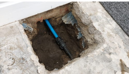

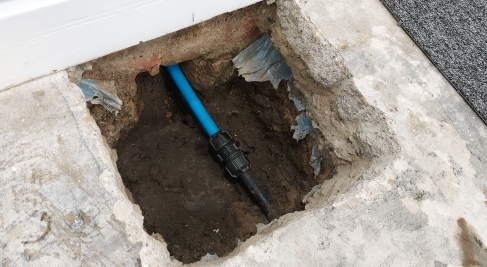

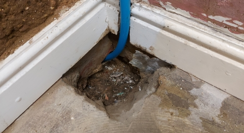

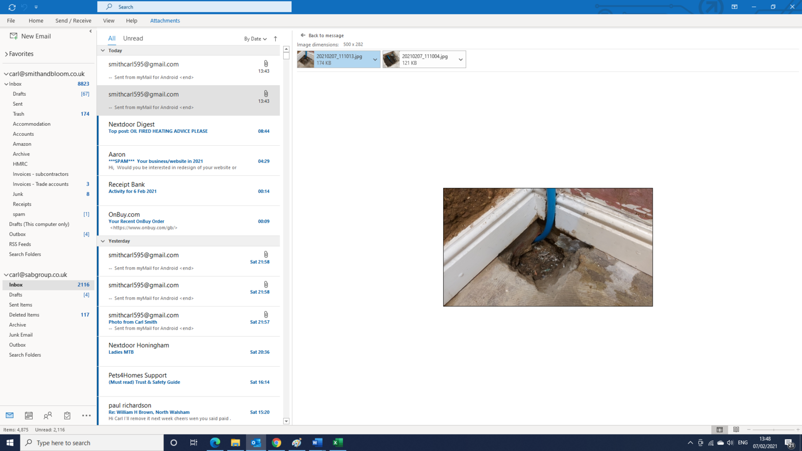

Found the leak quite easily. There was a tiny jet of water spraying out of the black pipe from underneath the wall.
A plumber mate cut out a piece of the black pipe and replaced with the blue.
