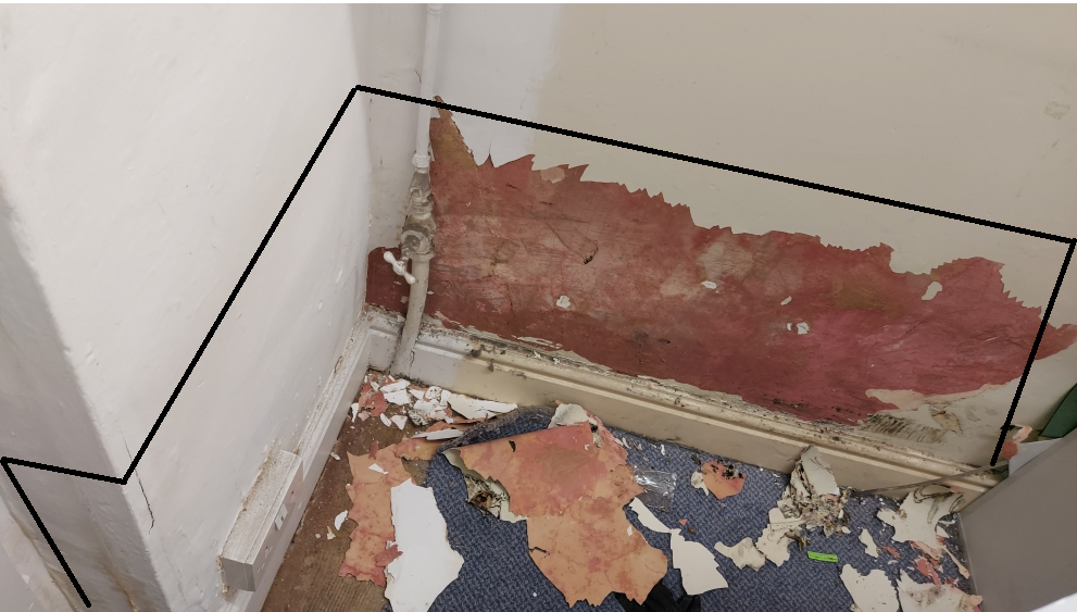

I'm guessing this pipe has a leak below ground and is the reason there is so much damp in this area.
What is the best way to approach this, I don't just dig up the concrete floor do I?
Thank you in advance for any assistance.
The wall on the left is a masonry brick wall (internal) and that door internal, no obvious damp course.
stand back and take a wider pic please, all the way up to the ceiling, and pull back the carpet so we can see the floor.
Also a pic of the outside, showing the wall, and any gutters, downpipes or plumbing.
What is in the room above?
Have you got a water meter?

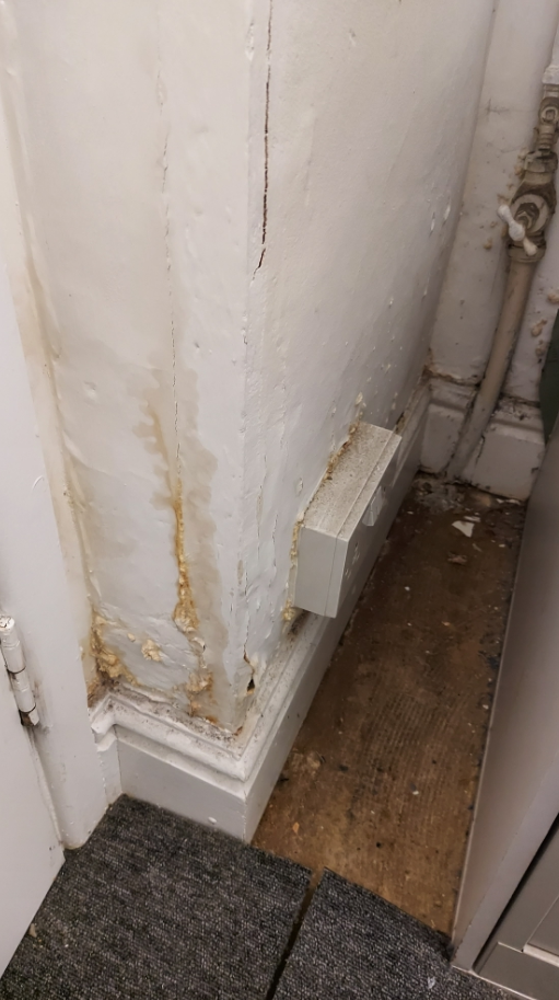

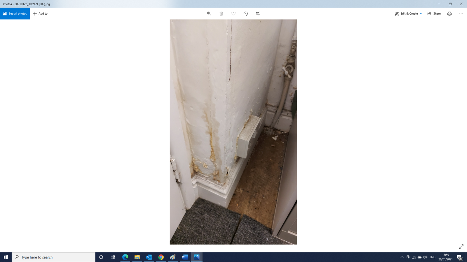

Below this black line is where the walls are very damp. The carpets and concrete floor are dry.
Both walls shown here are internal and there is no sign of damp on the other side of these walls and there is no sign of water ingress from above.
So the leak must be below the floor and is being sucked up the walls, as the water pipe is so close it would surely suggest the pipe is leaking under the floor.
Unless anyone can suggest anything else?
What should I do now, dig up the floor, or is there a less intrusive way of detecting a leak below ground?
Thank you.

If you have an external water meter,turn your internal stopcock off, and see if the meter continues to turn / register useage.
If you don't ,remove the left hand skirting board and see if it reveals anything.
Post pictures of your progress.
Be careful not to go through the pipe or an electric cable. If possible turn off the exterior stopcock.
