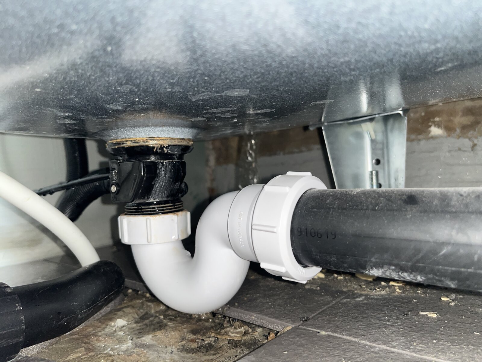

Have a leak coming from the black part under the bath. Drips down onto the floor. Is that the overflow and is it universal? Can’t seem to find anything similar And is it quite easy to fix haven’t changed one before
You should also shorten the overflow pipe when you replace the seal. The way it is at the moment means you have a pool of water sitting in the overflow pipe.
