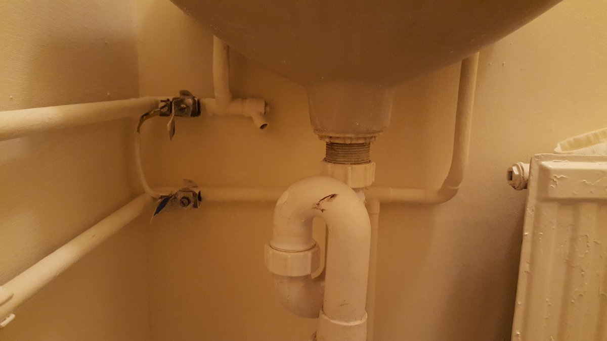

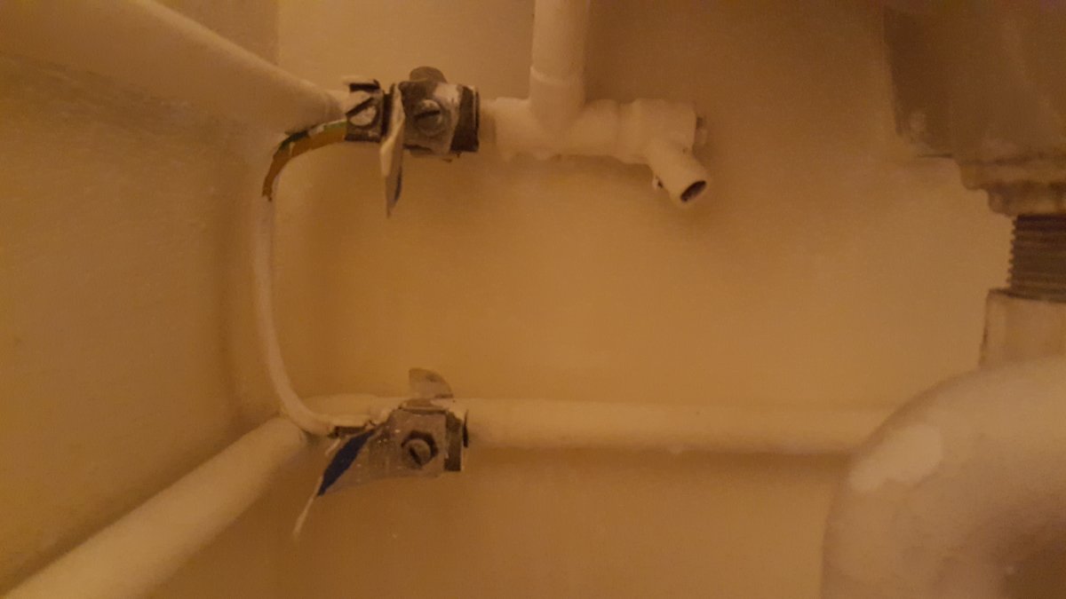

Hi all,
Bit of a DIY newbie here. I've got a leaking hot tap in my downstairs toilet. My partners dad was able to take a look yesterday and said that the rubber washer had gone and to get a sealant kit to fix it, I'm going to try and give this a go over the next few days when I have chance. In the meantime I was wondering if there was any way to temporarily stop the leak. Looking online I can see mention of isolation valves, I don't think that we have these on our pipes but I am not 100% sure. Would really appreciate it if anyone has any advice at all. I've attached some pictures of the pipe work underneath the sink.
Both pipes coming in from the left come together up along the wall through the ceiling. The pipe at the top goes to the hot tap and the pipe at the bottom goes to a T shaped pipe where it splits and goes to the cold tap and down along the wall into the toilet cistern.
Thanks,
Ell

No sign of any isolator a I'm afraid, but they sure would be useful!
A plumber would probably freeze the pipe before cutting and installing, otherwise the hot water would need to be drained down - which isn't as drastic as it sounds.
Do you have a combi boiler by any chance?
Any paint needs to be removed before any isolator is fitted.
John :)

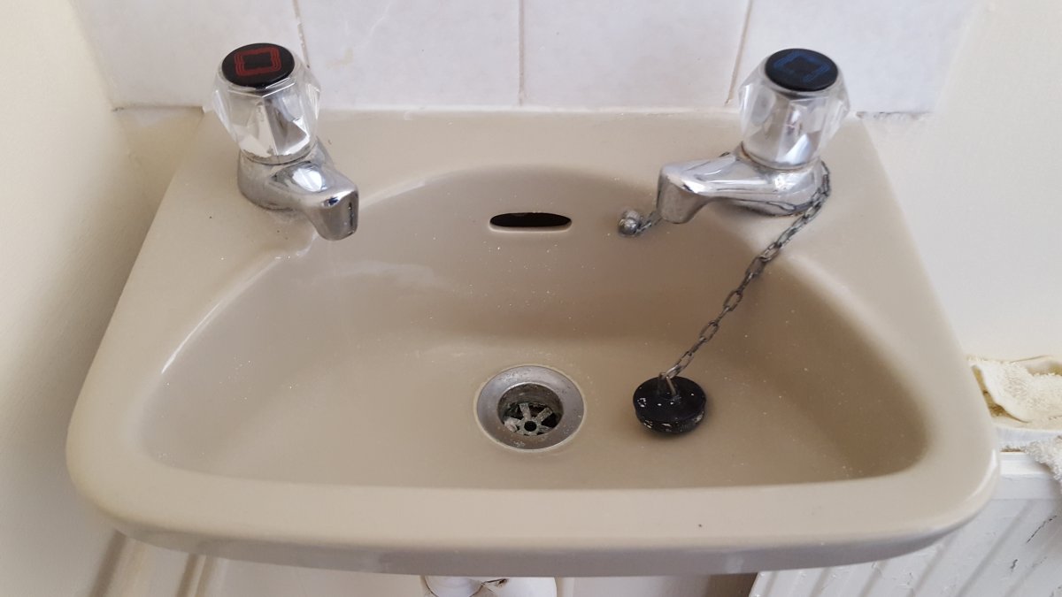

Hey Madrab, Thanks for the advice. So at the moment it is just leaking out of the tap. I've attached a pic of the sink itself, the taps do turn fully so I assume it's just the rubber washer. This is what my partners dad said has perished I believe, I may have misheard him when he said sealing kit, maybe it was seal kit? Would I just be able to buy a generic pack of rubber washers from a DIY shop? Just wondering what I'd need to get. Hope it's easy enough to replace!
Thanks,
Ell

Suitable rubber washers are available from B&Q, or you could even fit a 'tap reviver' if you want......this is essentially a new head that fits into the old tap body.
Either way......your job (should you choose to accept it :D) is to prevent the tap body from turning whilst you undo the tap insert - which is just below the plastic top.
Your washers will be 1/2" size, likely enough.
John :)
have a go at getting things stripped down first. Pop the top of the tap off (indice), screw underneath, remove that, pull the head off. Under that your find the valve, pair of grips, jaws in a wet face cloth, grab the body tight, loosen valve with an adjustable spanner. You may have to pull hard. Once the valves are out then see what washers are on the bottom of them. Likely 1/2" as @Burnerman has mentioned.
Thanks for all your help guys. Managed to replace the washer today, had a bit of a faff trying to get the right one had to go to plumbing station to get the right washer. Replacing it wasn't too bad though :) no more leak! Thanks again all, Ell
