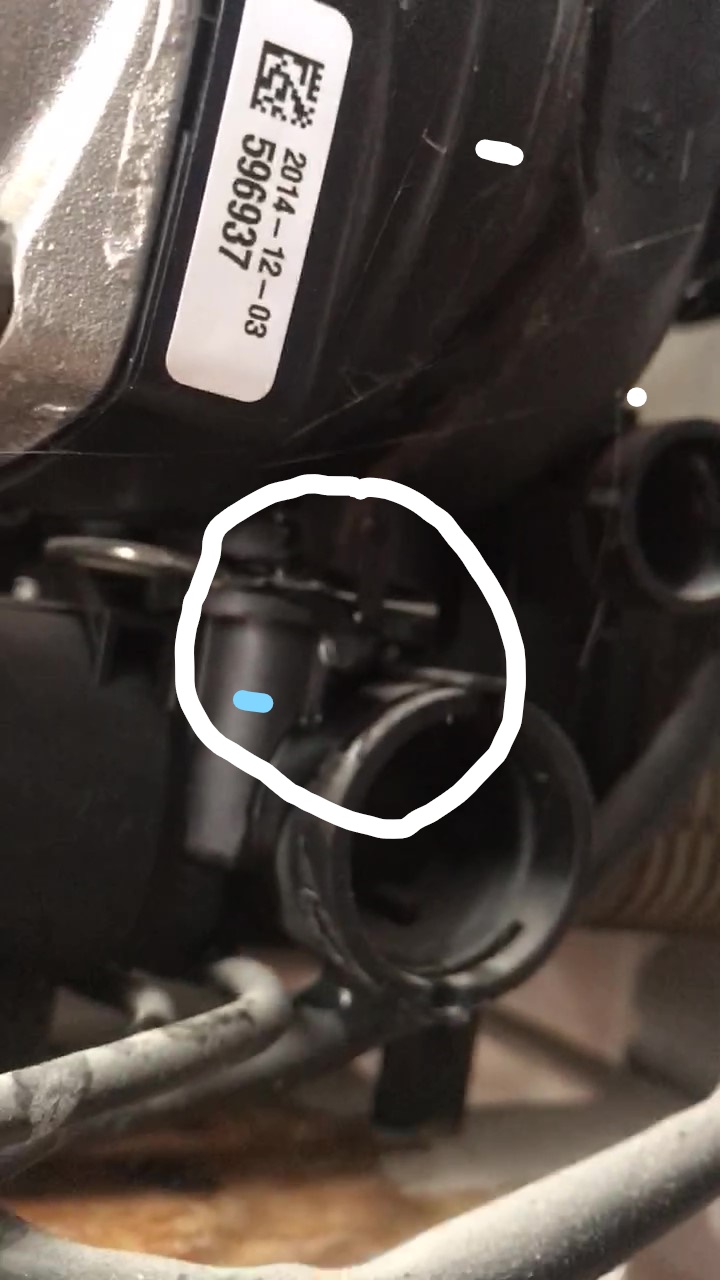

Can anyone help please
Have vokera combi boiler
Please see attached photo
Pump is leaking by a clip
Just wondered can pumps be changed on combi boiler ( by a professional) or is it usually complete boiler change .
Have changed pumps on older systems with header tank as pump was separate and had isolating valves each side.
Thanks for any advice

you can change the pump , but would be unusuall for it to be leaking from there, are you sure it is not leaking at the auto air vent and running down, the hydro blocks can leak at the seams and can pinhole, might just be an O ring changed many pump heads on these but never the whole pump
That might be a water stain running down the side of the pump from the AAV, not clear in the photo.
If you order a Vokera pump you get the rear housing with it but not the AAV which locates above it.
Have a closer kook at the area behind the top of the pump for staining. Very common if a dirty system.
Not expensive if AAV or you could try to turn the cap off. Pump assembly about £80-£100 I think.
thanks for response and details it is actually a leak i do have a video of it leaking and it can be see as it drips out.....however couldnt upload it due to the data size of the video..... on that photo the drip is just forming ready to drop ...

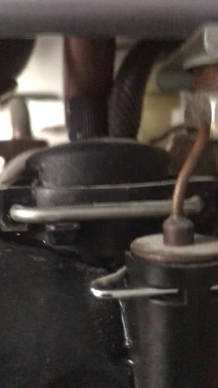

thanks ianmcd for the video suggestion .... so in trying to get a better video i think i have discovered the leak from an existing valve.. if anyone could advise on what bit it is ( possibly already mentioned in previous posts ) .... never used youtube this way so hopefully the link will work
it starts leaking not long after heating coming on...not as if the system has been on a long time then starts

From the small phone screen it looks as though the AAV I'd letting by as Ian suggested. Close the cap, get it replaced, simple job.
great thanks ianmcd looks straight forward but if you look on the video there looks like a copper rod or thermocouple right in the position where the clip pulls out !! so would be in the way ...can i just disconnect that using what looks like another clip holding that in ?....
Also i take it boilers can be isolated so dont need to drain entire system ?

That is the Pipe for the pressure guage, yes just pulls out be gentle, as easily snapped , and a tiny bit of silicon grease on the O ring when popping back in, dont use the boiler isolation valves or they will leak, just drain the boiler using the drain off point, best drain off on any boiler in my humble opinion , you will need rags or towels as there will be a little bit of water left but nothing serious , make sure you have properly isolated the cold water inlet and leave a tap open, you have both waters there

No just take the pressure out the boiler, the rads will hold on gravity, leave the hose on the drain down point as you work and it will be fine
many thanks ........ closed bleed nipple on AAV and leak stopped so your initial thoughts were totally correct
